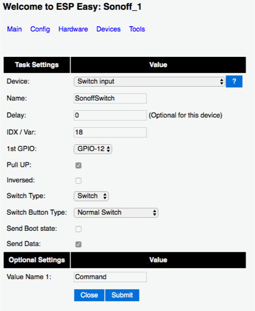

But if I set up the ESPeasy as follows:
and the item as:
Switch Sonoff1 {mqtt=">[mymosquitto:/Sonoff_1/SonoffSwitch/Command:command:ON:1],>[mymosquitto:/Sonoff_1/SonoffSwitch/Command:command:OFF:0]”}
Then I can't turn the Sonoff On or Off. (using "SonoffSwitch/Command" instead of "gpio/12")

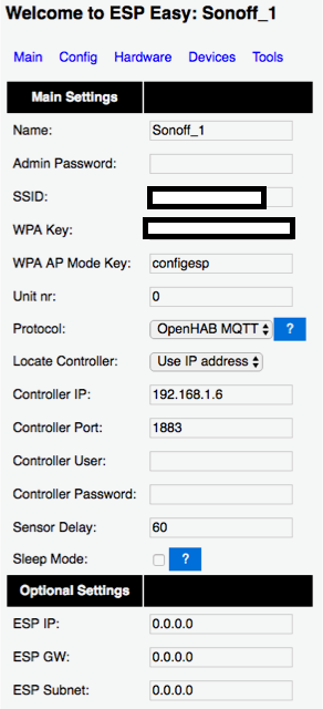

FYI, here the main page setup as info:
Cheers,

Take a look at the command reference:
GPIO (pinnumber),(value) is a command,
(devicename) (valuename),(value) is not - it is a sensor which sends its value back to the broker.
If you want to use something less cryptic in Openhab then wrap the gpio command in a rule and call that via mttq. ;)

Like I said I'm a Newbie and have to digest this for a moment, but basically you say that I'm using an "Input/read reference setup" for an "Output (On/Off or value) reference setup" and that's why this doesn't work.
(Not sure if I just made it clearer or 'clear as mud' with that statement :-) )
So I AM doing this wrong :(
Ah well... one learns something new every day.
Thanks paxi
