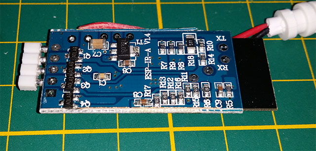

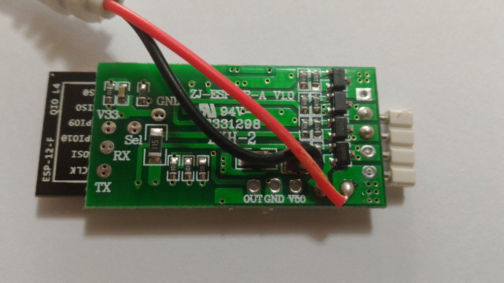

Re: H801 : RGB controller based on ESP8266 avalaible from China
you can also get this one
http://www.banggood.com/ARILUX-AL-LC01- ... 58603.html
officlaly its only rgb but the white channel is also present on the board
so no problem to mod it with espeasy
have one on order so ill post the results
pretty sure this one is also a esp8266
https://www.aliexpress.com/item/Free-sh ... 4a5d&tpp=1

ok small update
I have below dimmer now running successfully
its running esp easy 145 via the standard build in pwm commands.
so domoticz can talk directly to esp easy without any additional plugins
works fine for both rgb and single led channels
http://www.banggood.com/ARILUX-AL-LC01- ... ds=myorder
its really tiny and has 4 channels you can control and its cheap
there are only 3 channels soldered to the header but you can just add one extra pin
the mosfer for the 4th channel is already on the board
rx and tx are solder pads on the board and there are pads for an ir receiver on the board.
but these can of course also be used for a temp sensor or ir transmitter

@ Ledfreak3d... Great job!!
Did order 1 of these to..
so hope i get it fast..
Please can give a small how to...
do i need to flash the esp on it?
How? [ see no pins or something.. ]
Or just directly from my Wifi to the controller?
And rgb incl a extra pin... can a controll a rgbw?
How is it show in Domoticz? rgb bulb? or how do i set the colors?

yep you have to flash it with espeasy no extra plugin needed
there are 4 pads on the board rx tx ground and 3.3 volt for the esp
the pad near R14 IS the + 3.3 volt
the pad next to R11 IS ground
the only pad that is not on he board is gpio0 you will have to short that one to ground to be able to flash it.
you can see one pin it mixing next to the rgb output just solder an extra pin on and you have a extra white channel you can control
esp easy has build in pwm dimming
so I use the following script in domoticz for that
for every light in the script you will have to make a hardware a hardware dummy device with the same name.
Manually create a device and set it to selector switch and afterward's change it back to a dimmer device
this will give you the best dimming control over your light
make sure you setup the ip addresses to match the script and make sure you set the pins correctly
example ['Aqua Dimmer R/W'] = {ip = '192.168.1.98', pin = '14', rgb = false}, is a dimmer called Aqua Dimmer R/W' with ip addres 192.168.1.98 ad the physical light is connected to pin 14
if you set rgb to true you can choose a rgb device instead of dimmer and you can mix the color but you will also have to select 3 output pins in the script

thanks, for the fast repay..
Only i do not understand the gpi0 part.
Perhaps when i got the controller.
Hope you will help me when i got it @ home..
