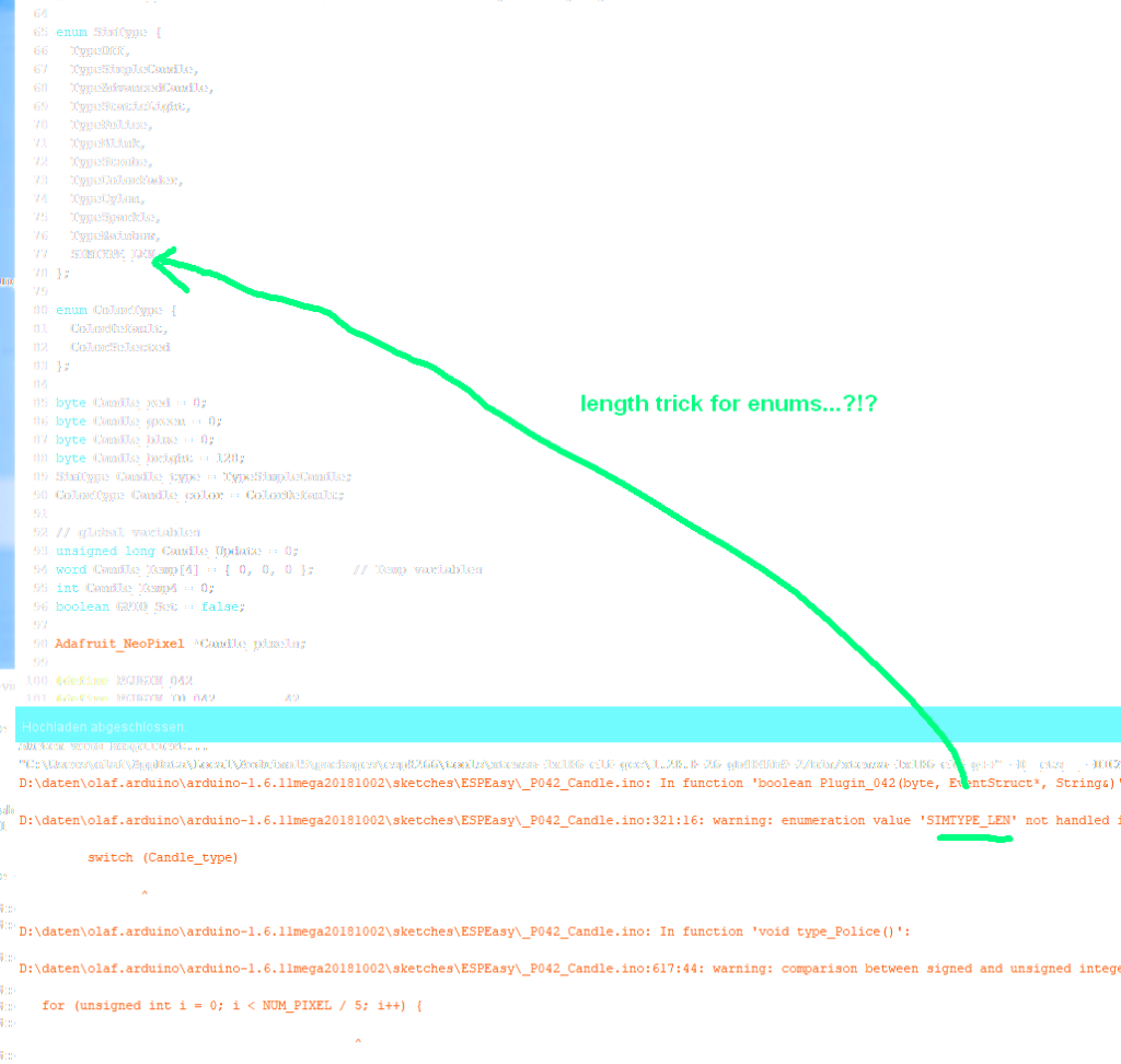

          Candle_pixels = new Adafruit_NeoPixel(NUM_PIXEL, Settings.TaskDevicePin1[event->TaskIndex], NEO_GRB + NEO_KHZ800);
          SetPixelsBlack();
          Candle_pixels->setBrightness(Candle_bright);
          Candle_pixels->begin();
          String log = F("CAND : Init WS2812 Pin : ");
          log += Settings.TaskDevicePin1[event->TaskIndex];
          addLog(LOG_LEVEL_DEBUG, log);
        success = true;
    case PLUGIN_ONCE_A_SECOND:
        Candle_pixels->show(); // This sends the updated pixel color to the hardware.
        success = true;
    case PLUGIN_FIFTY_PER_SECOND:
        switch (Candle_type)
          case 0:   // "Update" for OFF
              type_Off();
          case 1:   // Update for LIGHT
              type_Static_Light();
          case 2: // Random Updates for Simple Candle, Advanced Candle, Fire Simulation
          case 3:
              if (timeOutReached(Candle_Update)) {
                if (Candle_type == 2) {
                  type_Simple_Candle();
                if (Candle_type == 3) {
                  type_Advanced_Candle();
                Candle_Update = millis() + random(25, 150);
          case 4:   // Update for Police
                type_Police();
                Candle_Update = millis() + 150;
          case 5:   // Update for Blink
                type_BlinkStrobe();
                Candle_Update = millis() + 100;
          case 6:   // Update for Strobe
              type_BlinkStrobe();
          case 7:   // Update for ColorFader
                type_ColorFader();
                Candle_Update = millis() + 2000;
            //effects addition
          case 8:   // Update for Cylon
                type_Cylon(5);
                Candle_Update = millis() + NUM_PIXEL/20;
            case 9:   // Update for type_Sparkle
              type_Sparkle();
            case 10:   // Update for type_rainbow
                type_Rainbow();
                Candle_Update = millis() + 20;
        success = true;
    case PLUGIN_READ:
        UserVar[event->BaseVarIndex] = Candle_red * 65536 + Candle_green * 256 + Candle_blue;
        UserVar[event->BaseVarIndex + 1] = Candle_bright;
        UserVar[event->BaseVarIndex + 2] = Candle_type;
        success = true;
    case PLUGIN_WRITE:
        String tmpString  = string;
        // Test
        // MQTT   : mosquitto_pub -d -t sensors/espeasy/ESP_Candle/cmd  -m "CANDLE_OFF"
        // HTTP   : http://192.168.30.183/tools?cmd=CANDLE%3A5%3AFF0000%3A200
        //          http://192.168.30.183/tools?cmd=CANDLE:4:FF0000:200
        // SERIAL : CANDLE:4:FF0000:200<CR><LF>
        // Commands
        // CANDLE:<FlameType>:<Color>:<Brightness>
        //    <FlameType>  : 1 Static Light, 2 Simple Candle, 3 Advanced Candle, 4 Police, 5 Blink, 6 Strobe, 7 Color Fader , ...
        //    <Color>      : n.def.  Use the default color
        //                   RRGGBB  Use color in RRGGBB style (red, green blue) as HEX
        //    <Brightness> : 0-255
        // Samples:   CANDLE:2::100           Simple Candle with Default color and Brigthness at 100
        //            CANDLE:5:FF0000:200     Blink with RED Color and Brigthness at 200
        //            CANDLE:0::              Candle OFF
        //            CANDLE:1::255           Candle ON - White and full brigthness
        if (tmpString.startsWith("CANDLE:")){
          int idx1 = tmpString.indexOf(':');
          int idx2 = tmpString.indexOf(':', idx1+1);
          int idx3 = tmpString.indexOf(':', idx2+1);
          int idx4 = tmpString.indexOf(':', idx3+1);
          String val_Type = tmpString.substring(idx1+1, idx2);
          String val_Color = tmpString.substring(idx2+1, idx3);
          String val_Bright = tmpString.substring(idx3+1, idx4);
          if (val_Type != "") {
             if (val_Type.toInt() > -1 && val_Type.toInt() < SIMTYPE_LEN) {
                Settings.TaskDevicePluginConfig[event->TaskIndex][4] = val_Type.toInt();     // Type
                Candle_type = (SimType)Settings.TaskDevicePluginConfig[event->TaskIndex][4];
                String log = F("CAND : CMD - Type : ");
                log += val_Type;
          if (val_Bright != "") {
             if (val_Bright.toInt() > -1 && val_Bright.toInt() < 256) {
                Settings.TaskDevicePluginConfig[event->TaskIndex][3] = val_Bright.toInt();     // Brightness
                Candle_bright = Settings.TaskDevicePluginConfig[event->TaskIndex][3];
                String log = F("CAND : CMD - Bright : ");
                log += val_Bright;
          if (val_Color != "") {
            long number = strtol( &val_Color[0], NULL, 16);
            // Split RGB to r, g, b values
            byte r = number >> 16;
            byte g = number >> 8 & 0xFF;
            byte b = number & 0xFF;
            Settings.TaskDevicePluginConfig[event->TaskIndex][0] = r;   // R
            Settings.TaskDevicePluginConfig[event->TaskIndex][1] = g;   // G
            Settings.TaskDevicePluginConfig[event->TaskIndex][2] = b;   // B
            Candle_red = Settings.TaskDevicePluginConfig[event->TaskIndex][0];
            Candle_green = Settings.TaskDevicePluginConfig[event->TaskIndex][1];
            Candle_blue = Settings.TaskDevicePluginConfig[event->TaskIndex][2];
            Settings.TaskDevicePluginConfig[event->TaskIndex][5] = 1;
            Candle_color = (ColorType)Settings.TaskDevicePluginConfig[event->TaskIndex][5];   // ColorType (ColorSelected)
            String log = F("CAND : CMD - R ");
            log += r;
            log += F(" G ");
            log += g;
            log += F(" B ");
            log += b;
          } else {
            Settings.TaskDevicePluginConfig[event->TaskIndex][5] = 0;
            Candle_color = (ColorType)Settings.TaskDevicePluginConfig[event->TaskIndex][5];   // ColorType (ColorDefault)
            addLog(LOG_LEVEL_DEBUG, F("CAND : CMD - Color : DEFAULT"));
          //SaveTaskSettings(event->TaskIndex);
          //SaveSettings();
          success = true;
  return success;

#90 Post by tozett » 10 Oct 2018, 17:18
i used my brain, exhanged the old string += "" method with addhtml(),
and it works now.
the waring about symtype_len seems to me ignorable,
i googled it and it seem to be a coder-trick to get the length of the enum.
as far as it is working at the moment, i am happy. :D

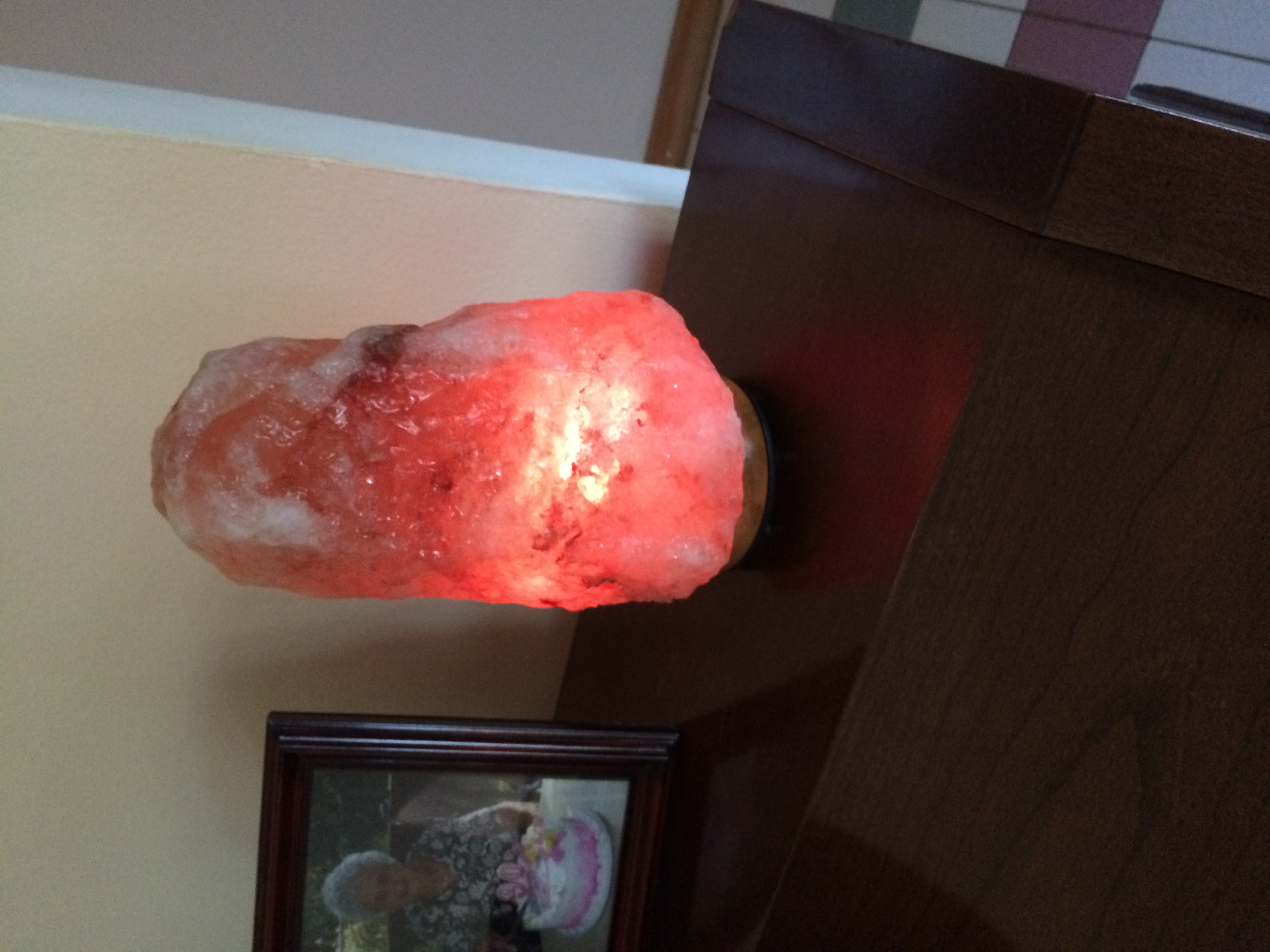

anthony420
Posts: 4
Joined: 14 Oct 2017, 03:08
Re: Wifi Candle - illuminate with ESPEasy (WS2812)
#92 Post by anthony420 » 10 Oct 2018, 23:30
tozett wrote: 10 Oct 2018, 07:29 maybe an illustrating picture of your candles?
:D
I'm not so good at adding attachments, so hoping for the best. I have a video but can't seem to attach the .mov file type.
