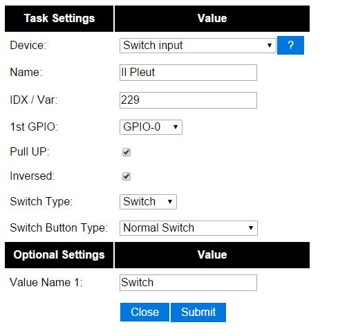

I just finish a rain sensor with ESPEasy, with the same kind of rain sensor we can find on ebay.
It's run R30 on a SP1 and update Domoticz via http
Set it as a reversed switch with pull up.
