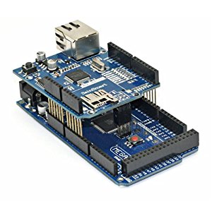

Yes, an old DIY gadget like this:
Because i do hate to throw away old stuff that gave lot's of fun in the past, i tried to port ESP Easy to the Arduino Mega 2560. Just a small challenge to see where it would end.

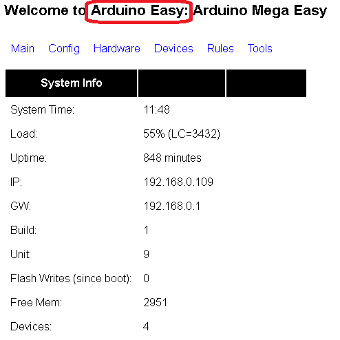

So here we have it:
Much more limited compared with ESP Easy, but a functional Easy Arduino with a Domoticz controller and happy communicating with other ESP Easy neighbors...

In the mean time, two Arduino 2560's have been running for a week doing 100.000+ pulsecount reports to Domoticz, so it looks like a feasible project.
Although current version has only 4 plugins (switch/analog/pulse/dummy)...

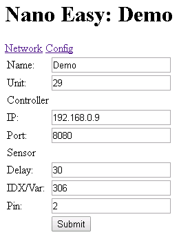

only a question - i know, nano has only 32k flash, but it is possible run a minimal config(only i/o pin) on nano?

timsson wrote:only a question - i know, nano has only 32k flash, but it is possible run a minimal config(only i/o pin) on nano?
The Arduino Nano with the ENC28J60 module may be able to work as a simple sensor device. But the bare network routines already take most of the flash program size. So it will be SEVERELY limited. I almost completely stripped the Arduino Easy code and it compiles within 30k now. But expect nothing compared to what we know from ESP Easy. I only managed to get a basic webform for config and a sensor connection to Domoticz, reading an analog port:

timsson wrote:ohh, it's sounds nonetheless good... i use mqtt with openhab - can i change from Domoticz to openhab by myself?
(maybe _C02.ino <-> _C05.ino?)
Can i test your files?
Things are not so easy with the Nano, due to code size and RAM limitations. There are no plugins as that approach will not fit. We have to use #defines and make selections at compile time. I will start a new thread here for the Nano. Source will be available soon.

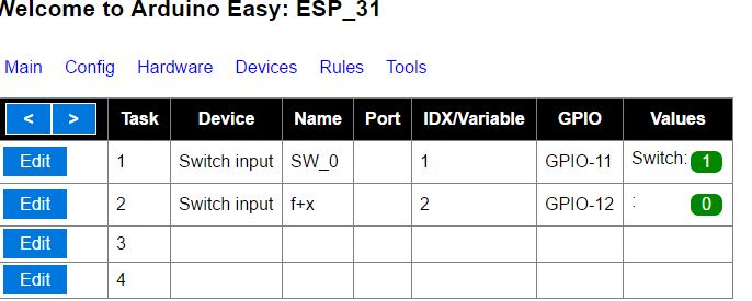

i can connect an DHT12 on the i2c bus en the scanner sees the sensor but i can't put it in devices. Can somebody help?

Frank, wonderful, thank you.Now I can start trying to make some switch inputs.

#34 Post by annakin » 06 May 2017, 16:26
Hi i have some problem.
I download on gidhub source and uploading on Mega 2560+W5100
ArduinoEasy start all good, but have 1 bug, then i try to add new Device in menu Devices i can`t.
I'm trying to select a switch for example, but when I select it, nothing happens.
UPD:
I found out that not on one page of ArduinoEasy you can not choose anything, it just is not saved.
But if I download the firmware from here: https://www.letscontrolit.com/wiki/inde ... ak_preview
And upload it into Mega 2560 then everything works.
Who can answer what the problem is.

LisaM wrote: 05 Aug 2017, 13:16 I have the same problem with ArduinoEasy with fixed ethernet, encj2860 ethernet shield , no wifi. Ping works, webserver no response...
Running all night without devices without problems.
Adding one device: webserver gone within 5 minutes.
Ping still working.
It's almost as if the webserver is looping at the device and therefor never get's to answer the incoming call.
I used the image, lets see if the source are better...

#46 Post by LisaM » 07 Aug 2017, 21:28
If i compile and upload the arduinoeasy source code mentioned earlier, compiled the image is only 115KB, it works. However changes to config or devices are ignored, submit brings back the original webform page, while changes to advanced are saved. Reboot works however.
If i use the image supplied, i can save config/devices/advanced changes (but rules cannot be saved!). However a reboot means the arduino is no longer responding to the browser calls, direct cmd calls don't work either. A cleaned (files removed) sd-card is needed to bring it back to life. If i make a device, it also fails (webserver no response). However direct cmd commands (gpio,3,1) does work (attached two leds to relay for both channels), when no device is created.
:shock:
Hw:
- Mega 2560 R3 Mega2560 REV3 (ATmega2560-16AU CH340G) Board
- Ethernet W5100 Network Expansion Board SD Card Expansion
- 5V 2-Channel Relay Module Shield (connected to D3/D4)
Info:
Unit: 8
Uptime: 0 days 21 hours 17 minutes
Load: 1% (LC=5479)
Free Mem: 2778
IP: 192.168.178.118
GW: 192.168.178.1
Build: 147
Devices: 4
(but no devices defined!)
