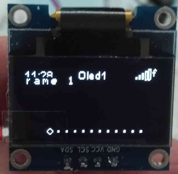

... a litte bug:
If you use the same topic twice or 3 time - the oled show nothing
(i use openhab mqtt - R131, frameOled v0.4)
Line 1: [sys#wifi]
Line 2: [sys#uptime]
Line 3: [sys#freeram]
Line 1: [sys#wifi]

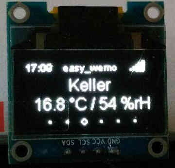

namirda,
I can confirm that it works. Wemos D1 Mini, Wemos D1 Oled shield, BME280. Display cycles through temperature, humidity, air pressure and time.
The only issue is, that the Wemos Oled display is smaller than the normal ones, it has only 64 x 48 pixels.
The standard Oled plugin has now an option for those small displays, do you think you could add that also in your plugin?
Many thanks
Uhrheber
Many thanks

hi, i have two questions related to rotation display
i'm using espmega2.0 dev7
i tested the rotation display and works fine.
but now i would like to show on rotating display value that are taken from external script, for example a script like that:
if i lunch this script, it works, i'm able to see the result but not displayed with frame rotation, but all the value on one page.
how i can see for example n°2 row on every page and using "big characters as possibile" ??
second question:
i heve 2 display oled one 0.96" and one 1.3"
to use the 1.3" i have modify the surce code as sugested in a previous pos
changing the line:
i see the code of framed plugin but there are't the value like before that i could modify. how i can solve?
with 0.96" oled there are no issue
thanks so mutch!

Nice job! I'm using it with a .96 Oled right now; the Wemos 96x48 disp and with a bit of cheating I managed to make it fit to my needs so thanks a lot. Any intention to adapt it to other Oled like the Wemos shield and the new 32x128 one ? If not I'll try to monkey with the code to the best of my knowledge (hear, learn from the beginning) but if you do intend to make it I'll burn a candle to your altar and geek to other things.
Again: Thanks a lot for your work.
Cheers !
EDiT: 128x32 can be used with some tampering too, I guess updating the plugin to support those two screens should not be a problem.

Re: OLED Scrolling Display
problem solved - see subsequent post.
quite embarrassing - I created a howto thread elsewhere and now people complaining.
This shows my old units:
Big disappointment now - tried to make 3 additional setups but couldn´t get them to work. When sending text to frames using mqtt oder html the text ("frame 1") is appended to the first line in small characters. When writing manually to the device config directly, it looks as before. This happens with the 2.0.0.0-dev7 as well. different hardware? can´t see difference optically. compiling the sketch doesn´t throw errors. What happened?starfish wrote: ↑24 Feb 2017, 17:44 Success - using newest espeasy R148 from github and Arduino IDE 1.8.1 with esp8266 board package v. 2.3.0
P210_MQTTImport.ino is already provided and works out of the box. P205_Frame_OLED.ino together with Extra_Utilities.ino compiles without error.![]()
removed all arduino remainings on PC and did clean portable install. moved libraries from old R120 and esp8266-oled-ssd1306 lib from playground to portable/sketchbook/libraries and R148 as well as 205_Frame_OLED.ino and Extra_Utilities.ino to portable/sketchbook/ESPEasy
