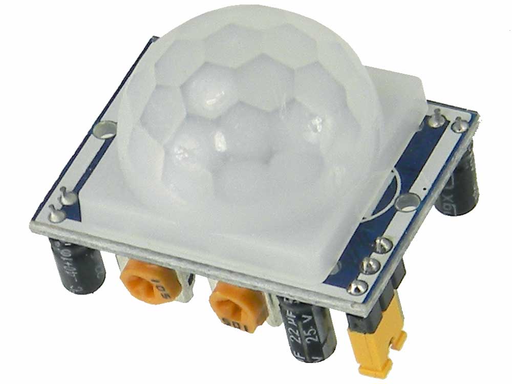

Hello guys,
the last hours i did some testing with a nodeMCU/ESPEasy and one of these qusetionable PIR modules.
This one, exactly:
https://images-na.ssl-images-amazon.com ... SX355_.jpg
I've chosen this one because sensivity, hold time and retrigger is setable.
I did just a breadboard test and i can confirm the "on/off/on/off" problem.
But i can confirm that the problem is not a EMI-problem (interferences from HF) too.
First i connected the PIR as usual, +3,3V from nodeMCU, GPIO and ground. On/off/on/off.....
Second i connected a separate 5V power supply to the PIR - same.
Then i put a transistor with a LED on the output of the PIR and switched off the nodeMCU - modul works perfectly.
At last i connected back the nodeMCU but leaving the transistor with LED in the circuit - surprise, surprise, it works.
It works even when the PIR is laying on the ESP's antenna (ingore the WeMos above, it's just another testing):
Yes, even that works!
It seems the PIR misses a pull up resistor and the built-in of the ESP is not suitable for what reason ever.
My last try was a 10 KOhm Resistor from +3,3V to the output of the PIR. It works as wanted that way.
If the chip on the sensor has just an open collector output this would leave the GPIO between "low" and "undefined"
which may generate unpredictable behaviour.
Hope that helps
Regards and Happy Easter Days
PS: I should mention:
I tested both variants, with and without a capacitor on pin12 & 13, both work.
Settings: shortest delay, highest sensivity, jumper to the corner of the PCB (not as shown in the picture).
S.

This one, exactly:
Hope that helps
S.
So far I can confirm your trials. I have three units running inside the house with PIR with longer cables attached, they seem fine (2xnodemcu + wemos d1 pro mini). However the outside unit (also nodemcu) has been giving me trouble... lots of chaotic behavious like discribed in the post. It seemed to be worse during the day than at night (domitcz log) . it was also the only unit with the PIR in the same housing as esp. So I tried to extend the cable.
However , this did not make a difference, still chaotic behaviour. I then soldered an additional 10K Ohm Pull-up-Resistor as per your advice, and , touch wood , so long it is running stable. I had stable days before, but tomorrow in the daylight will show for sure. Will keep you posted
Thanks and happy Easters

Hello toffel960,
i'm still monitoring my breadboard since yesterday and it's behaving nice up to now.
Following the datasheet's schematic https://cdn-learn.adafruit.com/assets/a ... SS0001.pdf the HC-SR501 should not have an open-collector output so there shouldn't be a "undefined" state. So i can't explain atm why the resistor seems to work. (To be honest something i can't stand)
Anyways, thanks for confirming that it not only works on my higgledy-piggledy breadboard
Happy Easter to all forum readers

Hi Shardan,
Very interesting findings of you and I tried to figure out a reason.
The link you provided has an error it should be : https://cdn-learn.adafruit.com/assets/a ... SS0001.pdf.
Looking at this pdf it seems to be a datasheet for the BISS001 and at the end a typical application schematic. No reference to the SR-HC501 module in this document.
Another link https://www.mpja.com/download/31227sc.pdf claims to present the real schematic of the HC-SR501 PIR module.
I have a module like this but am away from home so cannot check my module's output details.
The big difference seems that in the 'real' hc-sr501 there is nothing connected to the Vo output pin, just a series resistor of 2k2 to the output connector.
In the typical BIS001 application there is a series resistor of 2k2 and then a NPN output transistor.
So in a real application Vo is connected to resistor (1k) in series with a (base-emitter) diode to ground. So the output is effectively pulled down to <1 volt. Maybe when leaving the output of the module open or loading it with a high impedance input of a ESP with a weak pullup the BISS001 is not feeling comfortable.
It could be that there is some sort of feedback inside the BISS001 chip, leaving the output unloaded or weakly pulled up causes the instability.

Hello Costo,
i know that. Just it's the only datasheet for the chip itself i've found. The schematic is - besides the additional transistor - same with the PIR module.
Well, as far as one can trust the schematics found in the net
. My modules have an 1KOhm serial in the output.
Due to the schematic in the datasheet it can't be an open collector output. In case of an open collector output the transistor would not get a positive voltage to open.
I took a bare module and put my digiscope at the output. That says it has clean voltage output. The supply voltage on the board is clean too.
What i can see is a somewhat high impedance on the output.
Just the output connected to the scope says 0V for low and around 3V for high.
If i put a 10K resistor from output to ground i get 0V for low and 2,9V for high.
The same resistor put between out and +5V (5V is a bit unfair, i know
) gives 3,6V for high and 1V for low.
According to those values the output impedance including serial resistor is around 2,5KOhm for "low" and about 25KOhm for "high".
This "high" impedance might be the reason for the sensivity against HF interferences.
Happy Easter

Just a little update, the PIR outside the house is running stable the third day now. I updated the wiki concerning PIR under switch. I think many newbies don't understand that every sensor that gives a digital (1/0) output can be used as switchShardan wrote: ↑16 Apr 2017, 17:15 Hello Costo,

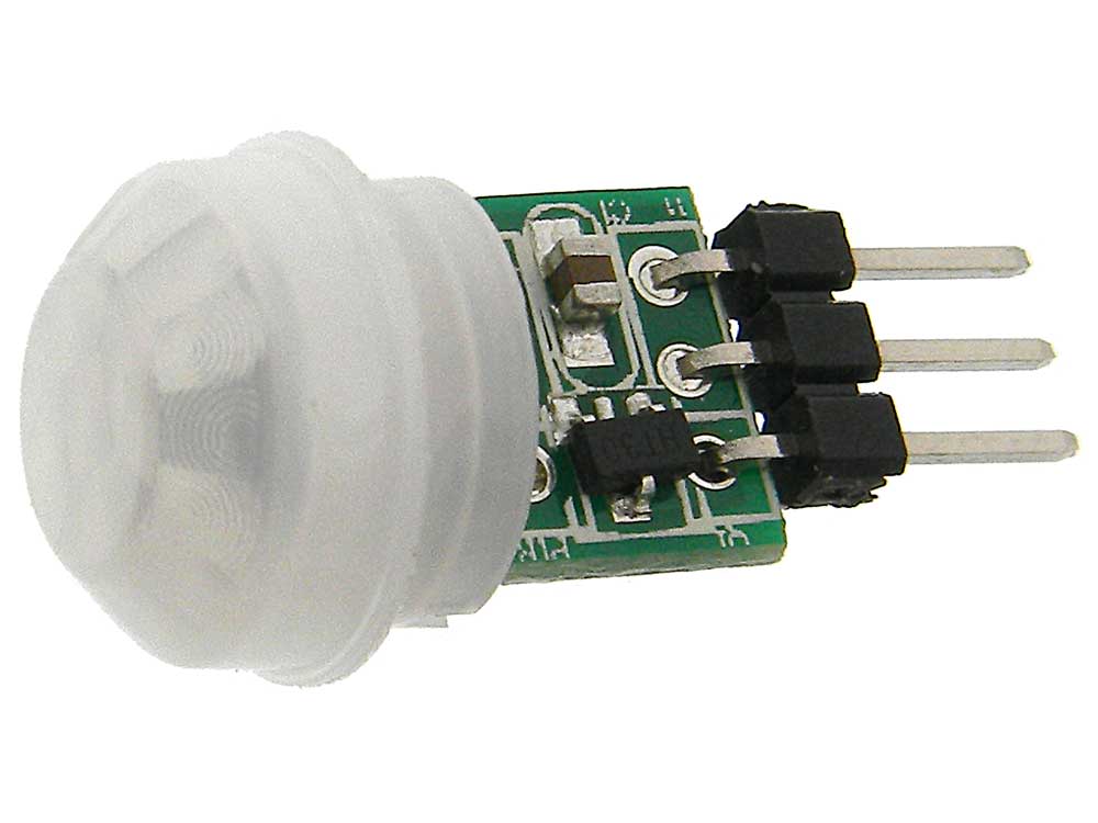

The sensor i used has it's own voltage regulator from 5...15 Volts to 3,3V.
i can't say what the small sensors use, i didn't test them yet.
The PIR's with their own regulator will not work easily with 3,3V as the regulator needs some volts for itself to work.
This so called "Drop Out Voltage" usually is about 1V or higher, so it needs at least 4,5 V to work.
As i need 5V anyways for the ultrasonic distance sensor i use a 5V power supply and placed a voltage regulator for the ESP-12E on the board.
You can see it on the second picture below the ESP, the black square is a LF33 regulator.
If i may suggest, give it a try with a 5V-power supply for the PIR and see if it works.
Be carefull, the small PIR's may give 5V at the output, this will damage the ESP.
The big ones (your pictures 1 and 3) give 3,3V output, that's safe.
