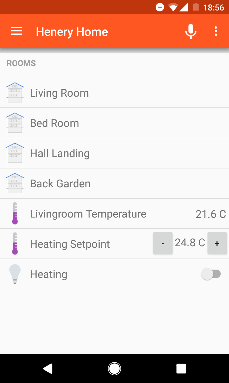

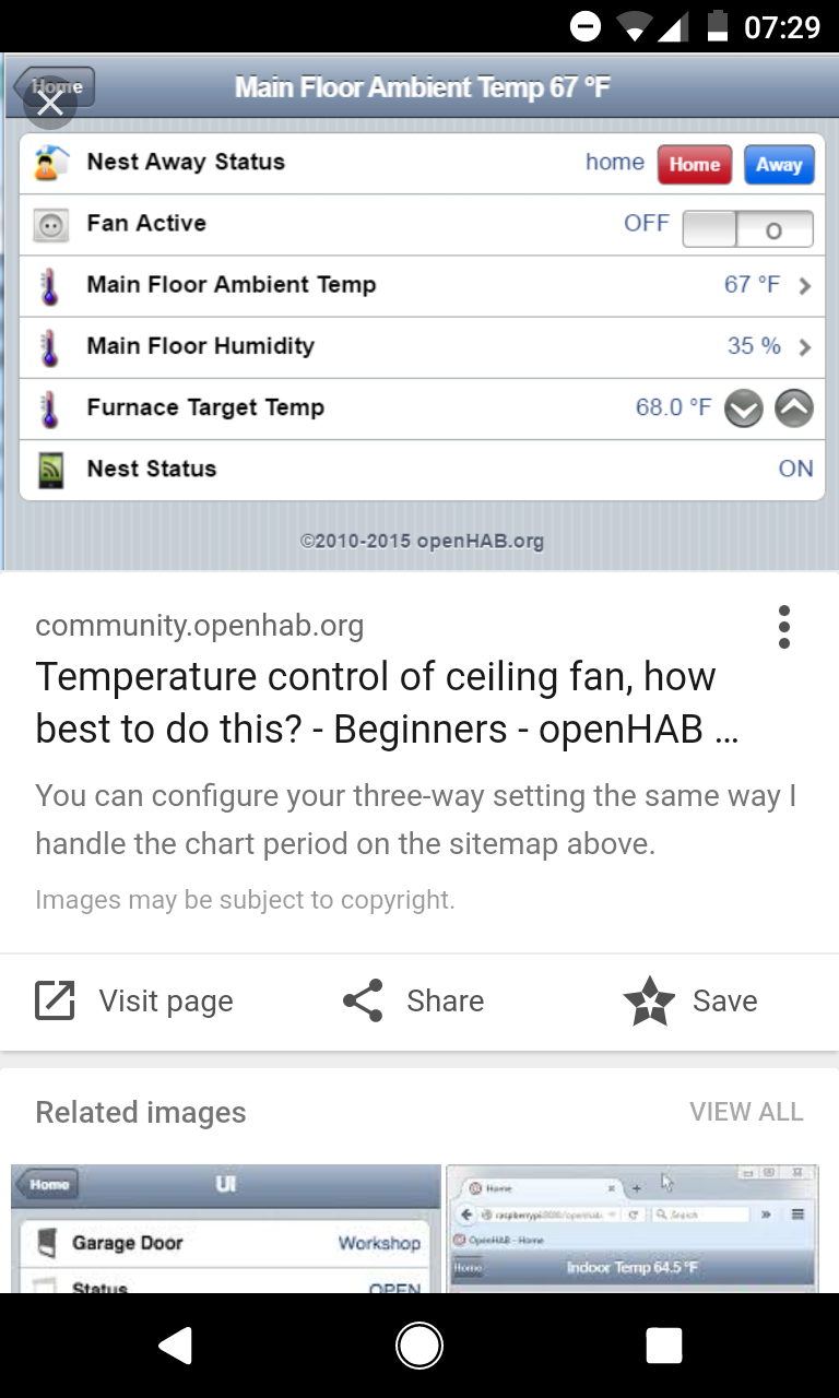

Re: Ds18b20 temp and relay control via openhab

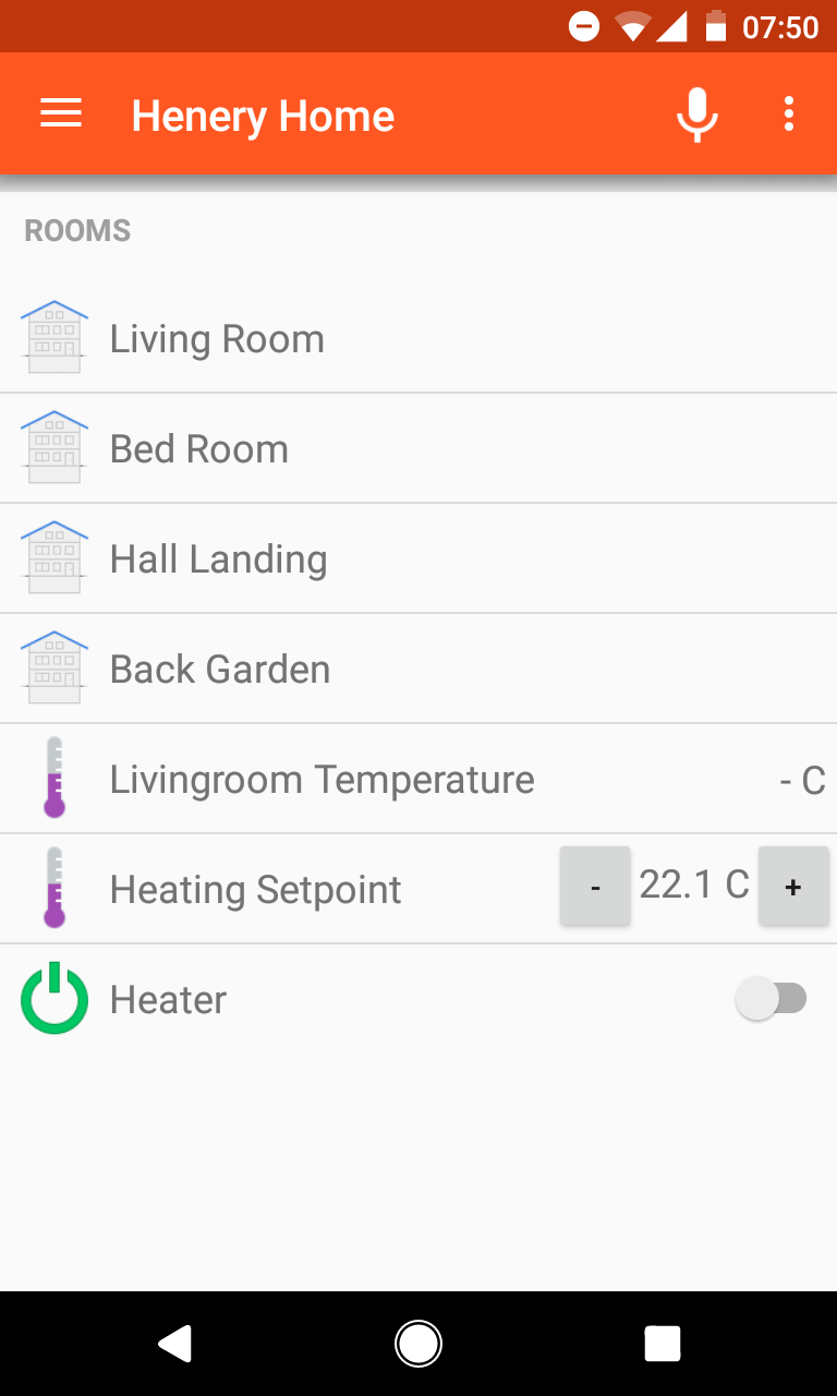

Thank you very much for your reply.
I now have my temperature with a heating switch underneath.
Do you know if it is possible to have and up down control switch of the heating temperature? As in turn the relay on or off like a thermostat depending on which temperature you see. A bit like this?
Kind regards
Steven
Kind regards
Steven
- Screenshot_20170509-072904.png (232.29 KiB) Viewed 24423 times
Yes it's very doable, I use something similar to work my Heatpumps. I'll take a look in the morning and give you a few clues, although you might be better putting the question on community.openhab.com

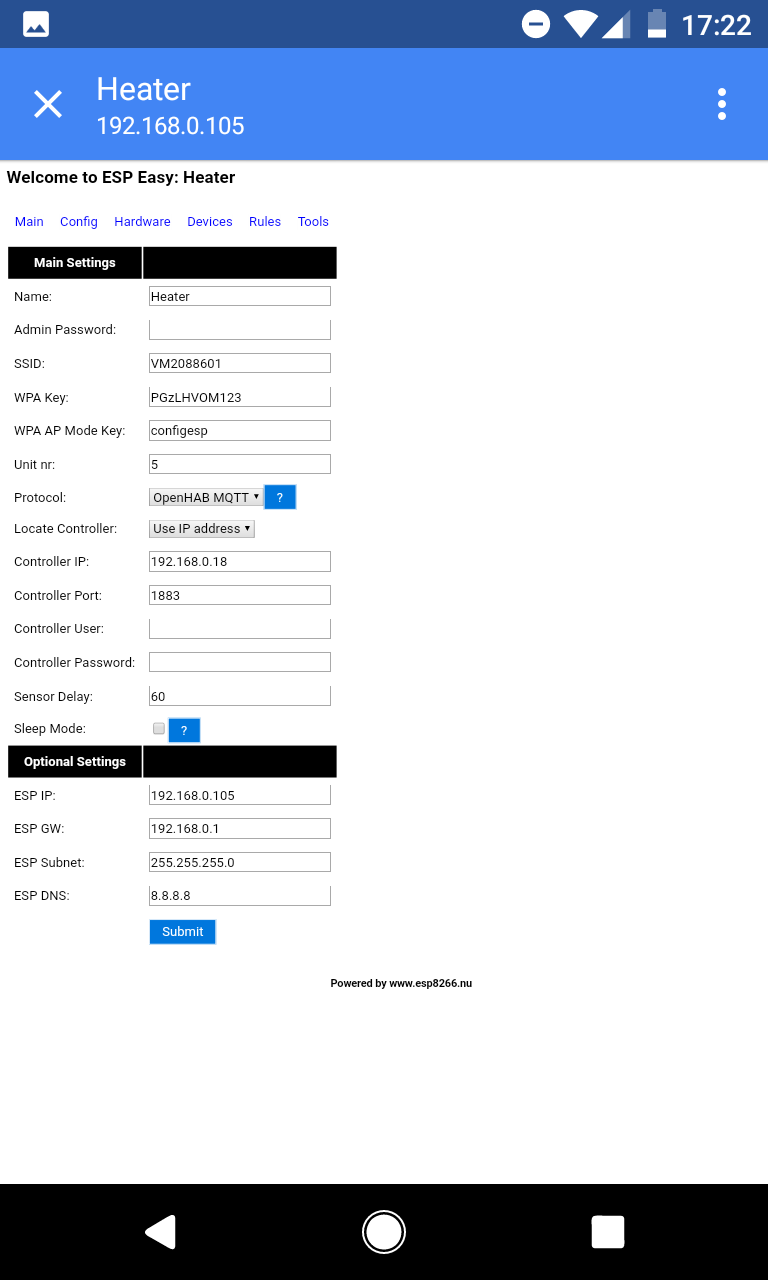

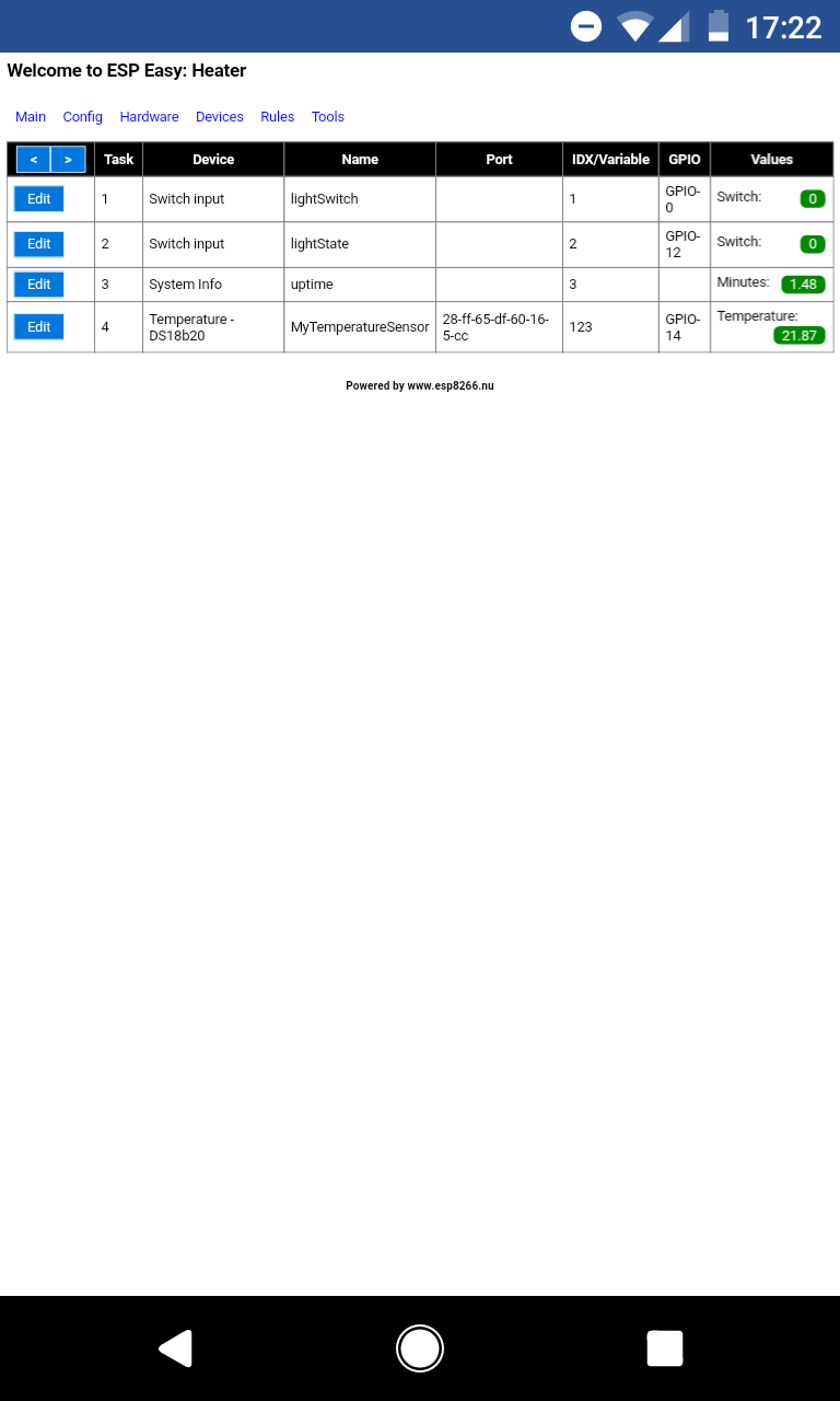

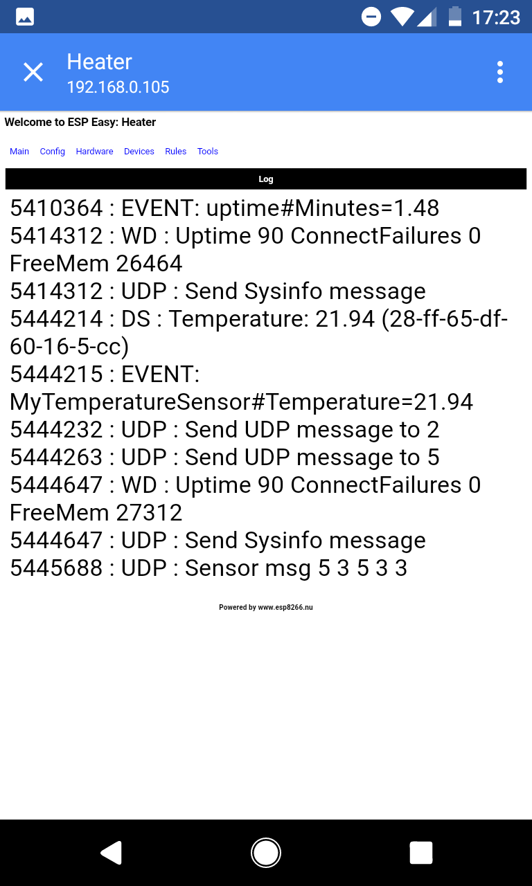

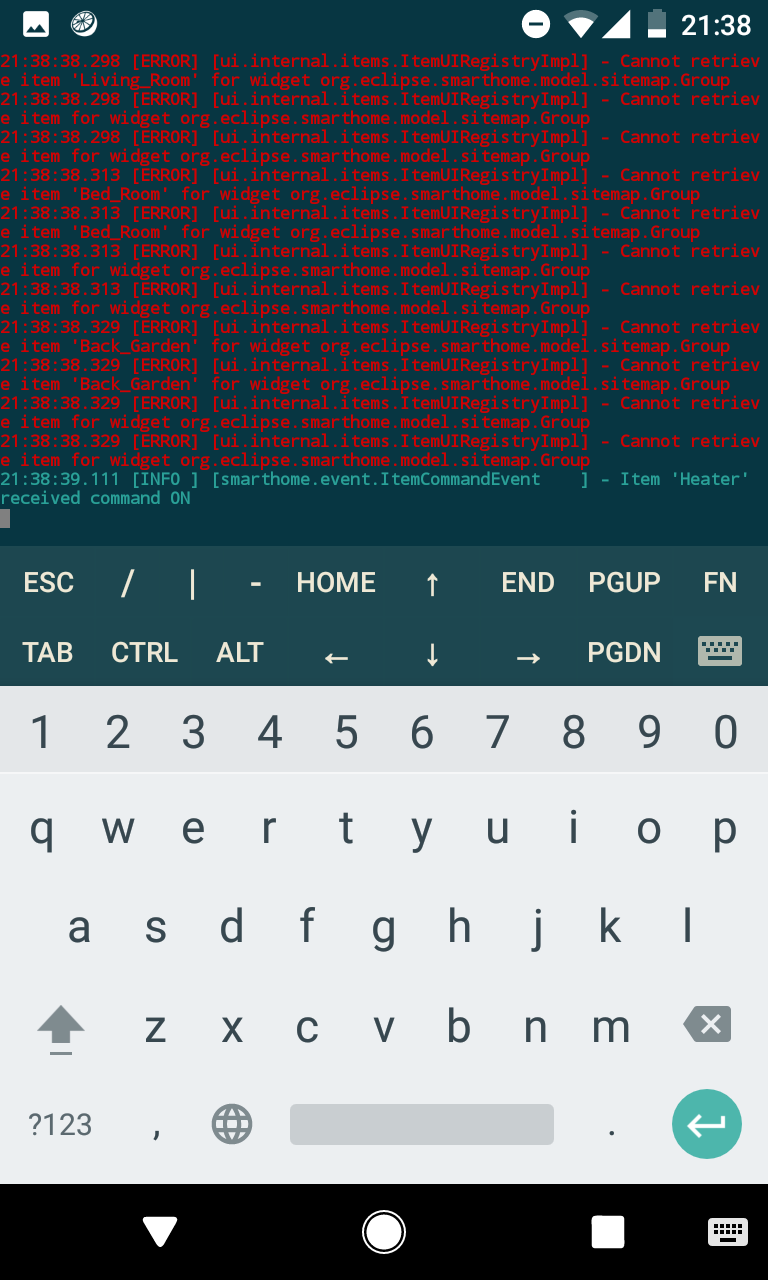

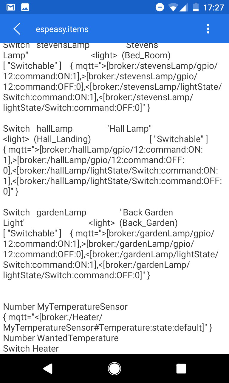

OK so I think I'm nearly there.
I have my sitemap looking not bad and can turn on off the heating but I am having trouble getting the temp to display in openhab. Its reading fine in espeasy log so is working.
I think I need to alter my code slightly.
- Screenshot_20170510-172737.png (193.12 KiB) Viewed 24340 times
- Screenshot_20170510-172314.png (147.5 KiB) Viewed 24340 times
- Screenshot_20170510-172305.png (51.34 KiB) Viewed 24340 times
- Screenshot_20170510-172258.png (64.95 KiB) Viewed 24340 times
- Screenshot_20170510-172231.png (57.13 KiB) Viewed 24340 times
- Screenshot_20170510-172159.png (61.24 KiB) Viewed 24340 times
- Screenshot_20170510-075040.png (61.5 KiB) Viewed 24340 times

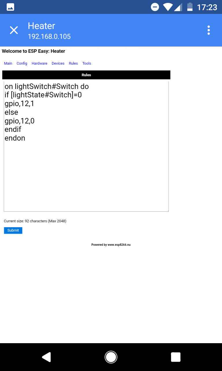

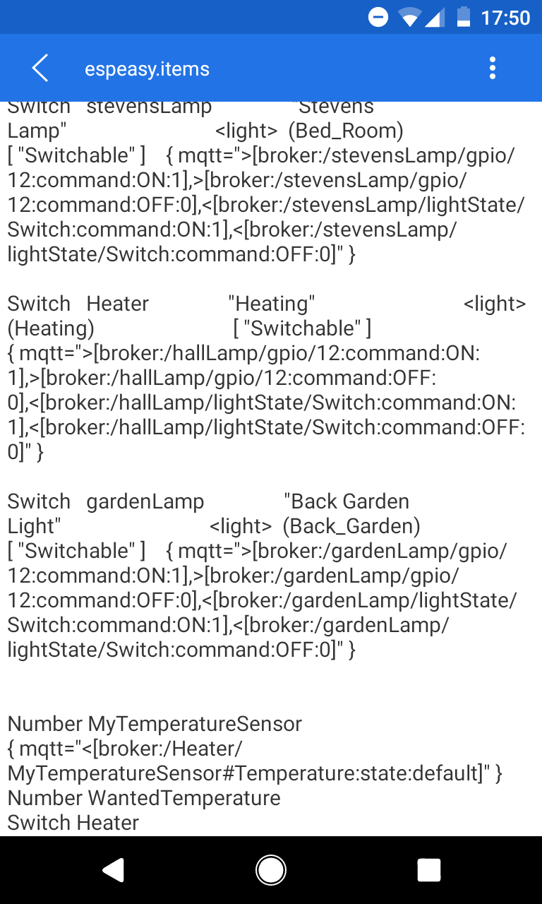

Heres the rest of my settings
- Screenshot_20170510-175124.png (61.43 KiB) Viewed 22511 times
- Screenshot_20170510-175045.png (192.55 KiB) Viewed 22511 times
- Screenshot_20170510-172801.png (112.73 KiB) Viewed 22511 times

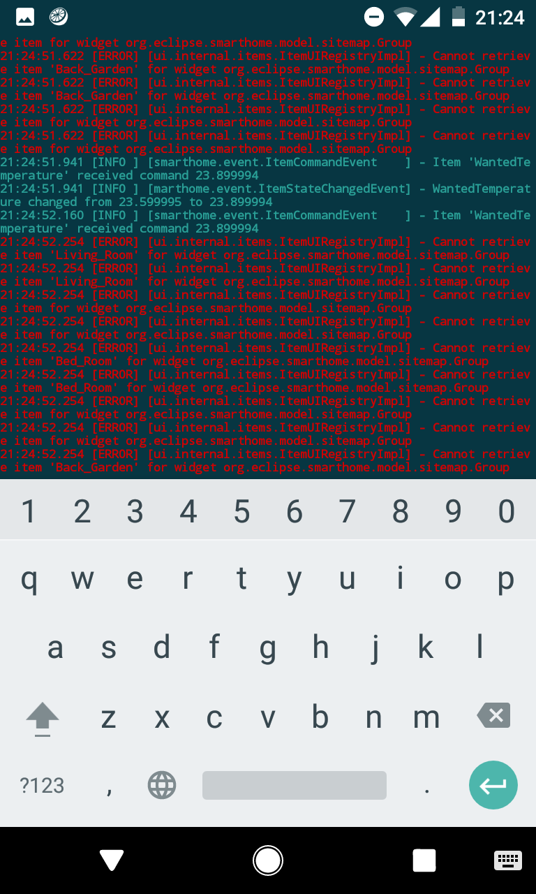

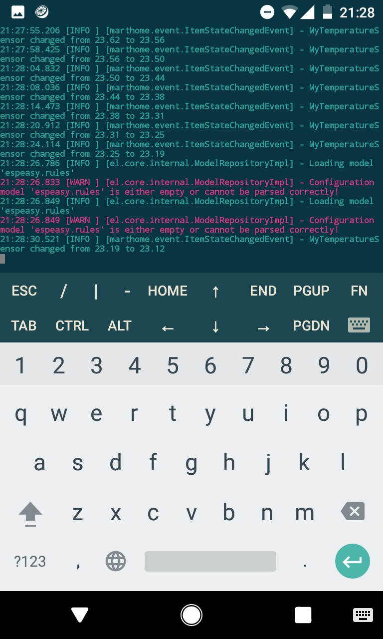

I managed to get the temperature reading in openhab. I had the mqtt location wrong.
I have also created a .rules file in openhab which I didn't post before but still when I increase the temp in openhab my heater doesn't go on.
- Screenshot_20170510-192403.png (101.55 KiB) Viewed 22505 times
- Screenshot_20170510-185657.png (62.73 KiB) Viewed 22505 times
Ok I've tidied things up a bit but I still can't get it to do what I want. When I have the heater on and decrease the temp the relay should switch off right? And switch back on when I increase the temp?
I can turn my heater on and off but now with temperature adjustment.

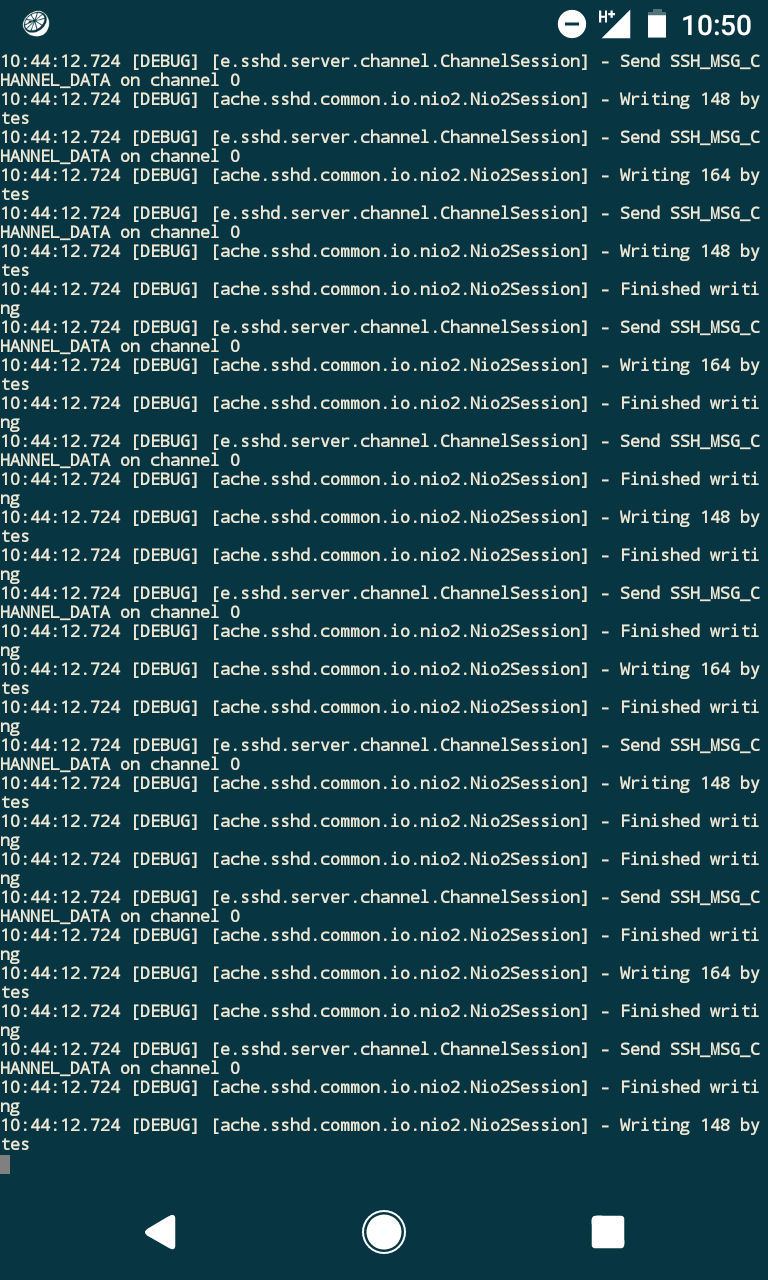

OK, lets see what is working.
Change your rules file to read
"Rule set default temperature"
when System started then {
postUpdate(WantedTemperature, 21)
end
rule "test what is working"
when Item MyTemperatureSensorChanged or Item WantedTemperature changed then
if (MyTemperatureSensor.state !=NULL) { // add in any checks after the NULL statement to ensure the reading is valid
var WT = WantedTemperature.state as Number
var MT = MyTemperatureSensor.state as Number
logInfo("Testing", "Wanted Temperature is " +WT
logInfo("Testing". "Sensed Temperature is " +MT
end
Now open up openhab.log - if you have Raspbian Jessie and an apt-get installation it is found in /var/log/openhab2 and can be seen live by typing

Ok here's where I'm at.
I have openhab log working and I can now see sensed temperature
I can see wanted temperate
I can switch my heating switch on and off manually but not with altering the setpoint in the sitemap.
In the log with original rules you sent when I change set point I get wanted temperature changed but I don't see a command for on or off to the switch.
I have attached some screenshots.
Kind regards
Steven
And here's one of me switching the heating on manually.
- Screenshot_20170512-213837.png (168.89 KiB) Viewed 22922 times
Not even getting a decent log reading now. Don't know what I've done wrong. When I do log:tail I get endless readings and they go that fast I can hardly read them.
- Screenshot_20170514-105023.png (222.04 KiB) Viewed 22878 times

I managed to get it working at last!
worked out how to find errors with eclipse smart home and turns out I had " in the wrong place. It was to the left of the. "Rule instead of rule " regulate temperature.
Thanks for all your help sheppy. I now have a working WiFi thermostat.
