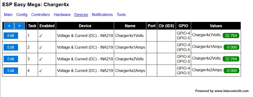

- View of devices 0x44 and 0x45 with 0x45 activated.
- Devices3and4After_20170606.jpg (85.35 KiB) Viewed 22550 times

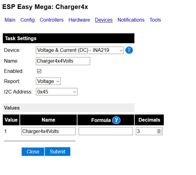

- Details of the 0x45 INA device.
- Device4Details_20170606.jpg (48.2 KiB) Viewed 22550 times
- This is the view before I activate the 0x45 device. i.e. All other INA devices measurements look good.
- Devices3and4_20170606.jpg (84.42 KiB) Viewed 22550 times

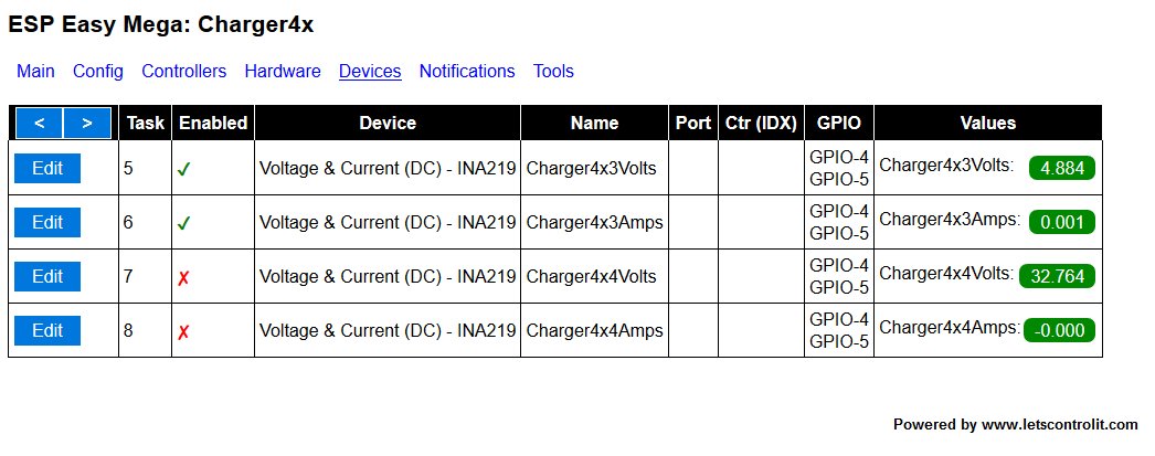

- dev_10 build with all but the 0x40 devices deactivated - Amps and volts read pretty much the same values which is incorrect. i.e. My circuit is expected to measure about 800mA, not 3000mA
- Device1ActiveOnly20170607.jpg (91.06 KiB) Viewed 22458 times
- 120 build - good values using the same 0x40 device as per other screen shot
- Devices1_20170606.jpg (73.77 KiB) Viewed 22458 times

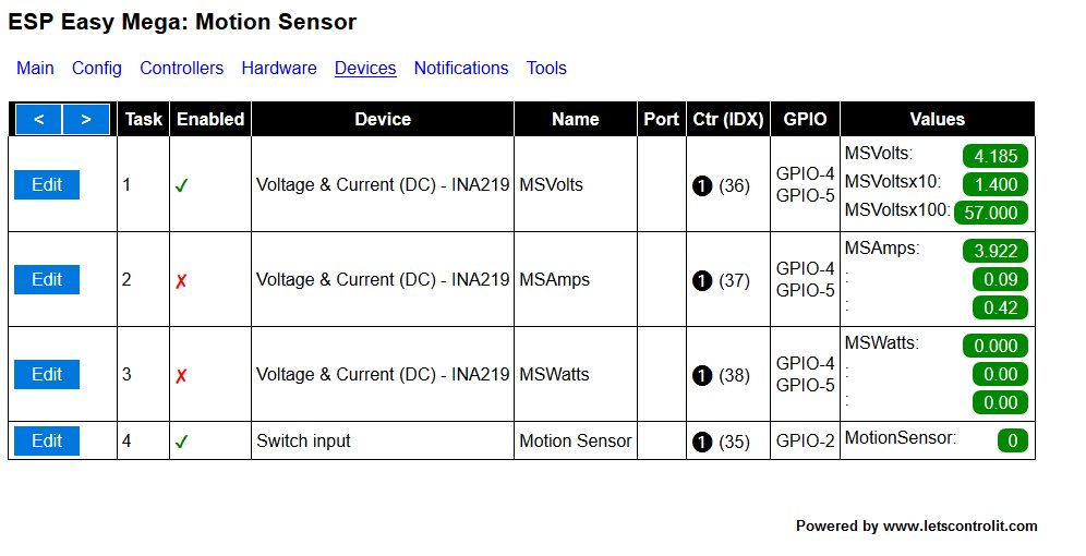

Re: Release v2.0.0-dev10 - Bug? INA219 I2C 0x45 problem
With a home built dev_10, even the 2nd and 3rd elements of a value (such as volts) seem to be all over the place. i.e. In the 2nd element, I multipled the %value% by 10, and in the 3rd by 100. ...but the values don't make any sense and they appear to be purely random. There's a serious problem here and I'm completely stuck in attempting to use the INA219 device in the DEV builds. I really wanted to use more than one INA device, but even one of them on its own is unuseable. Sorry guys, but it's a real shame that this problem persists. Guess I'll have to wait for a while until someone comes up with a fix. ...assuming anyones actually reading this.
- The optional elements for voltage (in this case) don't make sense.
- Device0x40_20170608.jpg (89.38 KiB) Viewed 22445 times

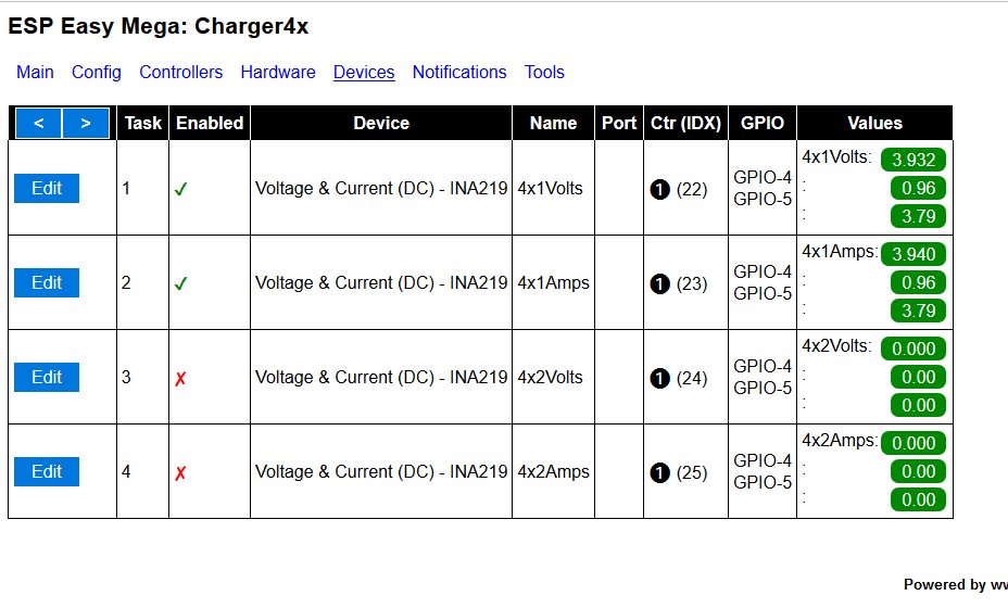

Okay, together with my friend we have now come to the conclusion that you have misunderstood how the new plugin design work (I know, it's not really clear). You can see that the first two values in your setup multiple the third value. (V*A=W).robatbentley wrote: ↑09 Jun 2017, 00:30 With a home built dev_10, even the 2nd and 3rd elements of a value (such as volts) seem to be all over the place. i.e. In the 2nd element, I multipled the %value% by 10, and in the 3rd by 100. ...but the values don't make any sense and they appear to be purely random. There's a serious problem here and I'm completely stuck in attempting to use the INA219 device in the DEV builds. I really wanted to use more than one INA device, but even one of them on its own is unuseable. Sorry guys, but it's a real shame that this problem persists. Guess I'll have to wait for a while until someone comes up with a fix. ...assuming anyones actually reading this.
Each device has all three values V, A, W (in that order).
See my friends setup:
So when you find them all over the place they are in fact correct but you mistakenly interpret the A and W as volt on the first device etc.

Update1: I've rebuilt and flashed what I think is the correct source code. I can see the same setup as your friend and configured mine to look the same. ...and the figures look sensible now. ...which is great.
However, if I now want to link to IDX values in Domoticz, then how do I do this? as there are no multiple IDX elements (one for volts, amps and power) to allow its configuration?
You're right, it wasn't clear as to how this change to the config structure but guess this is what development is all about.

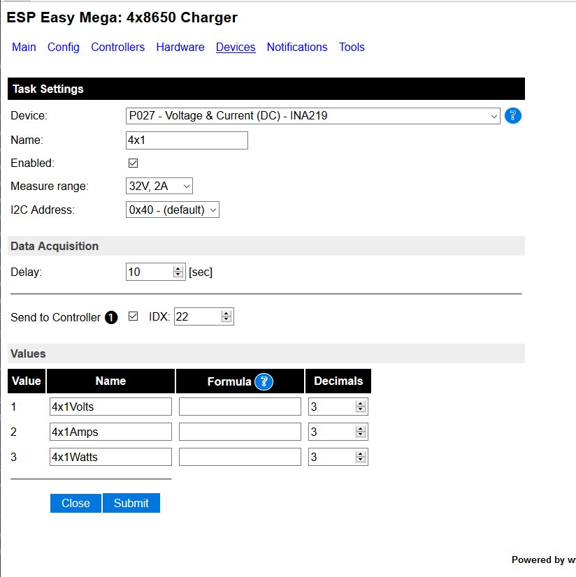

- Device 1 details with only a single IDX selection option.
- Device1Details20170609.jpg (74.86 KiB) Viewed 22380 times

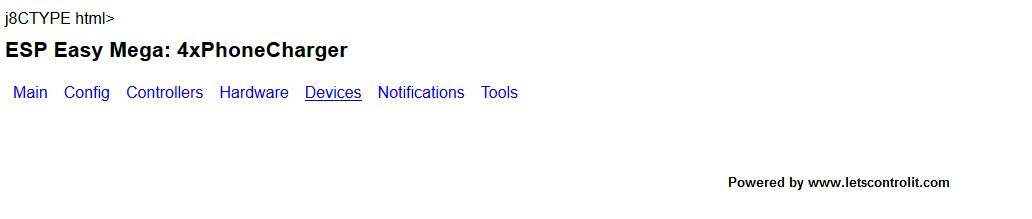

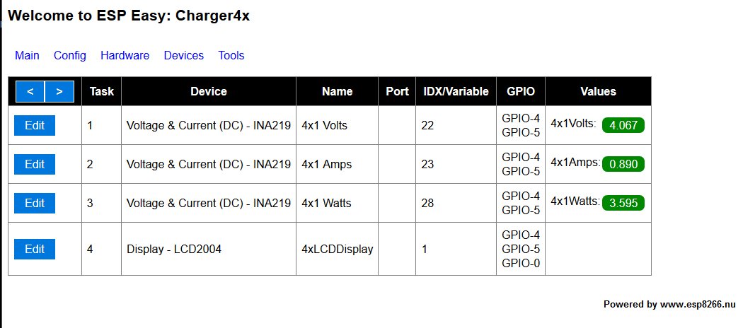

Not had time to investigate the BME280 as just blown all my 4 INA219s while moving the circuit spaghetti. Hmm!
Finally replaced and improved the test-bed layout and now back to 4xINA219s and an LCD4x20. The problem is that using the latest home-grown build from yesterday, I can no longer create an LCD device. Please see the screen-shot which is what I see when attempting to edit the existing LCD device. The screen-shot is of an existing LCD device used prior to the new flash file installation. Creating a new LCD device has the same problem. The LCD (and all 4 INAs) devices do appear in the I2C search.
Any suggestions as to what's going on here?
- LCD4x20 device not accessible.
- LCDDeviceProblem20170613.jpg (19.84 KiB) Viewed 23299 times
RobUpNorth
I think it's the bug discussed here that is causing this to happen: https://github.com/letscontrolit/ESPEasy/issues/352robatbentley wrote: ↑13 Jun 2017, 14:14 Not had time to investigate the BME280 as just blown all my 4 INA219s while moving the circuit spaghetti. Hmm!

Thanks to the guys that fixed the LCD problem for my INA219s. I've just rebuilt the ESP Easy Mega and, despite the config being quite slow to respond (don't know if it's my end or not), but I now have a working 4x20 LCD working.
I'm still using the rules to display the details in Domoticz so this is last remaining issue from my side. No hurry as the rules offer a good work-around.
