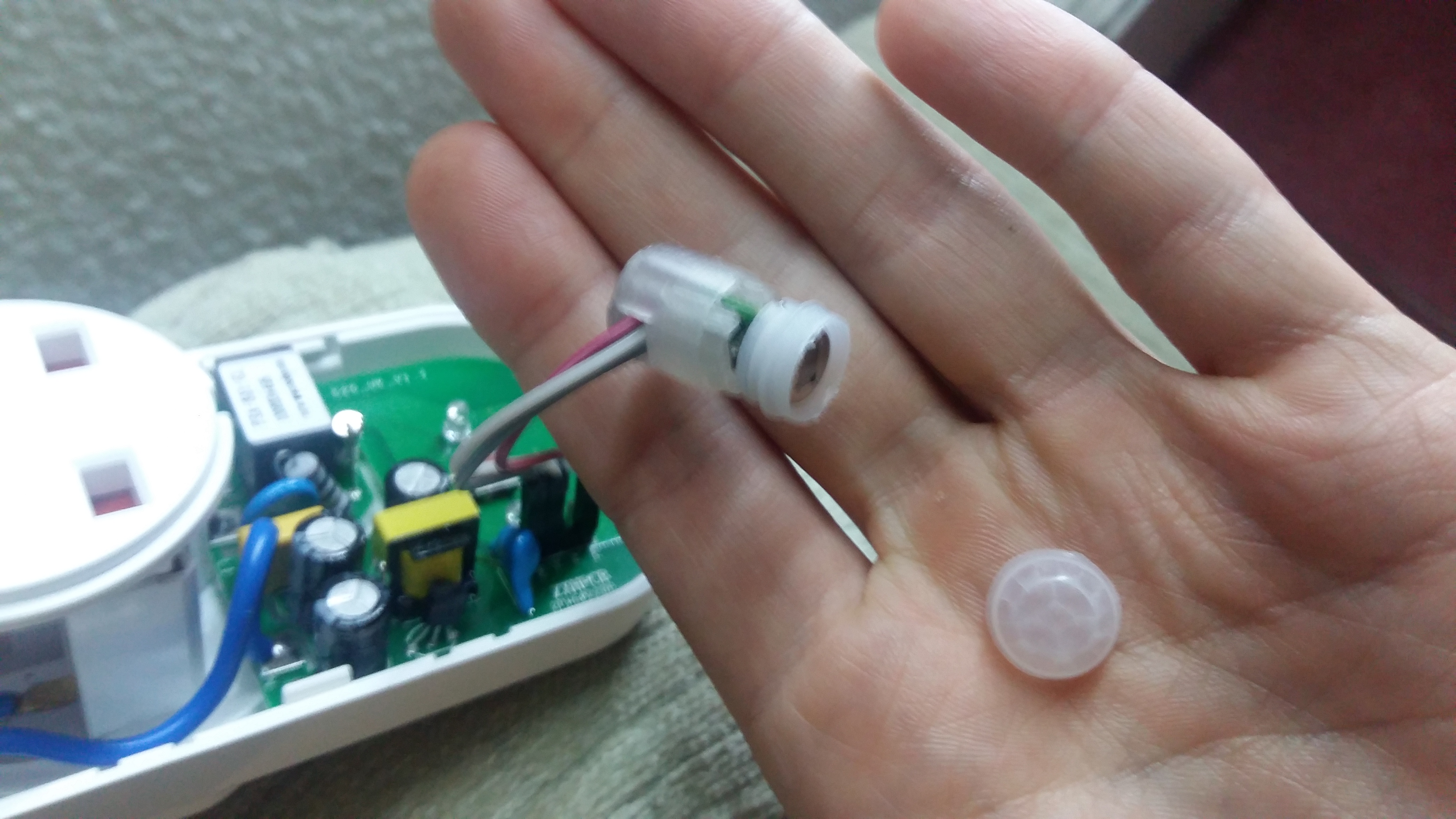

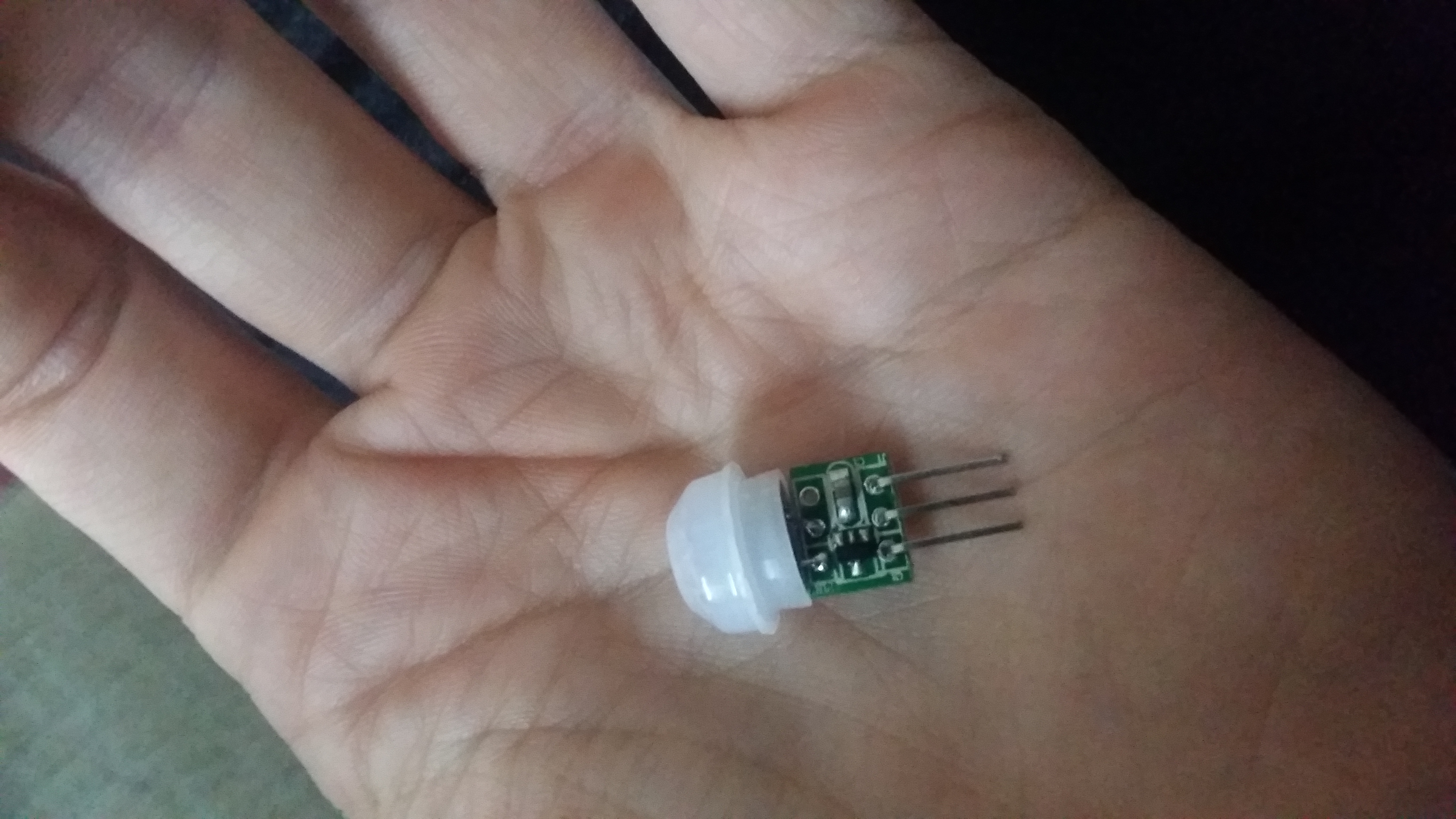

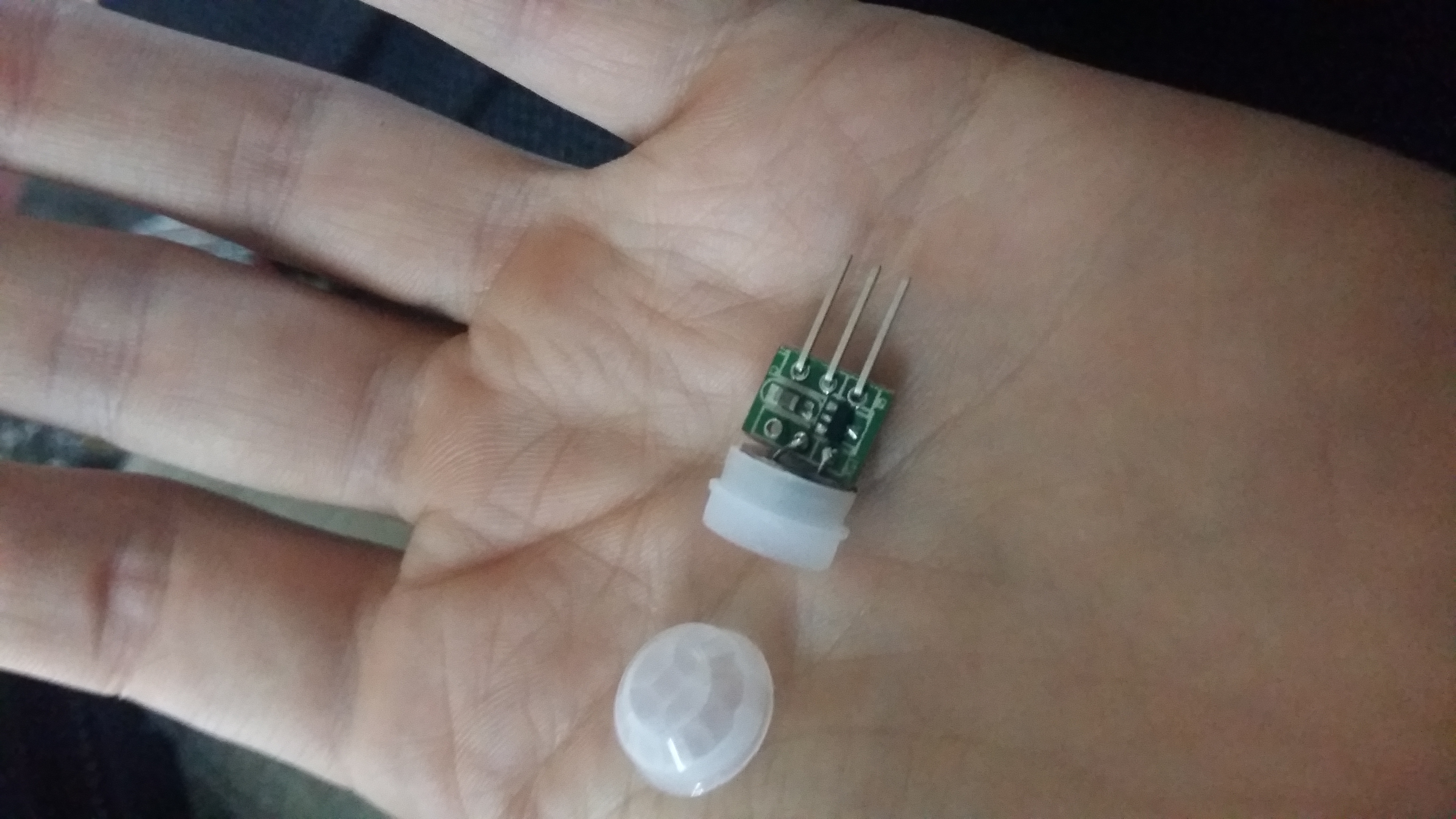

Second Step to take your PIR sensor and remove the black pin header but leave the pins, then cut the pins with snips to about half the length. Sand the sides of the PIR a little until smooth as it is a very tight fit in the insert I made. I couldn’t risk making the insert any bigger for fear of it not either fitting or not automatically coming back after you push the button.
Third – slip 3 wires through the bottom hole of the insert you printed. Then solder the wires to the PIR and slip the PIR into the casing insert. I used those cables with ends on them already that’s why I had to do this step as they wouldn’t fit through if I soldered them before. If you have regular wire skip this step

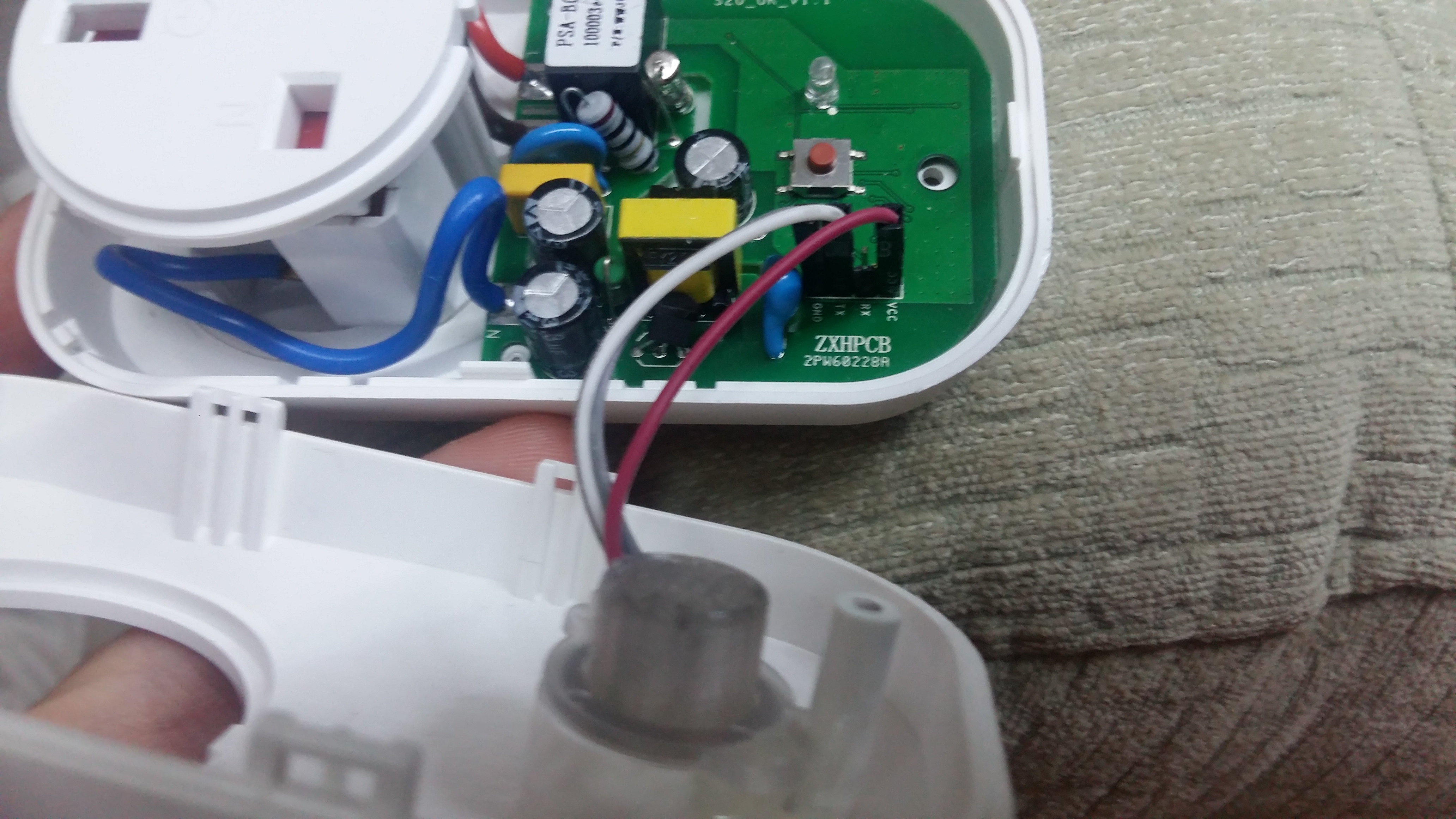

Fourth – take apart your S20 and remove the button insert, leave the clear plastic bit that is glued in.
Fifth – take the cap off the PIR and slip it through the back of the front case then refit the cap back on the pir. It should stay in by itself with the cap being on
Sixth – take the wires and hook them to ground, power and one of the TX or RX pins or solder them. I just had ones that slotted on so I could take them off if I needed to reprogram it

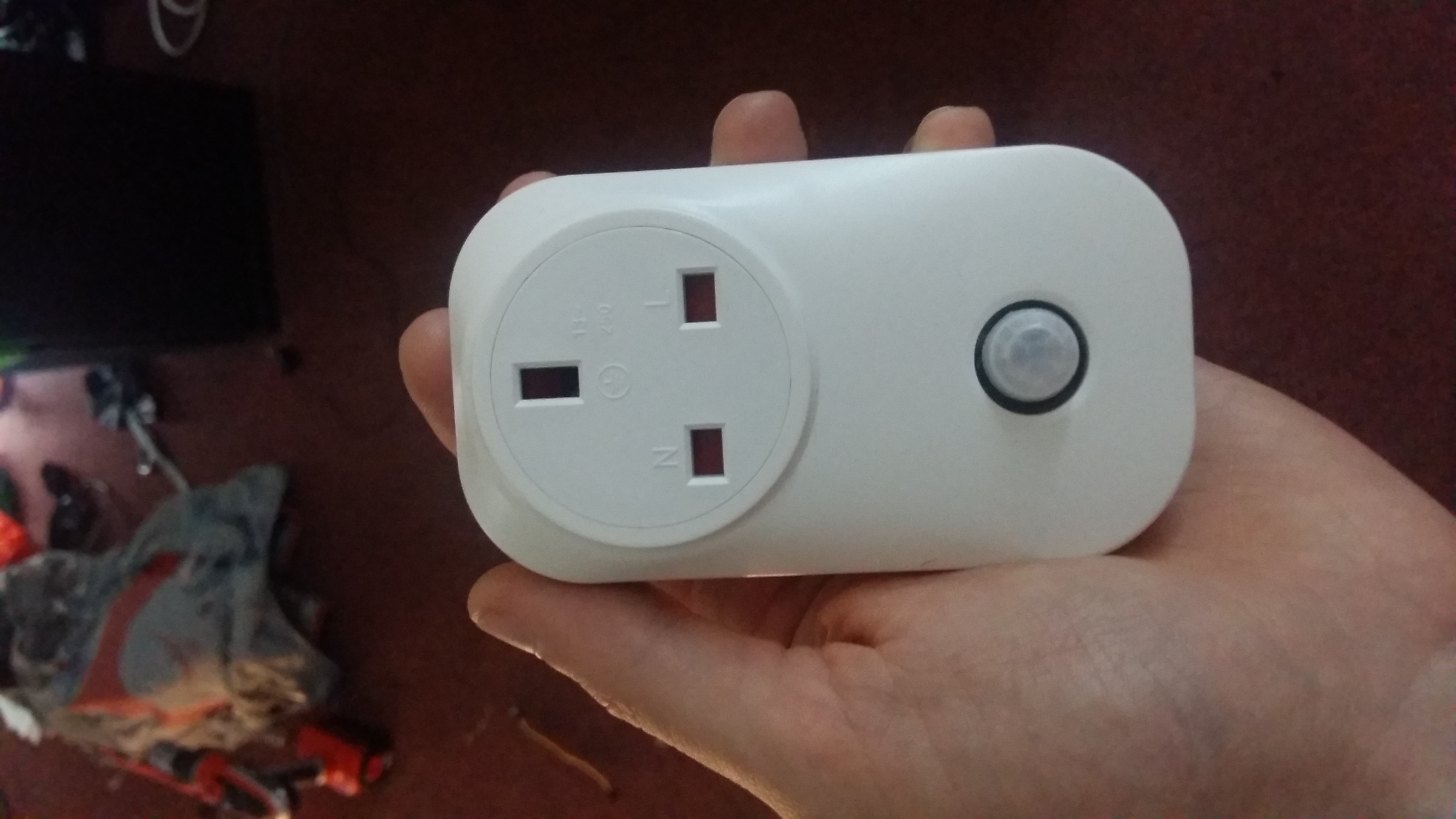

You will now be able to put it back together and the push button will still work, the green LED ring will still work (if you activate it) and you will now have motion sensing
In domoticz add a standard switch for motion sensing and configure it like you normally would for a switch
This has proven very reliable. I do not believe I have received a false positive yet. I have another one that uses radar to help track False Positive against the other one and both of them are bang on. The creepy thing is about the radar one is, it can detect movement in the kitchen (which is behind my wall) Both of them correlate when people get up. The PIR and radar flips at 635 every morning and ends at about 645. This is when my flatmate gets up and leaves. Then flips on again when I get up. The radar one is very sensitive it can detect my hand movements about 2 meters away when typing and trying to sit still. I will maybe write a tutorial on the radar one if there is demand for it but it’s very similar to this one.
