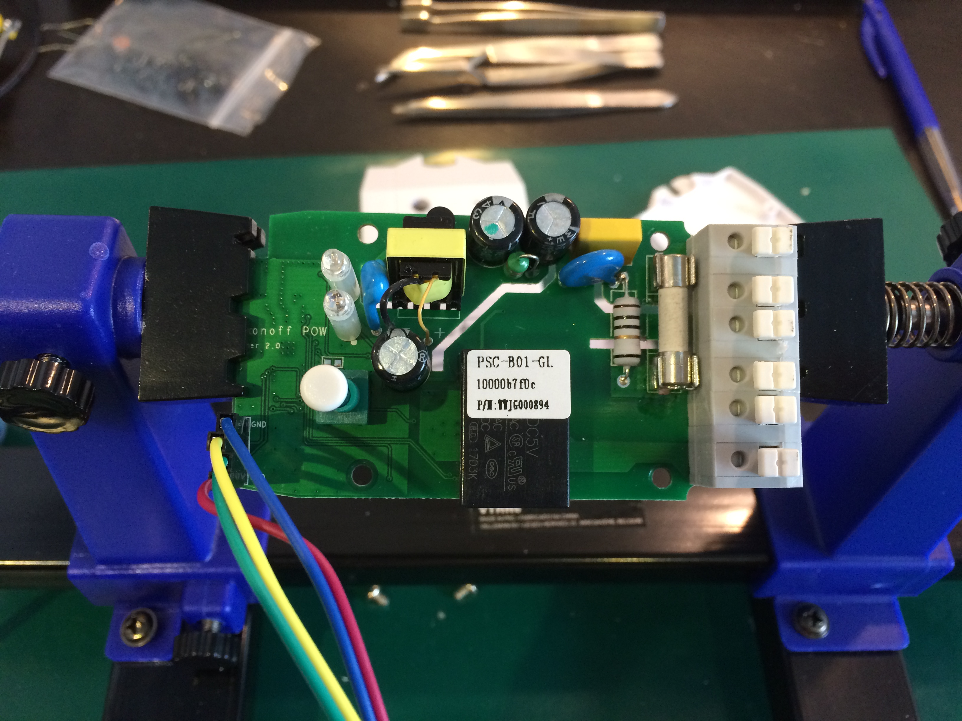

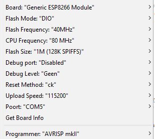

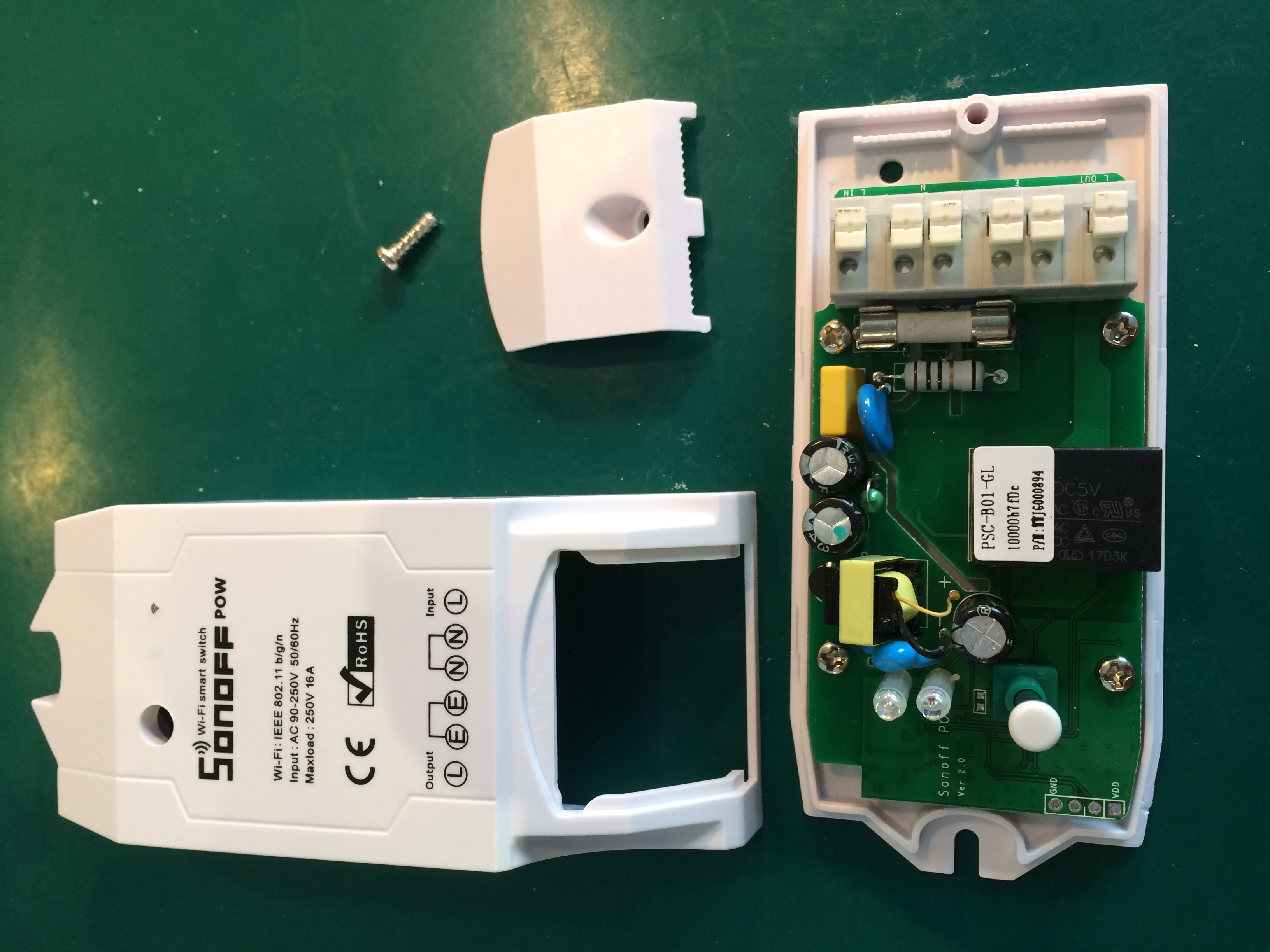

#69 Post by LisaM » 02 Jul 2017, 01:28
It's compiling, programming and working and also not...
The pow:
The bottom:
Programming:
Reboot and running:

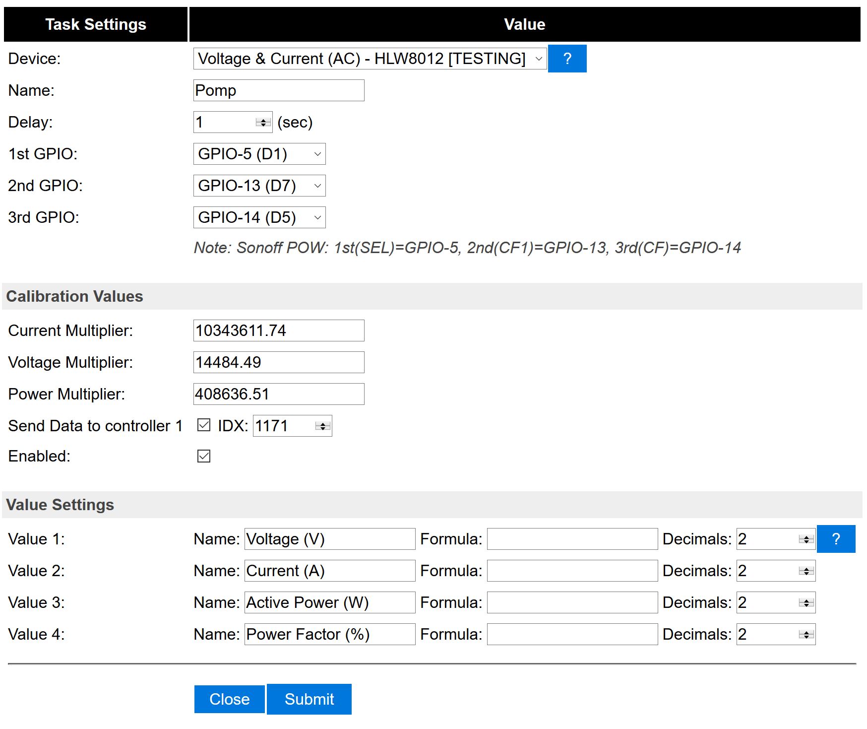

But, trying to submit this is failing:
Am i doing something wrong?

#70 Post by RE: » 02 Jul 2017, 23:10
How about setting the calibration values to 1.0 instead of 0.0 and tick the Enable box

#72 Post by papperone » 03 Jul 2017, 08:38
that's weird, as the first time the plugin init itself it shoudl be saving the calibration values if they are equal to zero.
Can you try to send the command "HLWCalibrate" to calibrate manually and recalculate the multipliers?
By the way the default multipliers must be:
Power Mult: 10343611.74
Current Mult: 14484.49
Voltage Mult: 408636.51
Will check the code deeply later today but I just tried again 2 times in the 2 test modules and after erasing completely the SPIFF I've the deafult multipliers when I enable this device :(

#73 Post by papperone » 03 Jul 2017, 08:43
As well the GUI is slightly different (probably in the latest GIT you are using they did some changes) as I do have the "delay" value in the bottom after the Controller (no big deal).
Can you try as well to setup the delay to some values? The pluing is supposed to read the values at a given interval (I tried up to 15 seconds and it does not delay the whole firmware noticeably)

I have to admit, that it's not running in test-mode but normal mode. I've removed the #if test condition from the ino file.
Entered everything:
Leading to the browser error message: 'The connection was reset'
Going back to the page shows this pictures:
So i does save the multipliers, but then completely stalls...
By the way, i only connected the 230V input side and not the output side. I did check what wire was null and phase... ;)
The node info:

The Sonoff TH16 and basic have 1MB flash size. According to the iTead POW schematic, the POW has an 25q80bvs1g flash chip which is 8Mb. So it should be 1MB flash size instead of 4MB, i'll rebuild with the proper build settings and then try again...
UPDATE: Same problem, used these Arduino IDE settings:
The Info section also shows still this:
Flash Size: 4096 kB
Maybe the POW is 4MB?
UPDATE2: It's using a 'HK 25032' flash chip and that might wel be 4MB instead of the 1MB from the schematic...
Retrying with 4MB flash compile and flash.

        addFormNote(string, F("Sonoff POW: 1st(SEL)=GPIO-5, 2nd(CF1)=GPIO-13, 3rd(CF)=GPIO-14"));
        addFormSubHeader(string, F("Calibration Values"));
        double hlwMultipliers[3];
        LoadCustomTaskSettings(event->TaskIndex, (byte*)&hlwMultipliers, sizeof(hlwMultipliers));
        addFormTextBox(string, F("Current Multiplier"), F("plugin_170_currmult"), String(hlwMultipliers[0], 2), 25);
        addFormTextBox(string, F("Voltage Multiplier"), F("plugin_170_voltmult"), String(hlwMultipliers[1], 2), 25);
        addFormTextBox(string, F("Power Multiplier"),   F("plugin_170_powmult"),  String(hlwMultipliers[2], 2), 25);

#91 Post by LisaM » 08 Jul 2017, 15:44
Changed the function to this:
        char hlwMultipliers[3][32];
        String tmpString, arg1;
          arg1 = F("plugin_170_currmult"); tmpString = WebServer.arg(arg1);
          strncpy(hlwMultipliers[0], tmpString.c_str(), sizeof(hlwMultipliers[0])-1);
          arg1 = F("plugin_170_voltmult"); tmpString = WebServer.arg(arg1);
          strncpy(hlwMultipliers[1], tmpString.c_str(), sizeof(hlwMultipliers[1])-1);
          arg1 = F("plugin_170_powmult");  tmpString = WebServer.arg(arg1);
          strncpy(hlwMultipliers[2], tmpString.c_str(), sizeof(hlwMultipliers[2])-1);
        if (PLUGIN_170_DEBUG) {
          String log = F("HLW8012: PLUGIN_WEBFORM_SAVE - SaveCustomTaskSettings size: ");
          log += sizeof(hlwMultipliers);
          addLog(LOG_LEVEL_INFO, log);
        SaveCustomTaskSettings(event->TaskIndex, (byte*)&hlwMultipliers, sizeof(hlwMultipliers));
          String log = F("HLW8012: Saved Calibration from Config Page");
        Plugin_170_hlw->setCurrentMultiplier(atof(hlwMultipliers[0]));
        Plugin_170_hlw->setVoltageMultiplier(atof(hlwMultipliers[1]));
        Plugin_170_hlw->setPowerMultiplier(atof(hlwMultipliers[2]));
        success = true;
Same result:
Unit: 5 : HLW8012: PLUGIN_WEBFORM_SAVE - SaveCustomTaskSettings size: 96
And then reboot
Function SaveCustomTaskSettings (misc.ino) :
  Save Custom Task settings to SPIFFS
boolean SaveCustomTaskSettings(int TaskIndex, byte* memAddress, int datasize)
  if (datasize > DAT_TASKS_SIZE)
    return false;
  return SaveToFile((char*)"config.dat", DAT_OFFSET_TASKS + (TaskIndex * DAT_TASKS_SIZE) + DAT_TASKS_CUSTOM_OFFSET, memAddress, datasize);
Function SaveToFile (misc.ino):
  Save data into config file on SPIFFS
boolean SaveToFile(char* fname, int index, byte* memAddress, int datasize)
  boolean success = false;
  if (RTC.flashDayCounter > MAX_FLASHWRITES_PER_DAY)
    String log = F("FS   : Daily flash write rate exceeded!");
    addLog(LOG_LEVEL_ERROR, log);
    return false;
  fs::File f = SPIFFS.open(fname, "r+");
  if (f)
    f.seek(index, fs::SeekSet);
    byte *pointerToByteToSave = memAddress;
    for (int x = 0; x < datasize ; x++)
      f.write(*pointerToByteToSave);
      pointerToByteToSave++;
    f.close();
    String log = F("FILE : File saved");
    success = true;
    flashCount();
  return success;
It never gets here:

Congrats! It's working flawless now:
Although the value is off, since it should be around 230V... No load attached though...
The used multipliers:
Current Multiplier: 10343611.74
Voltage Multiplier: 14484.49
Power Multiplier: 408636.51
Are these the right ones?
Log entries:
1820292 : HLW8012: Read values - V=7 - A=0.00 - W=0 - Pf%=0
1820293 : EVENT: Pomp#Voltage (V)=7.00
1820314 : EVENT: Pomp#Current (A)=0.00
1820330 : EVENT: Pomp#Active Power (W)=0.00
1820347 : EVENT: Pomp#Power Factor (%)=0.00
I'm currently using a custom sensor, but the syslog shows an error on the receiving side (domoticz):
MQTT: Topic: domoticz/in, Message: {"idx":1172}
Error: MQTT: Invalid data received!
Looks like the power usage data is not sent...

papperone
Posts: 497
Joined: 04 Oct 2016, 23:16
Re: Support for "Sonoff Pow" (from ITead) with Power Consumption Measurement via HLW8012 (HLW 8012) IC?
#98 Post by papperone » 12 Jul 2017, 07:32
good to hear reboot issue is confirmed fixed!!
about your points:
1) Even the ElectroDragon reads around 200/210 without calibration and default multipliers
2) You did not have controller setup for the AC Current sensor plugin so it's normal data are not sent out
In order to calibrate I do as follows:
- I connect a known load (a bulb, either filament or LED)
- I measure the real voltaga (V) with a DVM (multimeter) an current (A) with an Amperometric Clamp
- I run then when load is ON the calibration command "hlwcalibrate,VVV,AAA,WWW" where VVV is voltage measured before, AAA is current measured before, WWW is nominal bulb power in Watts (as written on the bulb)
This will recalculate the multipliers automatically with that given load and since then the readings are more accurate and realistic, even thou time to time the HLW8012 chip gives some wrong readings...
Last point is correct, the readings are not "doubles" variables, only the multipliers are.
