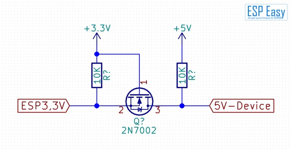

Re: ESP 8266 and HC-SR04
let me answer second question first, The level converter.
This is the schematic for a one channel level converter:
As you can see, input and output have a pull-up resistor to 3.3V / 5V. So with a voltmeter you will see 3.3V on one sinde and 5V on the other, that's OK.
A more detailed description how this circuit works is in the Wiki: https://www.letscontrolit.com/wiki/inde ... _Converter.
The ESP-01 is a somewhat limited module. The availlable GPIO-0 and GPIO-2 both are used to select start modes.
If on boot GPIO-0 is set to low the module starts into flash mode, this is used to flash a new firmware.
With GPIO-2 you can switch to a firmware on SD-Card - very much theoretical as the ESP-01 does not allow connecting one and ESPEasy does not support it.
So if your HC-SR04 pulls low one of these pins at startup, the module won't start into ESPEasy. that's correct.
The voltage divider with the relatively low resistor will always pull the pin low. A 3.3V zener diode might work better.
Anyways this are workarounds that might work or not. The sensor might activate on power-on so you always might run into problems.
Use a WeMos D1 or nodeMCU with more GPIO's and use GPIO 12/13 or 13/14 for example might be best practice here.
A possible workaround i never tried:
If you don't need the serial port, you may switch the serial transmission from ESPEasy off in the advanced settings.
This frees RX/TX and they might be used as GPIO1 / GPIO3. Serial debug is no longer possible then.
