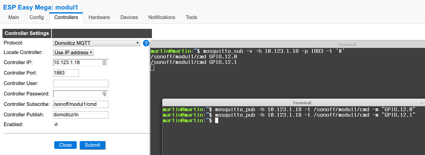

I set Controller Subscribe: sonoff/%sysname%/cmd in esp easy. Esp easy name is "modul1".
$ mosquitto_pub -h 10.123.1.18 -t sonoff/modul1/cmd -m "GPIO,12,0"
$ mosquitto_pub -h 10.123.1.18 -t sonoff/modul1/cmd -m "GPIO,12,1"
Nothing happens :-(
What I do bad?

tuxmartin wrote: 21 Sep 2017, 12:20 I set Controller Subscribe: sonoff/%sysname%/cmd in esp easy. Esp easy name is "modul1".
Nothing happens :-(
What I do bad?
/sonoff/modul1/cmd "GPIO,12,0"
/sonoff/modul1/cmd "GPIO,12,1"
Forward slash is missing in the published topic. I suggest you remove them from the subscription topic in the settings (which is the standard way) or add them in the published topic from Domoticz.

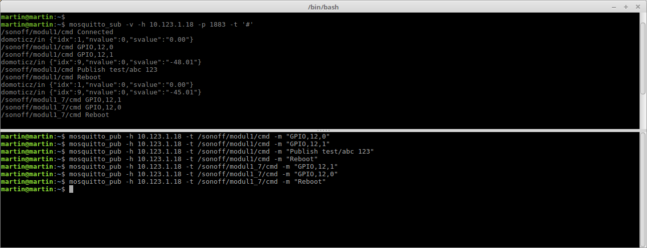

I tried it. No command is working:
I have in espeasy:
Unit Name: modul1
Unit Number: 7
In dhcp log name is "modul1_7":
Sep 21 14:25:41 baru dhcpd: DHCPDISCOVER from 5c:cf:7f:e9:c5:89 via br0
Sep 21 14:25:42 baru dhcpd: DHCPOFFER on 10.123.1.188 to 5c:cf:7f:e9:c5:89 (modul1_7) via br0
Sep 21 14:25:42 baru dhcpd: DHCPREQUEST for 10.123.1.188 (10.123.1.1) from 5c:cf:7f:e9:c5:89 (modul1_7) via br0
Sep 21 14:25:42 baru dhcpd: DHCPACK on 10.123.1.188 to 5c:cf:7f:e9:c5:89 via br0
I tried "Controller Subscribe: #" and publish to /sonoff/modul1_7/cmd - not work.
Re: Domoticz MQTT: read works, but cannot control relay
#12 Post by grovkillen » 21 Sep 2017, 15:22
/sonoff/modul1_7/#
Try that in the Controller setting.

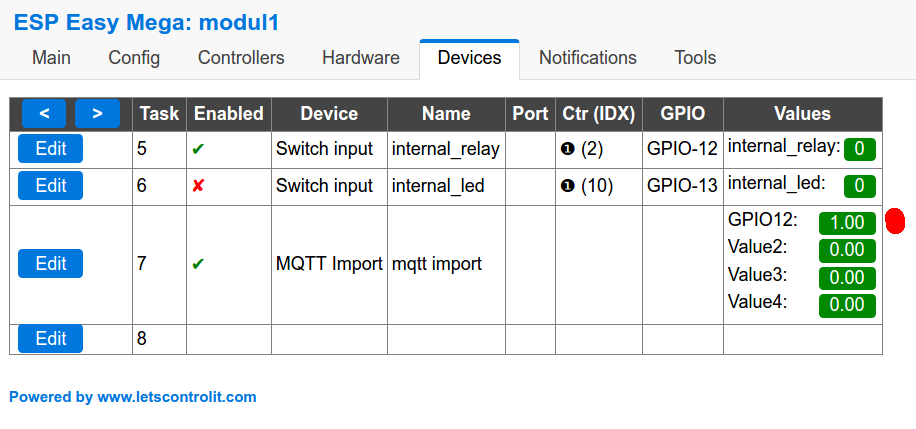

I tried to add device "MQTT Import":
If I send mosquitto_pub -h 10.123.1.18 -t /sonoff/modul1/GPIO12 -m "1" value to defined topic, espeasy show it:
If I uderstand it, now can I use variable [mqtt import#GPIO12].
But is not possible to set [mqtt import#GPIO12] to relay:
I created rule (found on forum):
on [mqtt import#GPIO12] do
  if [mqtt import#GPIO12] = 1
    gpio12,1
    gpio12,0
rule not working.
