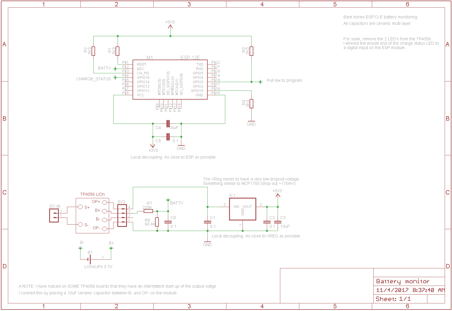

So after listening at all your very good advices, I went through that design. Does it sound correct and working ? My goal here is to charge battery and power the ESP from the solar panel and be able to measure power and voltage used by ESP ;)
I wanted also to add one more INA to measure power and intensitey of solar panel but not sure ground is common between solar connection and outputs of TP4056......

DANGER!!!!!!!!!!!!!!!! Where is the voltage regulator? 4.2 volts (a fully charged LiOn) WILL KILL a bare esp module (been there and done that :) unless your using a PCB with a vreg? Lots of detail missing out of your drawing?

rayE wrote: 03 Nov 2017, 12:12 DANGER!!!!!!!!!!!!!!!! Where is the voltage regulator? 4.2 volts (a fully charged LiOn) WILL KILL a bare esp module (been there and done that :) unless your using a PCB with a vreg? Lots of detail missing out of your drawing?
sorry bud did you really check my schema ? The TP4056 board is connected to ESP through its regulated output (as for sure battery directly to ESP would kill the ESP very quickly !!)

#24 Post by rayE » 03 Nov 2017, 13:10
Yes i checked your drawing, the TP board has NO VOLTAGE regulation, your drawing will WRECK a bare ESP module when the battery is fully charged. as for an INA board, iv never heard of it and NO IDEA what it is?
Maybe do a little more homework before letting the smoke out of the ESP module :-)
http://artofcircuits.com/product/tp4056 ... protection
And if the provided specs seem unclear THEN build the charger circuit with a battery and solar connected, UNCONNECTED to the ESP and get your DVM out.......................that's what i did :-)

rayE wrote: 03 Nov 2017, 13:10Yes i checked your drawing, the TP board has NO VOLTAGE regulation, your drawing will WRECK a bare ESP module when the battery is fully charged. as for an INA board, iv never heard of it and NO IDEA what it is?
I checked by putting usb power on board and in fact it gives me nearly always around 4V which is above ESP specs but I intended to plug that power to the USB port of ESP so it should be ok no ? Module I use is exactly the one you indicate !!

DVM = digital volt meter
If you think 4 volts is OK for the ESP then go ahead, BUT make sure you have lots of spare of ESP modules :-)
When the spec on a module specifies a MAXIMUM voltage then do NOT put more than that into it, otherwise the smoke will come out, simple design guidelines, no rocket science involved :-)

This is how i wire a bare ESP12-E module using solar and TP4056 PCB.
ESP Battery Mon.png (28.13 KiB) Viewed 33197 times

rayE wrote: 04 Nov 2017, 01:45This is how i wire a bare ESP12-E module using solar and TP4056 PCB.
Thanks a lot for the share so will use your schema to build my one ;) Is it well 0.1uF or 0.1nF capacitor ?
rayE
Posts: 144
Joined: 12 Oct 2017, 12:53
Location: Philippines
Re: Solar Power Supply for ESP ??
#31 Post by rayE » 05 Nov 2017, 11:16
0.1uF (or 100nF) both are the same value.

rayE wrote: 04 Nov 2017, 01:45 This is how i wire a bare ESP12-E module using solar and TP4056 PCB.
Would you mind to share rules you used to get correct value of battery through resistors once wired to ADC input of ESP ?
