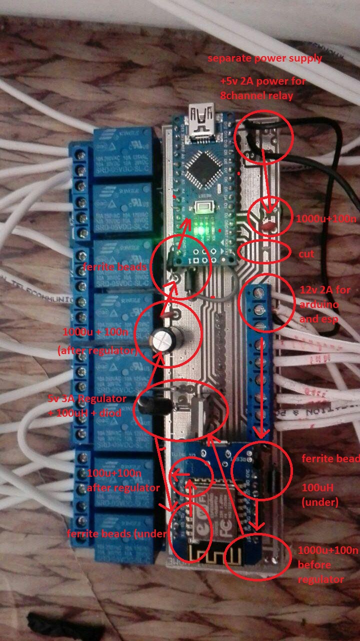

i dont have schematic but this is pic of my board : arduino nano is a PME for esp8266.
i am using some ferrite beads because first i have EMI noise and after some turn on/off ,arduino nano go to freeze. but now i dont have this problem. but after some time when i want use wifi for turn on relay i see dont work. after see network and my devices in network, i see this esp is not between my devices(but other devices are in my network ( other esp , raspberry , my phone and etc) . so i think this is not related to router. esp dont freeze because when i turn off/on router again give ip and work. thing that is see , esp is disconnect for a unknow reason and can not auto connect again(one question: espeasy can auto reconnection after disconnect?)
please help . thank you

The electronics you have are a bit beyond me, but just to be sure, did you also set the ip address reservation in your router?
Have you tried looking at the serial log to see if there is any clue there?
Re: disconnect wifi (please read last post and guidance me)

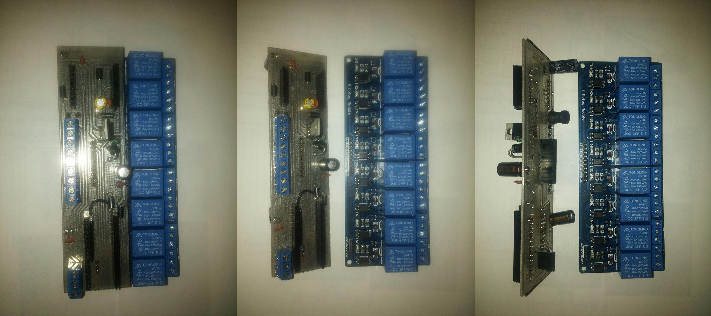

You are using a custom PCB apparently so I'm clueless as in a very similar setup but driving the relays directly from the ESP8266 I've no problem at all, and my ESP8266 is as close as your to relays so I can fairly assume that's not the main issue.
I'm not sure what you mean in the picture as "ferrite beds" and I see general strange test (you wrote 12V 2A as input but all is working 5V as far as I can see).
Last but not least, your are using a single voltage regulator to drive all the electronics and if not genuine with good quality and proper filtering "that" can cause a lot of random issues (by personal experience I had a bunch of 7805s which cannot handle more than 200/300mA without behaving weirdly resetting my ESP8266 every now and then!)

thanks friend for answer.
i have a D1mini that connect to a arduino nano for PME. also i add some pins in arduino for switch. so D2-D8 are for key (and are pullup with 4.7). D9-D10-D11-D12-D14-D15-D16-D17 are for relays. D18 - D19 is for connect to I2C connection with D1 mini . and other pins are free. i have a board (pcb) that this pcb can connect to relay 8channel board with pin header.relay board have "opto" and etc. i am weak in electronic design too. i search and found this devices ( regulator , beads and etc for filtering noise...) and design pcb...
i static ip in my router . i use 12v and 5v regulator for fix V and remove noise.also i use separate power for relays and esp+arduino.
this photo: behavior of board is strange. first lost wifi and ip address after some time(device is not in network watcher and have not ping in cmd...)
"some time" means 1days or 2 days or 1 week ! so i can not monitoring with IDE serial monitor(for example 1 week) !
other strange behavior disconnect connection between arduino and esp(key is work but wifi dont work ( esp is in network and have ip)
i test a experience . i add a device in esp for send system info(RSSI) every 5min to one IDX in domoticz. after happen(lost wifi) i check that IDX. i see every 5min receive a info(RSSI) also now receive !!!!! D1 is not in my network !!!!!! i have not ip and ping is unreachable... but esp is sending info every 5min yet !!!
I'm confused
is that possible this problems related to just that regulator ? if this is fake , so is that possible happen this strange problems ?
