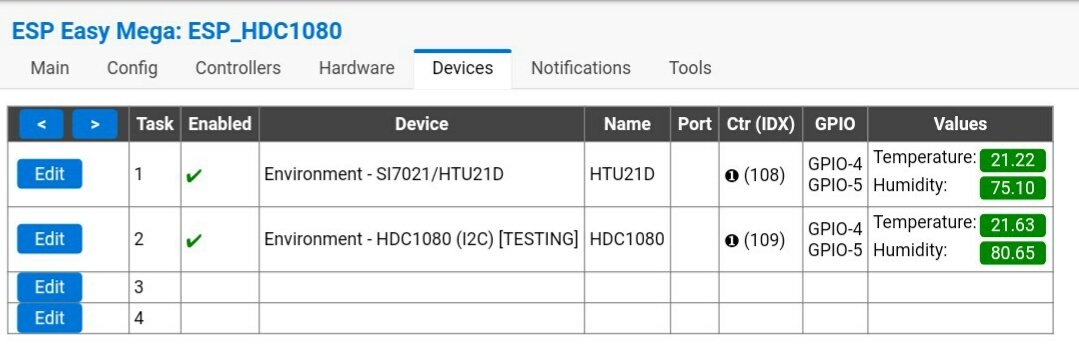

I have just tried to connect two HDC1080 sensors, but the sensor is not showing any value in Domoticz. Other sensors like DHT11, HTU21D are working without any issue. In Config page of ESP Easy there is a value, but it looks like it is not sending it to domoticz... I use the ESPEasy_v2.0.0-dev12_dev_4096 firmware and ESP8266 dev board with 4MB.

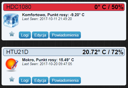

I will send it later, but on the same ESP I have HDU21 and it is working, but the HDC1080 not... I will send later a screen from ESP, here screens from domoticz:
HTU21D+HDC1080 not showing temperature.PNG (43.24 KiB) Viewed 8129 times

The only thing I have to set to send value to domoticz is Domoticz Index of device. I already tried also to change these ID's in EspEASY between other sensor and HDC. The my domoticz was showing other sensor's value as HDC1080, but the real signal from HDC1080 should be shown as the other sensor, but it was also not working. So it do not look like Domoticz problem. I'm afraid, there is an issue with HDC1080 in ESP easy...
