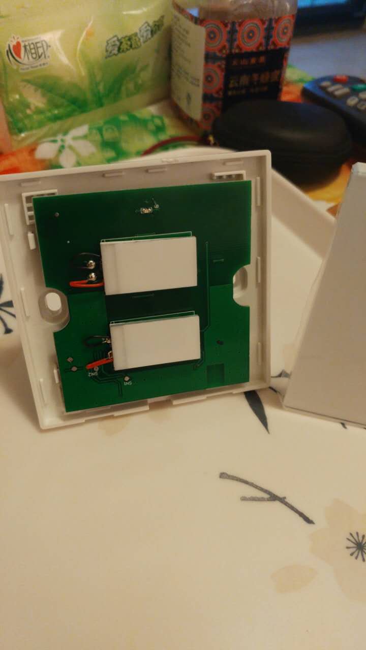

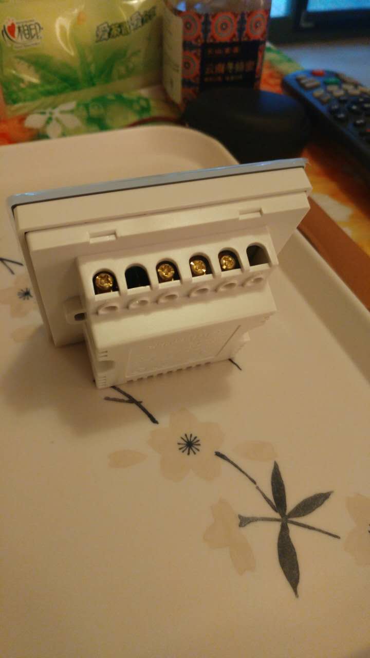

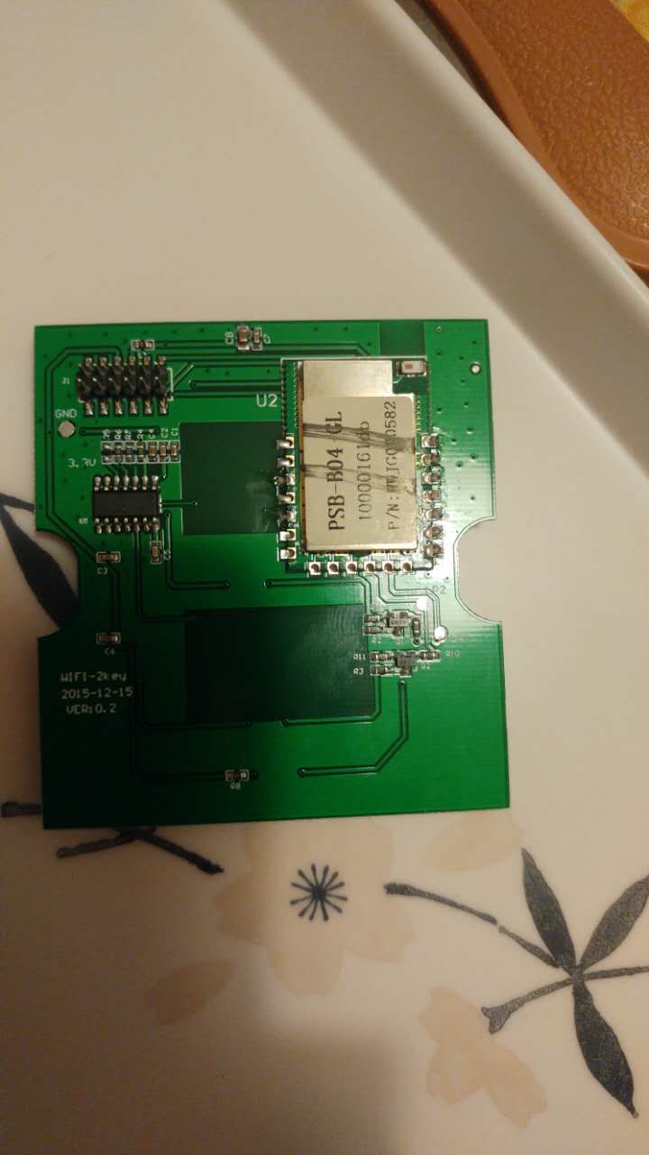

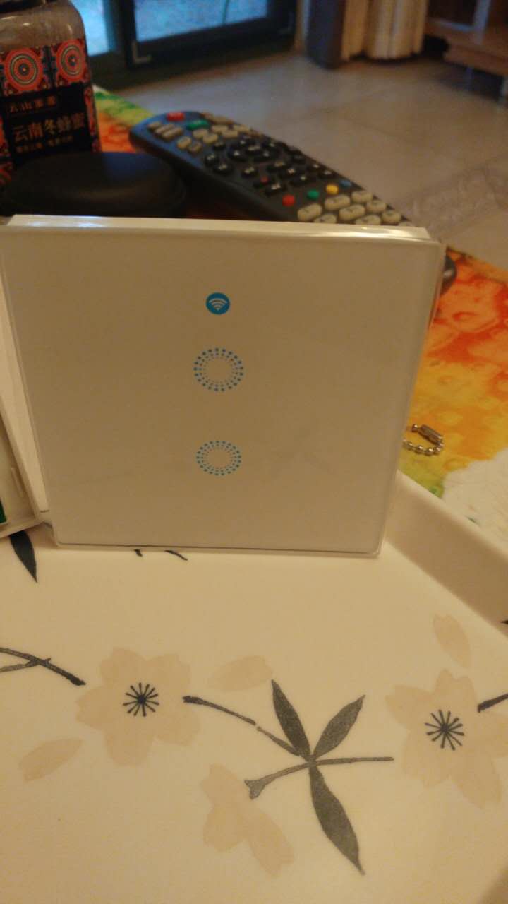

Hi guys,
I just got a new Itead based Wall Switch (SONOFF-Touch look-a-like) based on the PSB-B04-GL. Since it is based on the PSB-B04-GL I was hoping to re-flash with ESPEASY and use it with Domoticz. However I can't find the correct TX/RX and GPIO0 pins. On the Itead wiki page there is some documentation for the module: https://www.itead.cc/psb-04.html
The switch is availlable in 1, 2 and 3 gang versions and different colors. I noticed on AliExpress that the same PSB module is also used in a 4 CH USB power Relay board. I hope someone can help me figure out how to flash this board.

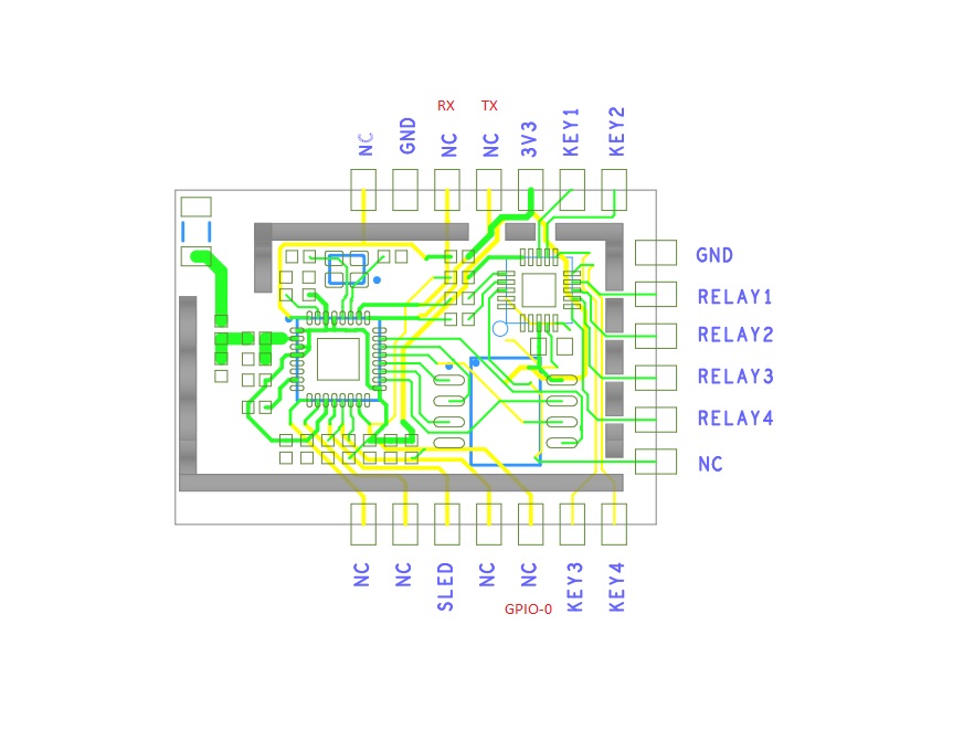

i suppose i have to disappoint you.
The PSB is based on ESP-8266. The little drawing on the page you mentioned shows that TxD and RxD are lead through another chip and not connected to the outside pins.
So it won't be possible to flash ESPEasy on the PSB-circuit. All key and relay connections run through this chip.
Itead does not give much info about the PSB circuit but i think it's the same as with the Sonoff Dual. They use a serial driven port chip to read keys and switch the relays.
As far as i know this is not supported by ESPEasy at this time.
So even if you manage to flash ESPEasy an the PSB it won't work.
Sadly i can't give a better news, sorry.

Thank you Shardan for the reply.
I was looking at that little picture myself and was wondering what they were doing with the "other chip'.
Too bad. Guess I have to start making space in my walls to fit multiple SonOFF Touch (single gang), or hope they will make their own version.

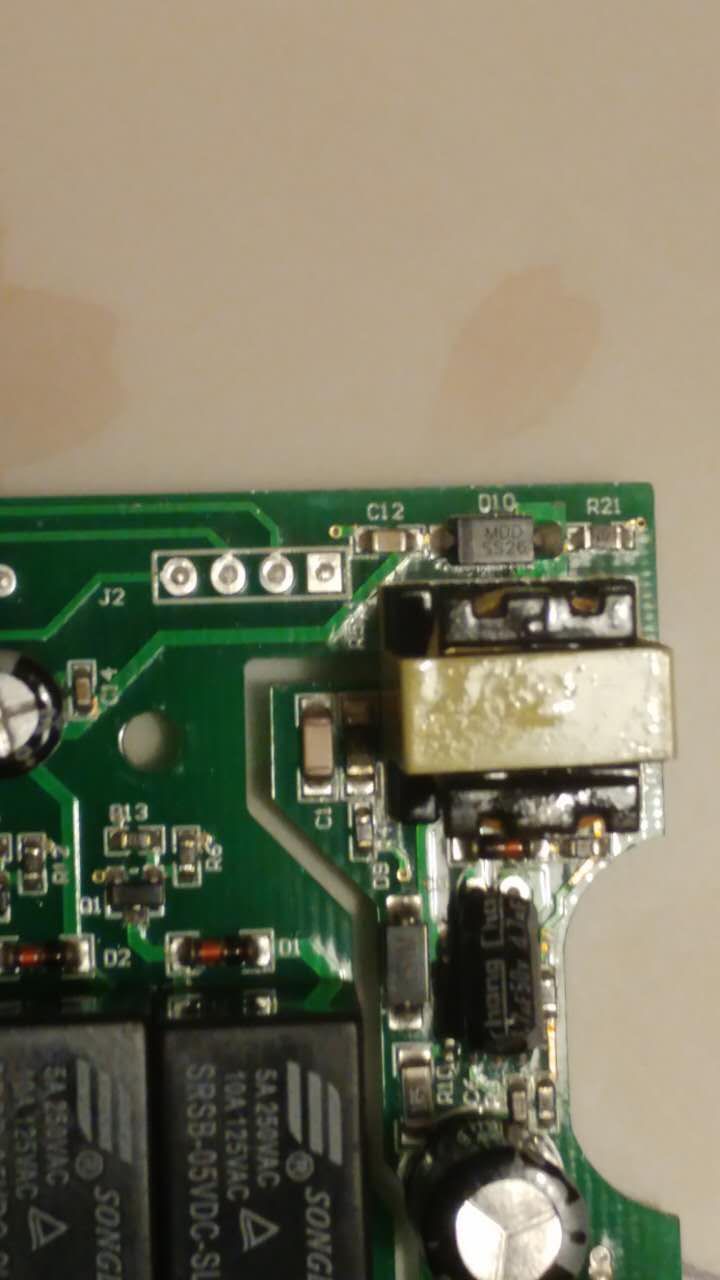

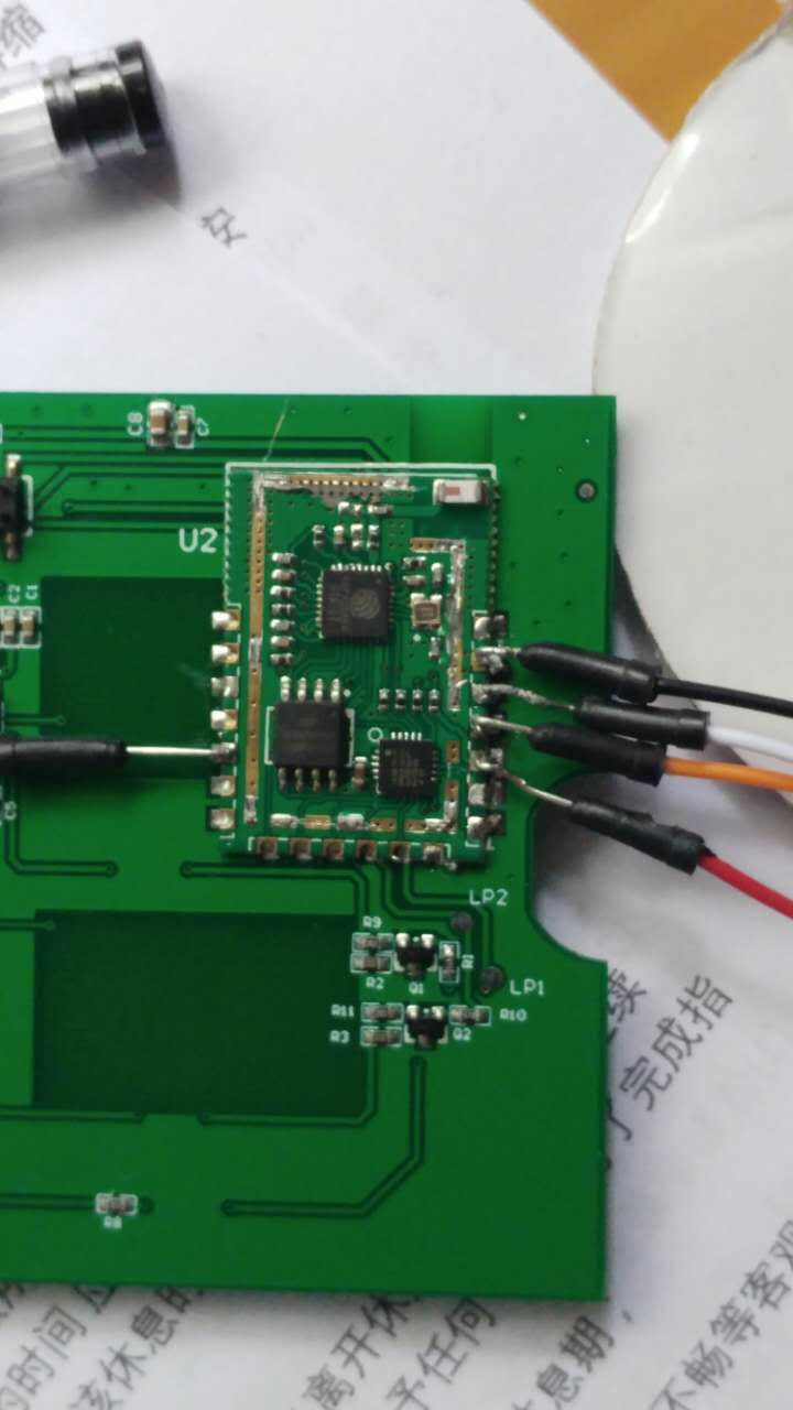

I am glad I don't take "NO" as an answer
I managed to flash the devices with firmware called "ESPurna" from Tinkerman. (http://tinkerman.cat/tag/espurna/)
Its basically the SonOFF Dual as suggested (support chip is SIL F330). I realise its not ESPEASY so I will not continue this topic but I wanted to share this anyway.
I removed the cover to get a better look on the inside, this is not required to flash.

I am not sure if it will fit in the round European wall sockets. These switches were designed for China. They have square holes. Most switches I saw for the EU market have a different form factor. They are round in the back, which means redesigned pcb most of the time.
It's all based on this:
https://www.itead.cc/wiki/PSB_Smart_Switch_Module
The espurna firmware (last I checked) only uses 2 pins, cause it was designed for the sonoff dual. The sketch is easy to read and modify to add the other pins / switches / relays.

I actually a have few other wifi switch that are also ESP8285 based (using PSFB85 https://www.itead.cc/psf-b85.html)
https://goo.gl/photos/xzGnCyVKFUs284H89
https://goo.gl/photos/Q7zgtRbWN1BeszJw8
Those work right away after I flashed sonoff 4ch of the espurna firmware.
But it's not really working properly with this tantech
I think the newer Sonoff T1 might be using the PSFB85 chipset
Re: New Itead based Wall Switch
PCB tracks for AC are ridiculous on those units you just posted pictures; I won't install them in my house!!
My philosophy si different and my system is designed to work differently, surely it requires more rewiring and is more exepnsive but I truly believe is safer.
I'll post some pictures / info as beside the hardware (which is custom made) I am working to have all nodes rurring ESPEasy!

Sonoff Touch T1 is based on the same PSF-B04 chip so to get into flash mode you have to ground GPIO0 as usual. I successfully uploaded Tasmota firmware into 2 gang version of T1.
If you use +/-10watt led lights, you're talking about 0.05Ampspapperone wrote: ↑11 Jul 2017, 07:21 PCB tracks for AC are ridiculous on those units you just posted pictures; I won't install them in my house!!
A 0.2mm tick cable can handle that amperage, looks safe to me.
Of course if one is using higher power lamps, then that's a different story
Even those 0,05A circuits might produce a short circuit.
