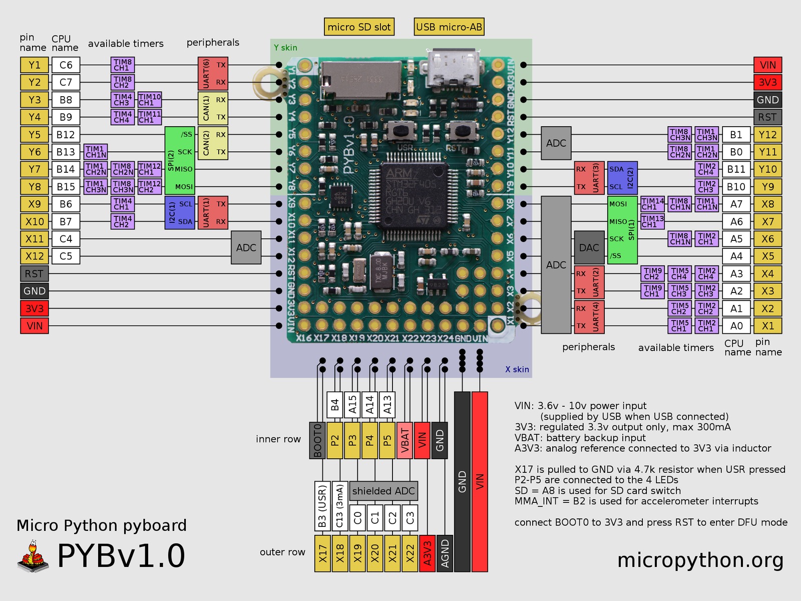

The CAN bus is supported to: https://en.wikipedia.org/wiki/CAN_bus
As well as the I2S bus: https://en.wikipedia.org/wiki/I%C2%B2S
Together with I2C, SPI, UART are there plenty of (hardware based) communication protocols available, although some of the protocols might not be available as hardware but as software implementation (and therefor speed limited) in the lower end soc's:
