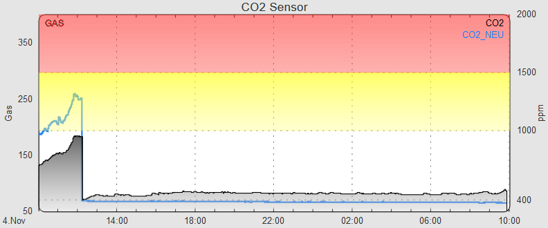

I got two MH-Z19 with the latest ESPEasy version running side by side.
One sensor is the "old" version, the other the "new".
Comparing both measurements show that the new version has a significant higher value than the old one. (see attachment)
What may be the cause for the offset and scaling difference and which senor shows the correct values?

Most likely, the sensor with the lowest value has had Auto Baseline Calibration (ABC) enabled, which is the default.
If you're running dev-12, I would suggest to disable ABC as soon as possible (within 24h of operation after first usage)
Then you keep the factory calibration active.
In short, ABC does remember the lowest recorded value in the last 24h and then uses that as new 400 ppm baseline.
You can 'restore' the old sensor by leaving ABC enabled (default value in ESP easy dev-12) and during the day do a lot of ventilation in that room. Then it will restore to a correct baseline. Only thing is, in a city you will probably never reach 400ppm, but something around 600-700 ppm.
Thus performing a baseline calibration in such atmosphere will lower the displayed values by about 200 - 300 ppm. (700ppm will then be considered as 400)
That difference will increase for higher concentrations of CO2.

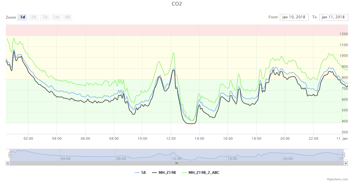

The ABC of the MH-Z19 is pretty weak. Only taking the last 24 hours into account. The S8 and it's siblings have a 3 week sampling period and only adjust a possible offset with a fraction of the difference. This makes it less influenced if it is used residential (i.e. people occupying the house more on weekends compared to offices etc.).

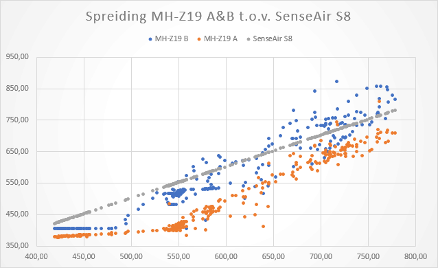

After 30 minutes inside the house, both sensors start to settle.
The Version B at 832 ppm, the old Version at 615 ppm.
OUCH!
I wonder if they did care a lot (or better... at all) calibrating the SCALE correctly at production?
OUCH!

Re: MH-Z19 offset and scale differences!?
It is remarkably cheap to create some specified CO2 conditions using chemicals. (given you do it for batches of sensors at once)
But the problem being faced here is that the MH-Z19 sensor's baseline calibration will be affected by several parameters like temperature and humidity.
Also the automatic base calibration seems to update only partially. It takes several days to reach the same level as the new sensor.
You can run the manual set base calibration command in ESPeasy at the moment the sensor value is at its lowest point. (e.g. good ventilation, without people/animals present)
That will set the current value to resemble 400 ppm. But please make sure you do not re-run that command within a short interval (e.g. within several seconds) or else you will reset the 0 ppm point.

Here is my tests of 4 sensors:
MH-Z19B (named with ABC)
MH-Z19B with ABC turned off
MH-Z19 (named with ABC)
MH-Z19 with ABC turned off (I know that there is nothing about ABC in MH-Z19 datasheet, but I've tried to turn it off)
All 4 sesnosrs installed on one breadboard (and its about 2cm between each of them). All powered from the same source. All transmitting data with similar Wemos D1 mini.
Tests performed for 2 weeks (MH-Z19B datasheet says that ABC period is 1 day)
Some thoughts:
1) ABC does nothing in my environment (living room). Completely no difference for MH-Z19B with ABC and without ABC.
2) MH-Z19 always shows less PPM than MH-Z19B. Sometimes difference is very big (about 400-500ppm).
3) ABC (MH-Z19B only):
When ABC is turned on, "U" continuously increases from 0 to about 37 000 when its self-calibrating (24h ABC period).
When ABC is turned of, "U" always 0.
4) Internal temperature difference between MH-Z19 and "B" is about 6 degrees (Celsius). MH-19B heats more because of higher measurement frequency (in about 2 times as I can see on red blinking)
5) Boards with MH-Z19B has some problems with stability. They restarts in maximum 30 minutes (usually uptime is only 4-5 minutes). Boards with MH-Z19 does not have this problem and uptime is few days. With S8 I'll try to replace all boards to see if this helps. And I'll try to configure Syslog server to investigate this.
Sensair S8 arrives in few days. I'll replace one of MH-Z19 with it and continue testing.
BTW, does anyone knows, is it possible to connect multiple CO2 sensors to the one Wemos?
- co2.png (76.42 KiB) Viewed 57443 times

Can you also write down what color in the graph what sensor is?batal131 wrote: ↑05 Jan 2018, 09:20 [...]
Some thoughts:
About your last question. You can only add more than one when using different pins.
The MHZ19 plugin uses the SoftSerial code, which allows multiple instances to be used.
In the last Mega code, I changed it to max. 3 simultaneous instances on the same device. Because you simply do not have more pins to use Rx and Tx on an ESP8266 and it will reduce the amount of cache ram used. (which is really sparse)
Also make sure your power supply is sufficient. These sensors may peak during a measurement. If all sensors peak at the same time, the voltage may drop due to resistance in the power cables, or even because the power supply may not deliver.
One sensor may peak up to 150 mA if I'm correct. So 4 sensors may peak up to 600 mA.
Also these sensors really should run on 5V, not 3.3V.
I have several of these sensors here and they almost never reset themselves.
Perhaps you should add some capacitors over the Vcc lines of the sensors.
If the sensor reboots, it may affect the ABC functionality.
The U value is believed to reflect the raw internal value reflecting the lowest concentration recorded in the last 24h. The sensor will consider this then as the new 400 ppm point.
So if you did not ventilate enough, the lowest recorded concentration may actually be way above 400 ppm and thus the displayed value will be too low and may show hours of 400 ppm recorded values.
Do you also have the values stored in some kind of CSV? Then you can create a scatter plot in Excel.
I did this for S8, MHZ19A and MHz19B (only very short interval of 22 hours):
Horizontal axis shows the ppm values of the S8 sensor (considered to be the "truth", since I just opened the package of the sensor and it had still factory calibration)
Vertical is the concentration of all 3 sensors at the same time.
So then you can see if the sensors agree (for example the S8 agrees very well with itself
If one may react faster or slower, the average should still be the same.
One not to myself; I may have swapped the data from the A and the B sensor, since the A never gets below 400 ppm and the B version may give a bit lower values.

Implemented scatter
ppm reported every 1 minute. For graph grouped by 5 minutes. Data for last day (after 5 days of running)
And basic chart (same data)
average difference for MH-Z19B without ABC is only 41 ppm! For ABC version is 95 ppm (and its increasing each day, damn 1 day calibration)
That looks quite nice, the scatter plot.
So if you're running for a while, the version with ABC should show some drift and thus a wider band?
Also interesting to "swap" the data by placing other sensors on the X-axis.
