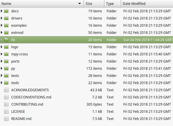

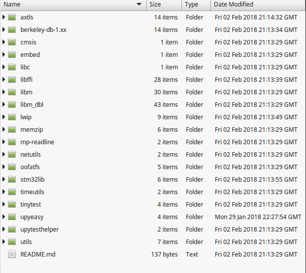

Sorry to trouble you, but I must be missing something basic here. I'm on Linux Mint. I've put micropython from the repository in my home directory, and to correspond with yours I made the filename wtih a dot so its 'hidden'.
Then I added a folder "upyeasy" in ~/.micropython/lib, and copied everything from the uPyEasy repository, so I have sub-folders docs, modules, and src which are all populated. But when I try to run "micropython -m upyeasy" (in terminal, in directory _/.micropython/lib/upyeasy) I just get "micropython: command not found".
My directory tree in _/.micropython looks like:

Answering my own question, after some more Googling... :oops:
Unix port of Micropython - setup on Linux Mint.
The penny finally dropped, the syntax I needed was " ./micropython " (i.e. run micropython). But first, I needed to "make" the micropython system. I found some instructions here...
https://github.com/micropython/micropyt ... d-variants. This may help anyone else who wants to add modules to uPyEasy.
Next little challenge is to get it to import modules from the upyeasy subdirectories. I'm currently playing with PYTHONPATH environment variable and putting entries into my ~/.bashrc file - does anyone know a better way?
Andrew

AndrewJ wrote: 04 Feb 2018, 20:05 Answering my own question, after some more Googling... :oops:
Andrew
micropython
>>> import upip
>>> upip.install('micropython-os')
>>> upip.install('micropython-machine')
All installed library through upip are default located in ~/.micropython/lib
Copy the entire uPyEasy source tree in the same lib directory like: ~/.micropython/lib/upyeasy
If uPyEasy complains about a missing library during startup: micropython -m upyeasy
then install this library using >>> upip.install('micropython-XXX')
where XXX is the name of the library.
