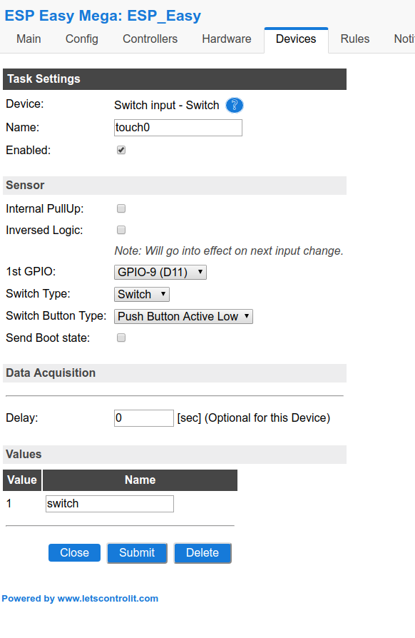

I've created two tasks, touch0 and touch1, where I've assigned the according pins as input (see screenshots). My ruleset is looking like this

Although it seems pretty stright forward to me, I have the problem, that both switches switch also the other relay, where they are not assigned to. Most of the time it does not happen with the same trigger event but with the next one. So if touch 1 turns on relay 1, the next touch will turn relay 1 off, but relay 2 on. Similar happens, when I instead press the second touch button. It'd be awesome, if someone has an idea, whats going wrong here. Thanks!

I've tried renaming variables and using the pullup resistors. Unfortunately this didn't help. I removed now the rule for the second push button. The strange behavior continues nevertheless: No matter which button I press, the pin specified in the rule to be switched reacts to pressing both buttons.
