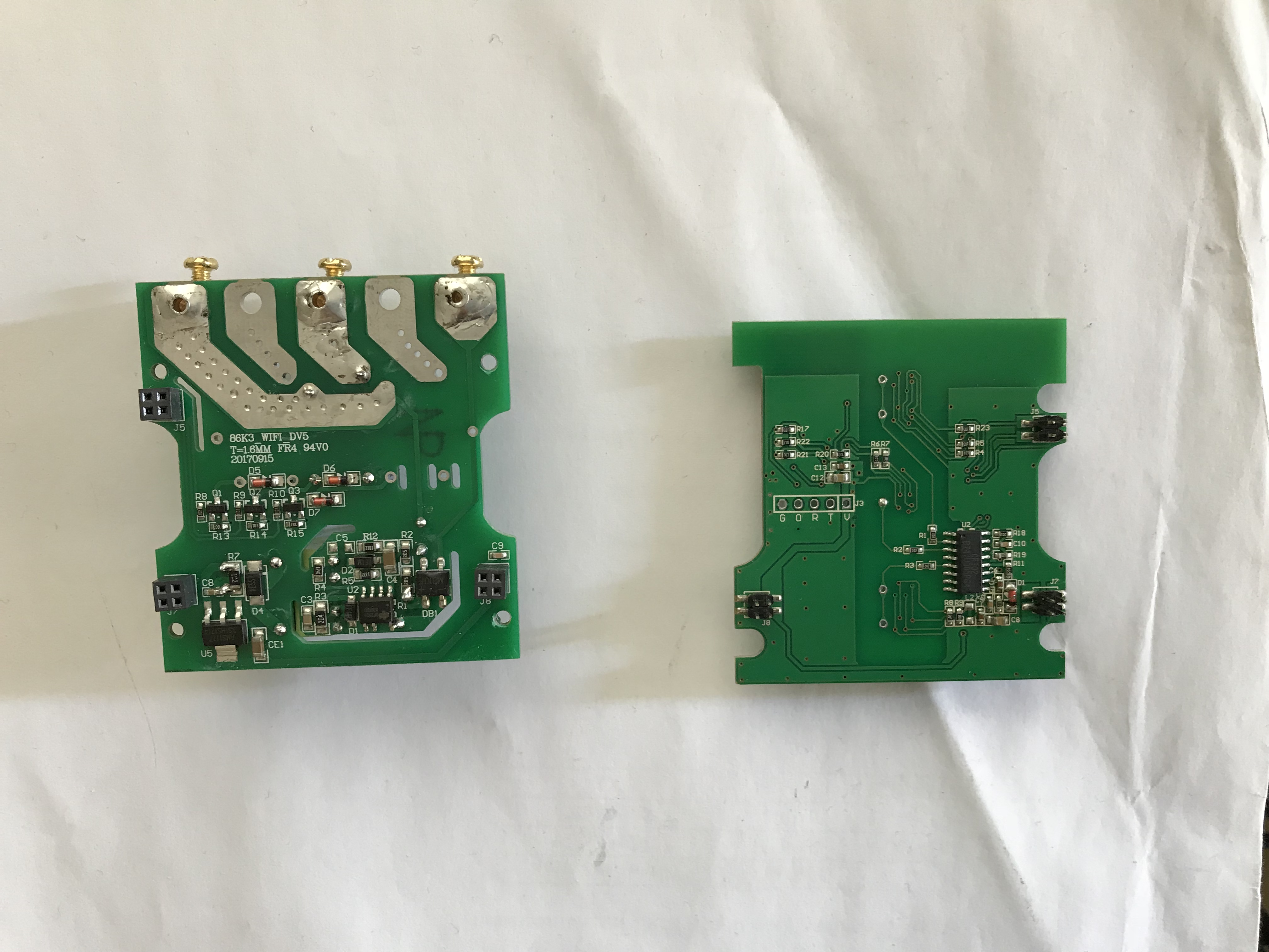

Well, from what I've seen it's a V2 not R2. Compiled the binary into Dev 11, no luck. Will try out SER2NET in the next couple of days. Thanks!
saundersrg
Posts: 5
Joined: 13 Dec 2017, 10:18
Re: Serial MCU controlled relay/switch
#52 Post by saundersrg » 16 Dec 2017, 06:37
grovkillen wrote: 13 Dec 2017, 13:34
If you take a picture of the board we might see if the ESP MCU is doing the actual pulling of the relay or if they (itead) has started to put in a middle hand MCU which is controlled via the ESP MCU.
EDIT: sorry, I see that it is in fact discussed in this thread. It i a serial controlled MCU. So how are you trying to make the relay trigger? Using serial commands?
Not able to trigger at all, it's like the relays are disconnected entirely. Have tried 3 different firmwares and none work.
Will try the suggestion of SER2NET and see what I can get.
SER2NET sadly returns absolutely nothing. The LED changes on the unit when closing button 0 / 1 jumpers, but the relays themselves don't seem to fire.

saundersrg wrote: 16 Dec 2017, 07:39 SER2NET sadly returns absolutely nothing. The LED changes on the unit when closing button 0 / 1 jumpers, but the relays themselves don't seem to fire.
If the relay do not fire when you physically close button jumpers, i think it is simply a faulty one. :(
Was it worked with the original firmware? I always try every Sonoff that i get with the original firmware, before i flash it. Can you post pictures from the panel (back&front)?

In a sad twist, the dual was the only one that I a) didn't test beforehand and b) didn't dump the original firmware beforehand.
I will perhaps fiddle again sometime, for now it's been packed in a box.
Images here:
Chips to right of ESP8266EX are as follows from what I can see.
XTX
BN25F08
1(?)644Q0R
SIL
F330
B0GAZ
1624+

I have recently purchased a Tuya clone 1-gang wall switch from aliexpress. I like them since they don’t have any branding in the glass pane like sonoff and their glass cover color matches the case color.
I’ve disassembled the switch, luckily I saw the pins out there with labels on the back.
I am quite new to these things and don’t have any electronics background but have some programming knowledge. I had previously flashed sonoff devices with tasmota with success and have embedded them into my home assistant network running on a raspberry pi 3. On the other hand, I have tried to use your firmware but to no luck. I have listed the steps I have followed below. I will be glad if you can help me figure out how to make it work with the device I have.
1) I connected the ESP8266 module to a raspberry pi 3 running on raspbian in flashing mode. I don’t have a USB-UART device, so I am limited to using linux based solutions for flashing
2) I downloaded the compiled version of your plugin for Tuya
3) I backed up the existing firmware using esptool.py (just in case I need to revert to the original firmware in the future)
4) power cycled, erased the existing firmware
5) power cycled, uploaded the new firmware, namely ESPEasy_Mega_P165_4M_1MS.bin from the zip file in the first post.
6) exited flashing mode (disconnected GPIO0 from ground) and power cycled
7) I was now able to see ESP_XXXX access point available in the wireless networks list. However, when I connected, I was unable to open the webpage on 192.168.4.1. I tried to ping and it worked, but the webpage did not show up
8) Still connected to raspberry pi, I ran miniterm.py to listen to the serial log. See the log output below. Seems like ESP was constantly rebooting itself due to an error (which I cannot figure out) and repeats the same error message continously.
9) I also tested powering the switch from a wall plug instead of raspberry pi, but the results were the same/
Any ideas how I can make this work? Is there something that I am missing?

This Kinco switch seems very interesting, on the Yewelink the main button works all the time, because that was hardwired to the MCU. Are you sure, that this switch communicates serially with an MCU?
If it is, you can try to enable all 3 button in the Serial MCU settings, then do a soft reboot and see if anything shows in log when you press the main button. And also see if relay,0,1 or relay,1,1 commands doing anything with the relay.
FYI there are some Tuya clone which does not use the serial API, instead using direct GPIO-s: (in this case buttons are controlled by the ESP and you have to code some logic (Rules) in the same way like the Sonoff Touch)
such as GPIO-12=RELAY,GPIO-5=PWR LED

I have managed to figure out that the Kinco switch uses the GPIO pin 4 to manage the relay.
I can turn it on and off using the commands but I am struggling with operating the physical button still. My initial idea was that it would be linked to one of the GPIO pins and I would be able to program a trigger that switches GPIO4 when the button is pressed.
I am checking the values of all GPIO pins and then pressing the button and then checking again. However, I don’t see any change in GPIO values.
Any thoughts how I can capture the physical button press?

I only see 4 gpio's on the picture. Can be GPIO12-GPIO13-GPIO14?
When you said "GPIO pin 4" you referring GPIO-4 as the picture below?
Perhaps you can trace back the GPIO's from ESP to the touch with a multimeter...
Also there is a CR302..whatever chip with 16 legs on the back side i can not read every letter from the picture, maybe the central K2 touch is connected to it's R2?? Could you find out what's this chip full name?

#94 Post by dent » 13 Mar 2018, 22:00
enesbcs wrote: 13 Mar 2018, 21:33
dent wrote: 13 Mar 2018, 21:00 I did the following
but can't see anything in the log when I press the button. any other thoughts?
it says:
CR302
B747U005PG4
nothing pops out in google when I search for it

#95 Post by enesbcs » 13 Mar 2018, 22:37
dent wrote: 13 Mar 2018, 22:00 it says:
CR302
B747U005PG4
It's a bit confusing, if the touch sensors not wired to ESP, than maybe it's some sort of touch controller (CR302) which is wired to ESP8266 serial/I2C/SPI i can not tell it from pictures. :(
I used the multimeter continuity function to backtrace wiring, more or less success. :) Multiple layered PCB's are hard to backtrace.

I used a multimeter to measure the changes in voltage on my kinco touch switch and figured out that the voltage on the serial pin market with R changes (goes down to 0 depending on how long I press) when I touch the physical button. I guess now I have to figure out how to read serial pin values. I am quite new to the esp easy firmware, please forgive me if this is something trivial.

dent wrote: 14 Mar 2018, 23:42 I used a multimeter to measure the changes in voltage on my kinco touch switch and figured out that the voltage on the serial pin market with R changes (goes down to 0 depending on how long I press) when I touch the physical button. I guess now I have to figure out how to read serial pin values. I am quite new to the esp easy firmware, please forgive me if this is something trivial.
Nice work, you are in the right direction.
Easy and ugly way if you have only one button on the Kinco:
In ESPEasy menu:
Tools->Advanced->Enable serial port (check box unticked - so disable!)
Tools->Advanced->Serial log level: None
Now you are able to create a Switch device on RX it's GPIO3, and see if it changes state in the log.
The harder way:
- Enable serial port usage, but disable serial logging, also disable all plugin (P165) and device that using serial pins.
- Setup "Communication - Serial Server" plugin for debugging (port 23, baud 9600, 8n1)
https://www.letscontrolit.com/wiki/index.php/Ser2Net
- install Realterm to your PC, setup for displaying in hexadecimal in Display menu, in Capture write the ESP device IP address and port (23) and set the serial settings that matches with the ESP Ser2Net plugin
In that way when you press the touch, you have to see the same Hex byte array - maybe two different: one when switching off, another when switching on. If you see only garbage or not the same numbers every time, you have to change bitrate on each of them and retry. If you can provide the correct hex array i can include in this plugin. :)

I tried your suggestions and I am now able to command the switch and the leds on it trough GPIO commands. I set some rules, installed mqtt and now I am able to control the whole thing both physically and wireless.
I have also tried the 'hard way'. The hex output I see is "00" almost all the time when I press or hold the button. Is this normal or is "00" an error of some sort?
I have also purchased 2 and 3 gang versions and waiting for their delivery. I will let you know when I get them and try to find out their hex outputs.
