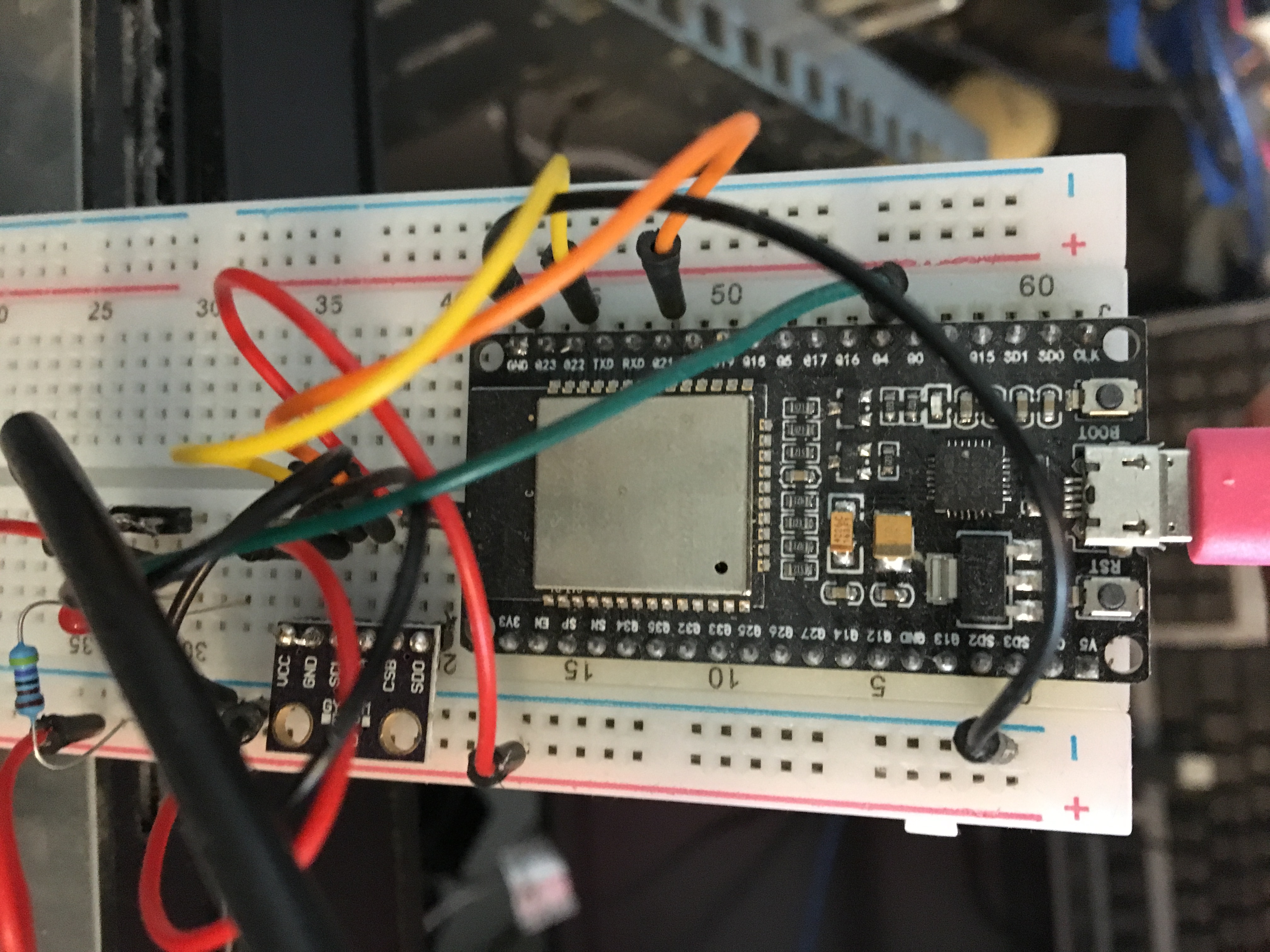

I've my working setup attached. I'm using this one: https://www.aliexpress.com/item/Officia ... 21054.html
Can you post a picture of your setup and a link to where you bought it?
I have also these in stock:
https://www.aliexpress.com/item/ESP32-B ... 25963.html (didn't work so far)
https://www.aliexpress.com/item/LOLIN32 ... 682537.htm (it has 4MB of PsRam and is really different)
https://www.aliexpress.com/item/ESP-32S ... 38946.html (not soldered yet)
Please also try this (non-upyeasy) firmware: http://micropython.org/download#esp32 to see if it's something in uPyEasy ESP32 firmware or if it's the ESP32 board itself.
There seems to be a lot of different ESP32 board going around, which are all different..
Cheers,
Lisa

- IMG_4103.JPG (2.18 MiB) Viewed 134533 times

This is the sequence with the 2048 bin.
rst:0x1 (POWERON_RESET),boot:0x3f (SPI_FAST_FLASH_BOOT)
configsip: 0, SPIWP:0xee
mode:DIO, clock div:2
load:0x3fff0018,len:4
load:0x3fff001c,len:4364
load:0x40078000,len:0
load:0x40078000,len:10992
entry 0x4007a6c4
I (442) cpu_start: Pro cpu up.
I (442) cpu_start: Single core mode
I (443) heap_init: Initializing. RAM available for dynamic allocation:
I (446) heap_init: At 3FFAE6E0 len 00001920 (6 KiB): DRAM
I (452) heap_init: At 3FFDCDD0 len 00003230 (12 KiB): DRAM
I (458) heap_init: At 3FFE0440 len 00003BC0 (14 KiB): D/IRAM
I (464) heap_init: At 3FFE4350 len 0001BCB0 (111 KiB): D/IRAM
I (471) heap_init: At 4009005C len 0000FFA4 (63 KiB): IRAM
I (477) cpu_start: Pro cpu start user code
I (47) cpu_start: Starting scheduler on PRO CPU.
OSError: [Errno 2] ENOENT
MicroPython v1.9.3-255-g979c688-dirty on 2018-03-21; ESP32 module with ESP32
Type "help()" for more information.
>>> import upyeasy
I (19590) modsocket: Initializing
>>> ets Jun 8 2016 00:22:57
flash read err, 1000
ets_main.c 371
rst:0x10 (RTCWDT_RTC_RESET),boot:0x3f (SPI_FAST_FLASH_BOOT)
entry 0x4007a6c4
I (465) heap_init: At 3FFE4350 len 0001BCB0 (111 KiB): D/IRAM
I (48) cpu_start: Starting scheduler on PRO CPU.
>>> import upyeasy
I (86063) modsocket: Initializing
>>> import network
>>> station = network.WLAN(network.STA_IF)
File "<stdin>", line 1
IndentationError: unexpected indent
I (149973) wifi: wifi firmware version: 111e74d
I (149973) wifi: config NVS flash: enabled
I (149973) wifi: config nano formating: disabled
I (149973) system_api: Base MAC address is not set, read default base MAC addres s from BLK0 of EFUSE
I (149983) system_api: Base MAC address is not set, read default base MAC addres s from BLK0 of EFUSE
I (150003) wifi: Init dynamic tx buffer num: 32
I (150003) wifi: Init data frame dynamic rx buffer num: 64
I (150003) wifi: Init management frame dynamic rx buffer num: 64
I (150013) wifi: wifi driver task: 3ffe15f4, prio:23, stack:4096
I (150023) wifi: Init static rx buffer num: 10
I (150023) wifi: Init dynamic rx buffer num: 0
I (150023) wifi: Init rx ampdu len mblock:7
I (150033) wifi: Init lldesc rx ampdu entry mblock:4
I (150033) wifi: wifi power manager task: 0x3ffe8508 prio: 21 stack: 2560
W (150043) phy_init: failed to load RF calibration data (0x1102), falling back t o full calibration
I (150203) phy: phy_version: 362.0, 61e8d92, Sep 8 2017, 18:48:11, 0, 2
I (150213) wifi: mode : null
>>> station.active(True)
I (166333) wifi: mode : sta (30:ae:a4:22:e8:1c)
I (166333) wifi: STA_START
True
>>> station.connect("xxxxx", "xxxxxx"
>>> I (207423) wifi: n:7 1, o:1 0, ap:255 255, sta:7 1, prof:1
I (207983) wifi: state: init -> auth (b0)
I (207983) wifi: state: auth -> assoc (0)
I (207993) wifi: state: assoc -> run (10)
I (208003) wifi: connected with Spoon, channel 7
I (208003) network: event 4
I (208673) event: sta ip: xxxxxxxxx, mask: xxxxx, gw: xxxxxxx
I (208673) network: GOT_IP
I (210993) wifi: pm start, type:0
print('network config:', station.ifconfig())
network config: (xxxxxxxx', 'xxxxxxxxx', 'xxxxxxxx', 'xxxxxxxxxxx')
>>> station.isconnected()
True
>>> upyeasy.main()

Re: ESP32 boards
@bertb: and now a reboot and only do:
>>> import upyeasy
>>> upyeasy.main()
Still a network not found error?
Ps. Thx! line 46 of utils.py had a bug! It stated
But it should have been:
Found it due to the micropython error trail!
>>> import upyeasy
>>> upyeasy.main()
db.configTable.update({"timestamp":network['timestamp']},port = wport)
db.configTable.update({"timestamp":config['timestamp']},port = wport)

having said that, There still is no automatic update of the devices and no value is written to Domoticz.
Re: ESP32 boards
hi,
have tried it with both files, both sShow the same issues... still not running...
I don't know what to do with BertB's findings... I would love to see a working .bin
regards
karl
