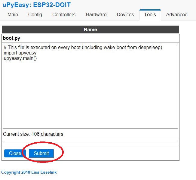

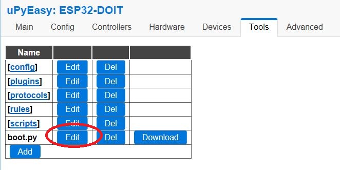

Re: ESP32 boards
I also decided to give uPyEasy a try on one of my ESP32 modules. Using a Wemos Lolin32 Lite module.
Install was quite easy:
I was able to read the connected DS18B20 sensor. So far so good.
But after reboot, it does not start automatically. It is mentioned to put the startup commands in boot.py.
But how? Pressing the edit button in the webgui does nothing.
esptool.py --port COM3 erase_flash
esptool.py --port COM3 write_flash --compress 0x1000 upyeasy_v021_20180321_test_esp32_4096.bin
import upyeasy
upyeasy.main()
upyeasy.setwifi('xxx', 'yyy')

Figured out how:
created boot.py on desktop, then:
But there might be an easier way?
ampy --port COM3 put boot.py

PLEASE note that due to an header bug the file edit only works with the firmware release 20180325 and higher (put in the releases section a few minutes ago)Martinus wrote: ↑25 Mar 2018, 14:24 Figured out how:
But there might be an easier way?Code: Select all
when flashing,the filesystem with your config files will not be deleted, so no need to redo config!
The easy way:
Select tools menu, filessystem/files: klik on boot.py's edit button: Add the two lines into the text field: Click on the submit button: done!

Yeah, I have a running esp32!!!!!
Here are the steps that got my esp32 up and running:
press RST button before plugging in usb
Cmd window:
esptool.py --port COM4 erase_flash
esp32>esptool.py --port COM4 write_flash --compress 0x1000 upyeasy_v021_20180325_test_esp32_4096.bin
putty:
import upyeasy
upyeasy.main()
Thanks to all and Special thanks to Lisa!!!!!!
regards
Karl
