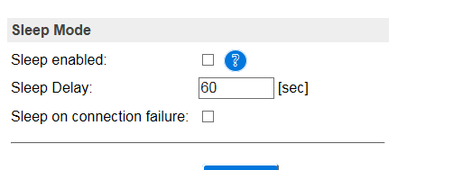

wow. I have found this in the forum:
but I only have this: I need to check why. I will be driving all the day (while some other will be hunting
I will check tomorrow what went wrong, but I wil not be at home so I will not be able to test.
I may have a version issue. I run v2.0-20180126 compiled with the FEATURE_ADC_VCC to get the battery level.
Gilles
Gilles

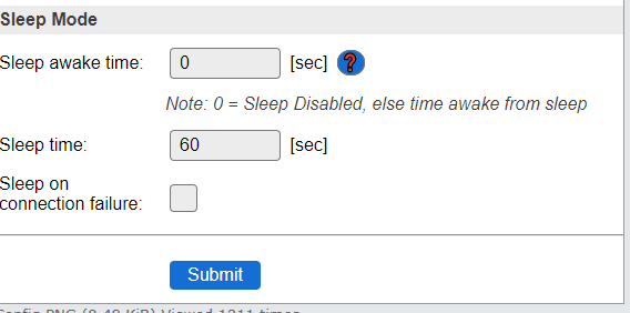

Re: Paper-mail with email project
the png has disappeared. Here is what I have:
Yes, the problem is that you're running an "ancient" version.
We really need to stress that you should always provide what version you're using.
