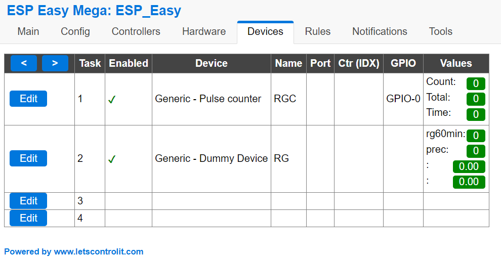

I have 3d printed a simple rain gauge, who is connected to one ESP8266 with ESP Easy Mega.
This simply cont every time the rain gauge shift the position. (for now i simply count the shift at the end i transform this in mm/m2 of rain)
This is my situation:
For send this data to wu (weather underground) every 5 minutes i need:
rg60min - [rain inches over the past hour)] -- the accumulated rainfall in the past 60 min
Total - [rain inches so far today in local time]
- Total, thi is not a problem I think the Total value in Generic - Pulse counter RGC do this hob)
- rg60min, this is the problem, I use the formula (see below) but this is not correct in my opinion, in my formula i reset the counter every hour, i need a costant value of rainfall in the past 60 min.

I think i have find the solution for the 60min rainfall, but tonight i have to make some test if it's possible to do this. I try to create 3 dummy device each with 4 variables. Than i make role who switch the variabes (the value of the 12 in 11, the 11 in 10, 10 in 9 ecc...) and at the end store the last value in the last variable... At the and i make a addition of this i have my value. I think can works.
