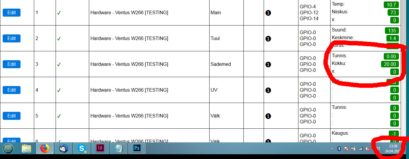

ive been using it now for 2-3 weeks and i have to admit there might be a bug.
in espeasy:
Plugin function:
Value 1: Rain in mm per hour
Value 2: Total rain in mm
Value 3: not used
rain per hour stays stabile 0 all the time and displayunit shows not per hour but "per day", "weekly" and "total"... how is possible that espeasy should show per hour at all?

@osoon I wrote, and tested, my plugin for Domoticz. Domoticz expects the rain per hour in mm value: https://www.domoticz.com/wiki/Domoticz_ ... L%27s#Rain

It shows the current rain in mm/hr. So it refreshes every 5 minutes or so. If you want to know the rain in the last hour you can use the total rain counter.

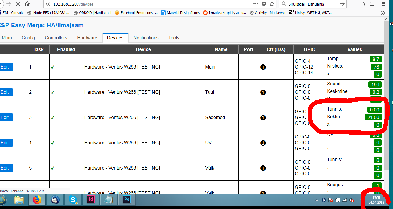

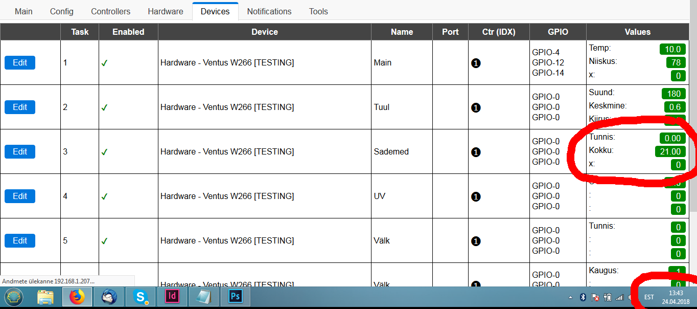

please take a look. its raining outside here right now.
13.39
13.43
13.51
and homeassistant shows 13.51 that rain per hour was last updated 2 hours ago, its time when i restarted it.
i cant see any updates every 5 minutes....
any comments?
