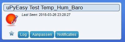

#261 Post by BertB » 26 Mar 2018, 23:34
Update:
The Dallas show up correctly in Domoticz.
The BME has two devices in Domoticz, one for temp and one for weather.
Neither one sohwas values, but 'last seen' is correct.
LisaM
Posts: 513
Joined: 11 Apr 2017, 18:29
Re: ESP32 boards
#262 Post by LisaM » 27 Mar 2018, 00:07
BertB wrote: 26 Mar 2018, 23:34 Update:
BME should be one device:
1244 VirtualSwitches 1452C 1 uPyEasy Test Temp_Hum_Baro Temp + Humidity + Baro THB1 - BTHR918, BTHGN129 0, 25.9326.24707;0;1014.779;0

BertB
Posts: 1049
Joined: 25 Apr 2015, 14:39
Re: ESP32 boards
#266 Post by BertB » 27 Mar 2018, 19:49
LisaM wrote: 27 Mar 2018, 00:07
I created a dummy device in Domotic, type: TEMP+HUM+BARO
upyeasy1 Ja Dummy (Does nothing, use for virtual switches only) Maak virtuele sensoren
And it appears like this in the devices list:
361 upyeasy1 141B9 1 UPYEASy Temp + Humidity + Baro THB1 - BTHR918, BTHGN129 0, 18.045.31738;0;1005.792;0
LisaM
Posts: 513
Re: ESP32 boards
#267 Post by LisaM » 27 Mar 2018, 20:01
Looks like a Domoticz bug... The values are there...

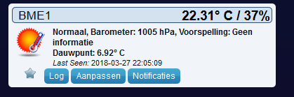

BertB
Posts: 1049
Re: ESP32 boards
#269 Post by BertB » 27 Mar 2018, 22:08
LisaM wrote: 27 Mar 2018, 20:01 Looks like a Domoticz bug... The values are there...
Probably not.
This is with the BME on a ESPEasy:
364 ESP16 141BC 1 BME1 Temp + Humidity + Baro THB1 - BTHR918, BTHGN129 22.0 C, 37 %, 1005 hPa
It looks like the string has a different format then.
Probably not.
Owwwww, then it must be a uPyEasy domoticz http controller bug! I'll check this out...
