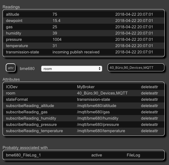

I just coded a quick and dirty version for the esp 8266 and MQTT this afternoon myself.
I am watching the values of the sensor, using fhem and make a chart.
I think your are right with the higher temperatures, 1 degree higher, pressure and humidity looks ok. gas I have to check longtime.
Maybe I will publish the code in my blog https://blog.moneybag.de and compare this with other sensors.
Lets wait and see ...

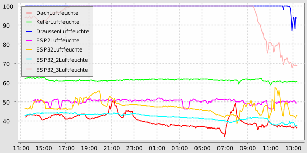

I compared the plots against BME680, Voltcraft Raumluftsensor and MH-Z19 together an I am not really satisfied with the results of the bme680.
Maybe a software bug, i used the adafruit lib 1.05. The 3 sensors laying next to each other. i am waiting for a espeasy plugin.

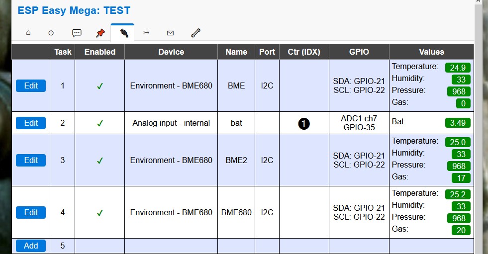

Re: BME 680 sensor
Hello bme680 users,
I bought aliexpress version (purple, about 15$), loadef P119, compiled and run.
In my test set (DHT22, DS18B20, BME680) Temperature and pressure are quite Ok: difference is +/- 0.2-0.5°C
But Humidity measured by BME680 is about +10 points higher than DHT22 value: 71.4% vs. 61.5%
Did someone get same results and find some reason and solution ?
About VOC, It's 51.5
Is it reasonable ?
Paolo

I tried to get this sensor working. Here is some feedback :
- I started with Adafruit library, but I was getting very weird results and spikes in temperature.
- Then I switched to SV-Zanshin library. This one was apparently better.
- For temperature measurement, it seems to overheat by 1-1.5 degree. If I disable the gas resistance measurement (gas heater off) and do some power off/on of the sensor with rules, I manage to get a +0.3 overheating only (compared to two other sensors), and a very stable and reproductible value. For reference, I am using this board, where the sensor is somehow a little bit isolated.
- Humidity is definitely lower than other sensors I have by 10-15%.
- Pressure after altitude correction seems good.
- For gas resistance, I can hardly make any sense of it. It seems that turning off the gas heater affects the measure even if I put it back some time before the measure. And turning off/on the sensor power supply (to limit overheating for temperature measurement) makes it worse. It probably needs some more attention on longuer periods.
- I discovered there is a BME680 driver made directly by Bosch. Maybe this could be the way to go for better results.
- In addition, Bosch is supplying an arduino library. This one uses the previous driver and applies some "higher-level signal processing and fusion for the BME680". Code it not open, and it requires some changes in Arduino IDE to compile. It seems to be well documented though.
For those interested, here is the code I used. It is base on the BME280 code, with the use of SV-Zanshin library. It does measure in two times : first temperature/humidity/pressure, and then gas resistance. It is probably not the best way to do it (especially at startup, it send zeros), but so far this is the best results I got.
Any feedback or inputs are welcomed.

I've managed to get a value with the rules....
So there is actually only a tinly little delay needed after boot before the sensore (gas only) is read correctly is what i thought.... but no
Delay on WiFi connection doesn't help at all. The Sensor needs to be polled twice before it's actually read correctly.
I had the idea about deactivating the Task "Enabled [ ]" and then manually call it via the rules. But that doesn't work.It only publishes the Task to "Controller 1" when it's Enabled.
Because my Controller 1 is not a MQTT but a Generic UDP InfluxDB i cannot use the Publish command
So my only option left is to create a dummy device and split all 4 into a new Task which is being sent...
Why is there 2 times TaskRun in there? Because directly after boot the normal TaskExecution hasn't happened yet... So it would copy 0 value otherwise.
But now it actually works as expected with Deep Sleep.... finally.

Re: BME 680 sensor
Yes.
But since I'm the only one reporting this issue I'm not fully confident that this is not a bug/hardware issue with my specific BME680 board.

Re: BME 680 sensor
on another note...
I've switched from using Rules to simply polling the same sensor twice. (Seriously didn't expect that to work in the beginning^^)
The first half day was without Deepsleep. And polling every 5 Minutes. Battery drops rapidly.
The second part was with 300sec Deep sleep waking for 1 second and using the Rules stated above, polling sensor (additionaly) twice and then copying data into dummy task. You see this part disturbs the Analog Voltage Read quite a bit.
The third part was simply using 2 times the same sensor in Devices as different tasks and only sending the 2nd one which had correct values. Way easier on Battery ADC, but for some reason the BME680 Air Value is WAY lower and also doesn't peak anymore. It stays way more constant even though i did air out the room a few times. But on the Other hand it does look more "similar" to the first part which was always online.
So now i've tried with 3 times same sensor reading and only sending Task nr 4 to the Controller. This shouldn't be due to "low" battery voltage right? Normaly Most sensors should work without issues till 3.4V down. I'll test that later when i plug a new battery...

Re: BME 680 sensor
Bosch's other sensors like the BME280 do use a filter which just slowly iterates to the actual value.
So maybe you can test by calling the non-sending task multiple times before calling the sending task?
Re: BME 680 sensor
After switching from 2 measurements to 3 measurements before sending the 3rd it goes back up to this:
So let's run it like that for a few days.

I"m using a BME280 too. No temperature offset is applied. The temperature seems to be OK comparing to another thermometer nearby. Yet the Humidity is way off. For comparison I put a ESP32 unit using BME680 with the BSEC lib next to the unit with a BME280 running ESPEasy - see picture attached comparing rose line (ESP32_3Luftfeuchte) to dark blue line (DraussenLuftfeuchte). Also a 3rd sensor from a commercial weather station gives me another, even lower reading (not in the plot).
... I'd guess so. Let's give it a try. Not sure how the correction is being done here, because if I compare the calculated dew point (same formula) of the BME680 unit with one nearby but using a DHT22 its matching pretty well.
