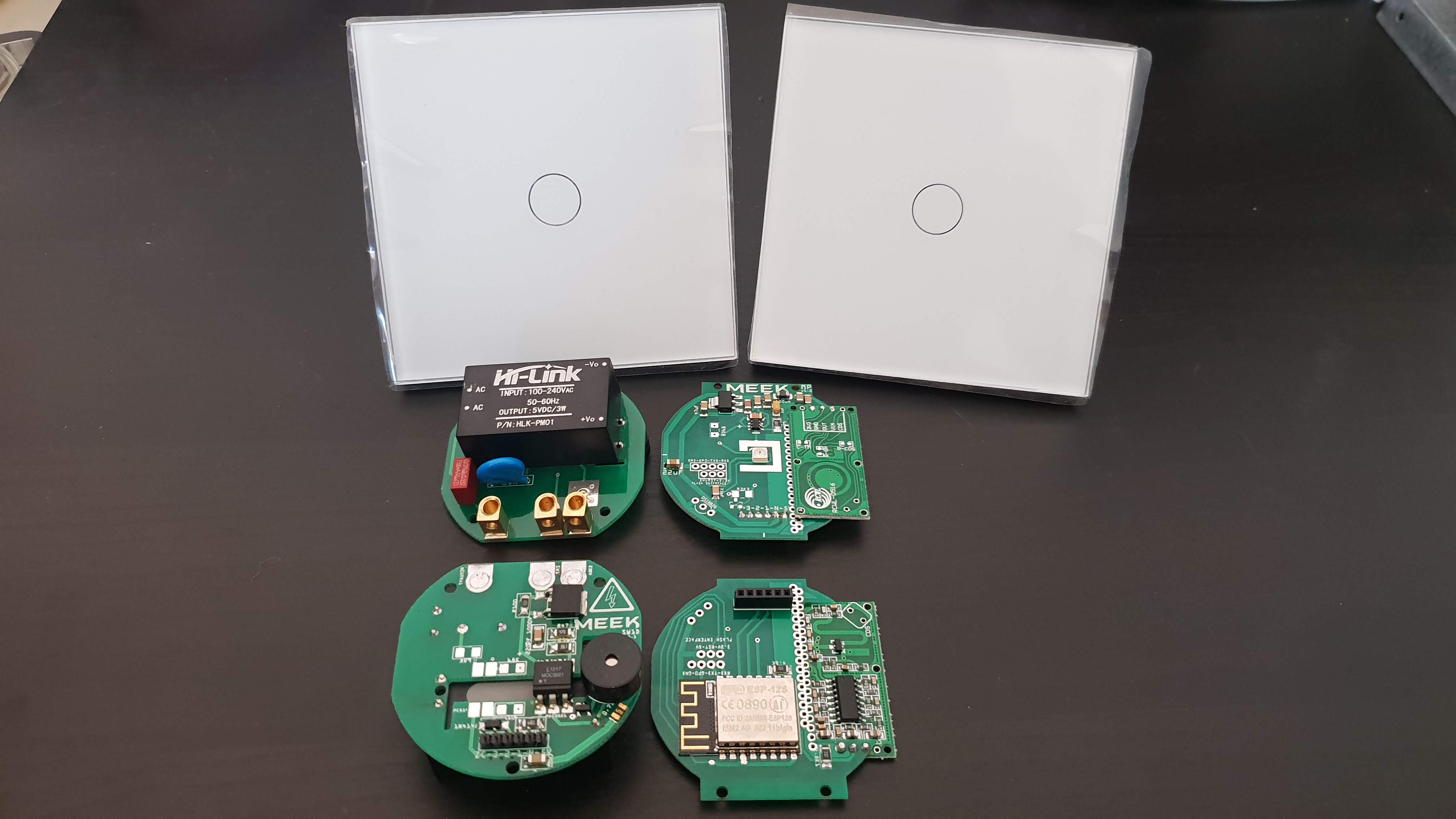

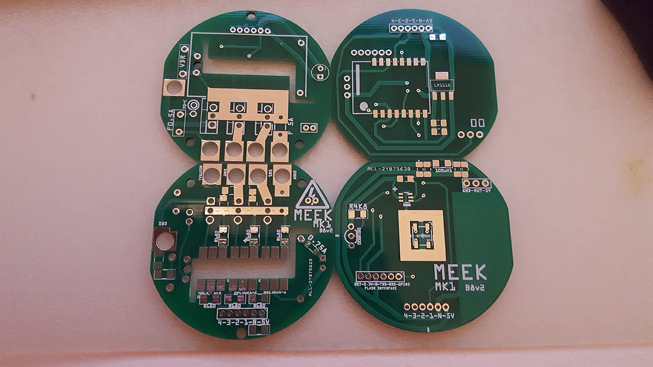

Herewith a picture of the PCB designs that will make it into the production models.

Re: Meek Wifi wall switch ESP8266
It looks like the big pads will have 230V~ on them. Do they have at least 3 mm distance from eachother?
And perhaps round the edges of these pads?
The big pads will indeed carry 230V. Due to design of the casing, it does not allow me to have a 3mm clearing between the 230V and the switching connectors.
The clearance between the 230V and Neutral will be exceeding 10mm.
Besides the clearances, I have included a fuse and an overvoltage protector on the 230V side.
On the 5V side, an overcurrent protection is applied and air gaps are also a part of the design.
The “sharp corners” are also been addresses on the new design Meek Switches.
From a safety perspective these switches are equipped with several safety features that makes this switch safe to operate.
Before the end of this month (Feb2018), I will send the latest design PCB’s to the manufacturers and hope to assemble them short after.
If you have other comments on how to improve the Meek switches, I’m all ears.

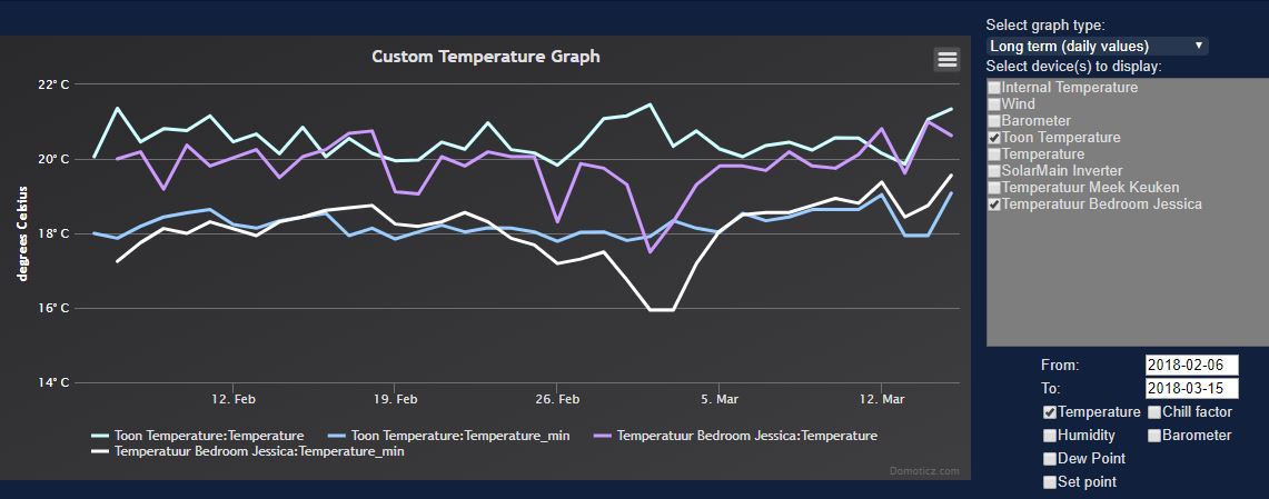

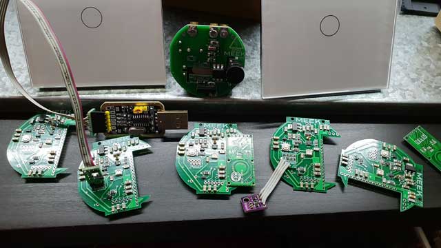

I’ve had the beta Meek MT1(1 touch button) and Meek MP1 (Meek presence with 2 outputs) equipped with a DS18b20 running for more than a month, and the temperature readings were very dependent on the power output of the triacs/power consumption of the light bulbs.LisaM wrote: ↑02 Nov 2017, 09:29If you put these sensors in very closed environment like a wall switch, doesn't the switch make the operation of these sensors very difficult?
For example the temperature sensor values might be corrupted by the heat dissipated by the esp due to the closed environment.
The readings and comparisons are made with an external temperature meter and in the graphics, they were put next to each other with the readings of my thermostat (Toon) placed in the living room.
