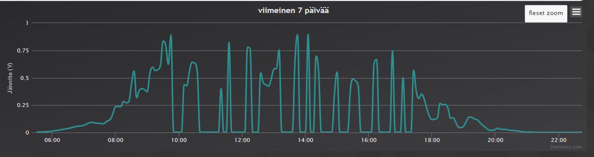

Hi I have changed the adafruit INA219 board shunt resistor to 0.01 ohm (measuring solar panels that are rated max current 4A) . I am using build 148 on NODE mcu and now I get value of 1.040 volt when measuring approx 12v. Do I need to make some changes to ina219 plugin or can it be corrected by the " device formula" ??

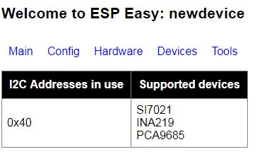

Cant get the INA219 with modified 2.5mohms shunt resistor to work. I did use StefanD modified config and compiled new firmware to my NodeMCU unit. It shows 32.76 volts even when no (out side) voltage is connected to the INA219 unit. Any one any Idea what I am doing wrong or any suggestions how to get it to work?
- INA219 i2c scan.JPG (24.05 KiB) Viewed 25291 times
- INA219 device.JPG (44.99 KiB) Viewed 25291 times
Re: INA219 shunt resistor change to 0.01 ohm
can you check if the plugin you load is the same like the one below?

Thanks StefanD,
Now with your latest plugin that you posted it seems to be working at least with few led modules connect to 12v supply I get reasonable values. Hopefully I get this installed within next week to my summer place solar panel. So that it would work better than the "original INA219" (attached pictures show the measurements is now with the original INA219 unit)
- Domoticz.JPG (42.92 KiB) Viewed 25260 times

OK! I'm making some progress. Did manage to flash one of the older builds of ESPEasy MEGA and replaced the INA plugin code with the one in this thread and it's actually working
Even though, the current reported is off by a factor of 2-ish. So any help I could get in configuring the plugin for my setup would be greatly appreciated
