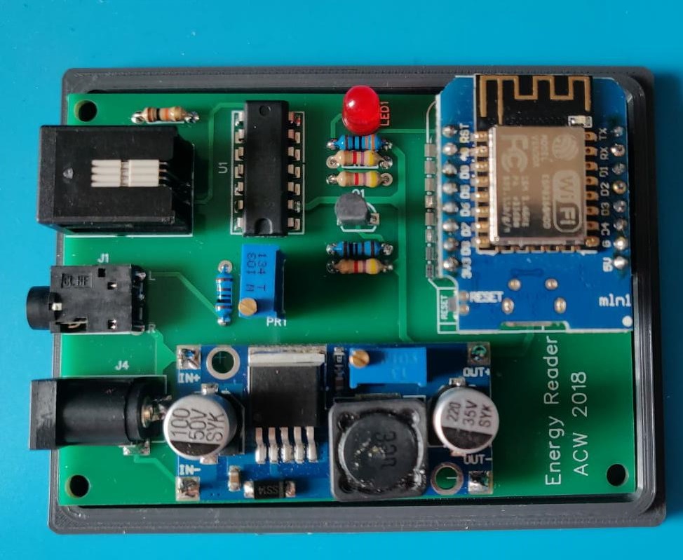

A friend of mine created this nice little board.
1
1
It deals with a (NPN) pulse counter for watermeter and deals with the P1 port of my Smartmeter. The advantage is.. It is now wirelessly accessible. :D
The board was designed to use MySensors, but as this is an ESPEasy forum... I wanted to give it a try.
Main idea is to setup a ser2net server to pass the P1 data on to Domoticz for calculation.
And setup a pulse counter to read my watermeter.
It has the following rules.
Workings:
It just counts every pulse from the watermeter and stores that value in a dummy counter. Every minute the dummy counter data is send to Domoticz. In this way you have flow (amount of liters / minute) as well in domoticz.
//------------ INITIAL RELEASE
On System#Boot do     							// When the ESP boots, do
   TaskValueSet 4,1,0							// TaskValueSet TASKnr,VARnr,Value, Reset the Liters counter to 0
   TimerSet,1,60      								// Set Timer 1 for the next event in 60 seconds
EndOn
On Watermeter#Count do						// When Pulse is detected
	if [Watermeter#Count] > 0
		TaskValueSet 4,1,[Watermeter#Count]		// Set the Pulse to the Liters dummy sensor
EndOn
on Rules#Timer=1 do  								// When Timer 1 expires, do
	if [Liters#Liters] > 0							// Only send value if amount of Liters > 0 else 'keep the change ;-)'
		SendToHTTP 192.168.2.89,8080,/json.htm?type=command&param=udevice&idx=<youridx>&nvalue=0&svalue=[Liters#Liters]
		TaskValueSet 4,1,0						// TaskValueSet TASKnr,VARnr,Value, Reset submitted Liters counter to 0
I've setup a pdf with the instructions. But seem unable to add it to this post. If people are interested I can share it.
