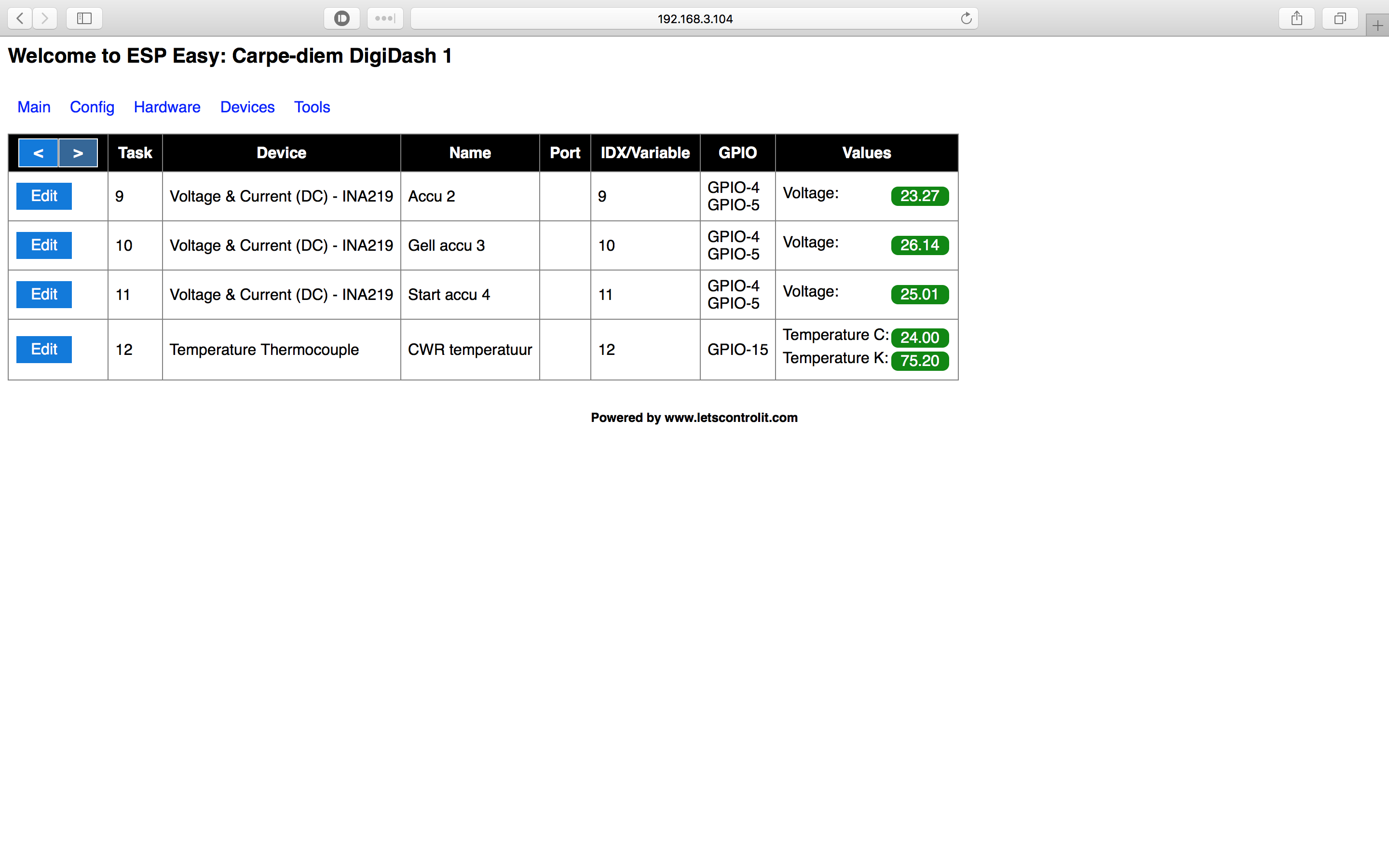

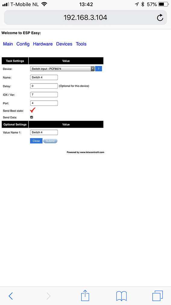

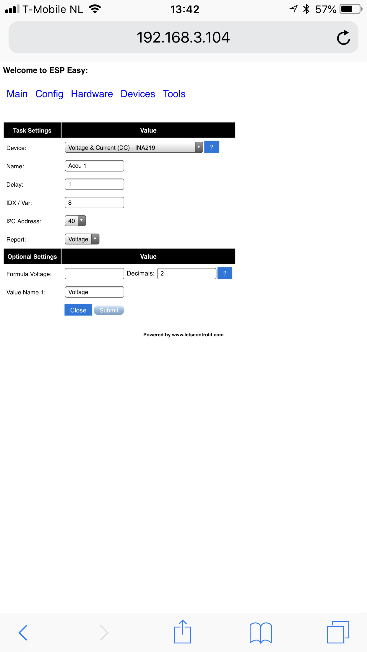

After research the INA219 and the relay are on the same ESP.
I have 3x 24V batteries, accu 1,accu 2 and accu 3 (see attachment 8,9 and 10)
And the relay is working via a IO Expander PCF8574 (see attachment 7).
Every batterie will be able to activate the relay, resulting in starting the 24V charger which feeds 3 diodes to the to be loaded batterie.

Hi neteyeNetEye wrote: ↑24 Aug 2018, 07:30 Dear TD-er and toffel969,
Great that you have some time for me, trying to solve it.
I hope this is the information you wanted.
Hope it will be a succes.

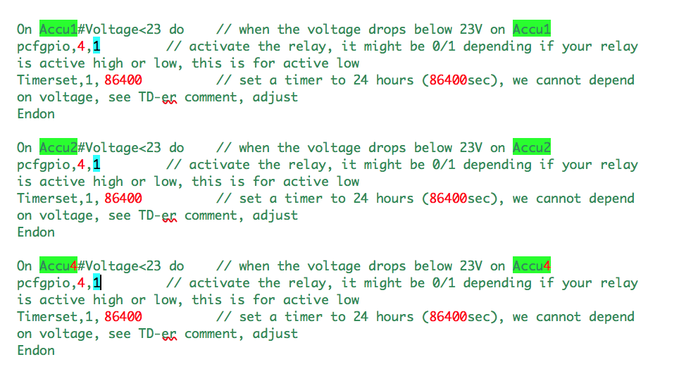

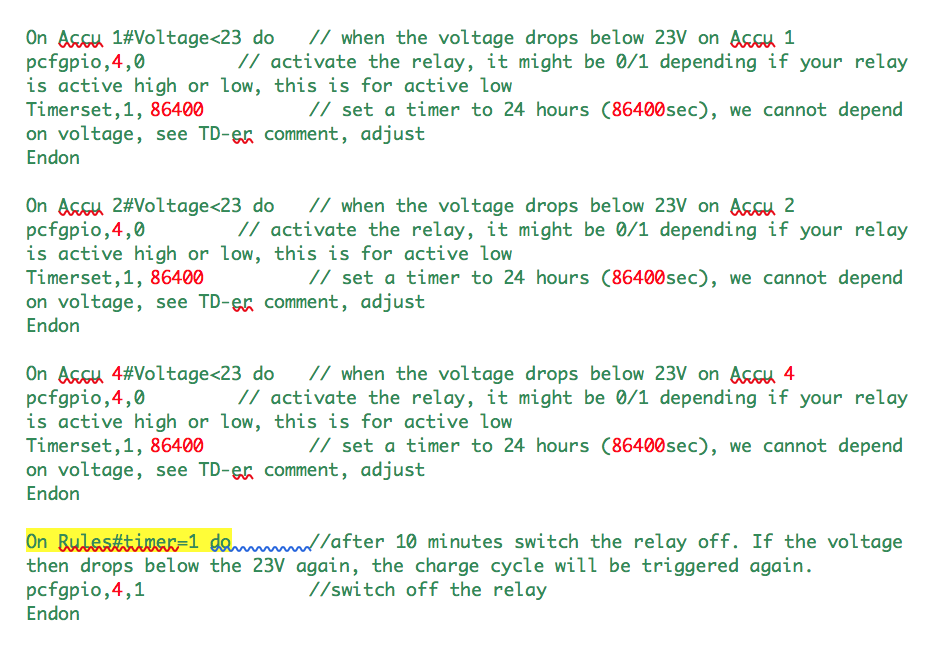

Today I implemented your rule but unfortunately it did not work (in the 2 attachments "implemented rule and switch value" you can see that the switch value remains "0".
For the test I made some short-live changes (24.8V instead of 23).
For what I noticed: you mentioned pcfgpio,7 in your rule but in my case I think it has to be pcfgpio,4 with "0" for out and 1 for on action ( because Domoticz uses pcfgpio,4 therefore I think it has to be pcfgpio,4).
For what I wish is: yours mentioned 23V as actioner for the relay to start the charger for at least 24 hours instead of 10 minutes 86400 seconds instead of 600 sec ??
This makes the thing user TD-er said (a good observation) about continuously restarting no issue.
I reviewed the rule (see attachment: reviewed rule)
Only for the yellow highlighted (On Rules#timer=1) I like it to stop after 24hours (it will not drop then under 23 after 24hrs of loading)
Am I right?
Maybe if you have some time for me, you can look at the reviewed rule then I will test its again.
Am I right?

Re: Rule/script or blockly
Dear grovkillen,
Beside toffel969 I think you and others are also capable to review the changed rule.
Do you see any overcoming mistakes.
Is the whole section with the yellow highlighted required? (On Rules#timer=1 do pcfgpio,4,1 Endon)
When I run it again i will run the log.

Hi Neteye
On pcfgpio,4 or 7 --> of course you are right, I swapped IDX and port no.
I see there are more switch input devices on your node. Does each battery have their own relay? If yes you need to adapt the pcfgpio port to the respective battery in the rules.
On the timer you are generally correct as well, I dont know if there is an upper limit for that variable. Maybe TD-er or grovkillen can comment on that. A charge time of 24h seems a bit excessive ... I would go with 3600 as in 1h. Then the unit will charge for 1h, then stop to charge. If the voltage is then below threshold again charge agin for 1h. so on.
Spaces are indeed a common source of error in rules, so I can only underline what grovkillen is saying.
With weblog he means the log that you find under the tools tab -- log.

About the switches, only switch4 operates all accus (via big diodes) the other switches are lights.
The 12V accus are the biggest to buy (230Ah each), so to get it full again a 24hrs load is needed (1hr is to short).
The minimum voltage limit I want is 23V so the rule has to start the load at 23V.
For the Vmax there is no limit needed, the charger is adjustable itself and also the diode arrange the charge.
(a Vmax is difficult to guess because off what TD-er said (the Voltage in rest is lower than when the charger is on).
I would like to handle it in time (all the years I use 24hrs in order of the supplier).
For the poll mentioned of the INA219, what delay time you advise...10sec?
Another question, on the first page I sended the "send boot state" is not marked, does it has to be check marked? (see picture).
This is fun, I have the feeling that you all will make it work.
Regards.
Quick answer, tanks, super.
Regards.
- relay with check mark.png (189.22 KiB) Viewed 23725 times

For the poll of the INA219, what delay time you advise...10sec?
How often does Domoticz actually log them ? 10 sec seems like a good start. It also depends a bit on what you do with the values.
Hello toffel969,
You forgot to answer in the rush about the check mark, hahaha, does it has to be check marked or not?
So the rule I test today will be like the picture (i don't know how to make a window wit "code: select all" ).
- just changed the start action to 1 instead of 0.
Does the "Endon" action in the rule set the switch value to "0"?
* When i would like to built another rule in the same ESP can I just write it below the other?
* And what if the INA and the switch where on a different ESP...how ould the rule be like?
(last two questions only for nice to know and to learn).
Yes this forum is fantastic and useful
- reviewed rule.png (140.46 KiB) Viewed 23716 times
Hi Toffel969,
I implemented the changed rule whiteout the yellow highlighted part.
The charger starts at the given voltage value (slightly changed for test) but its does not stop at the given time (also slightly changed for the test).
Is it possible that the yellow highlighted part needs to be in too to give the close value "0" to switch4?
Probably in only slightly change the "Rules#timer=1 that will forse it now to stop after 10 minutes instead of 24hrs.
I feel we are almost there
regards
regards
- reviewed rule with yellow Highlighted part.png (169.79 KiB) Viewed 23698 times
Hi NeteyeNetEye wrote: ↑26 Aug 2018, 14:25 Hi Toffel969,
I feel we are almost there![]()
regards
Endon terminates a rule. Without it, ESPEasy doesnt know where a rule stops and you will see all sorts of funny behaviour.
Rules#timer=1 is an event that is triggered when timer 1 elapses. Without that statement, nothing will happen after the 86400 sec --> it will never stop charging. Of course it needs to be pcfgpio,4,0 that's a logic consequence of the earlier mistake.
about different units, yes is definitly possible in more than one way.
In order to grow with the rules you definitly need to study the tutorial, it sums everything up very nicely. Also try to get the notepad++ layout from grovkillen to check for syntax errors.
https://www.letscontrolit.com/wiki/inde ... rial_Rules
check this section in particular for the remote part https://www.letscontrolit.com/wiki/inde ... #HTTP_call
If you still get stuck with something get back to the forum

- 5 devices.PNG (428.63 KiB) Viewed 21694 times
- 5 devices.png (276.74 KiB) Viewed 21694 times
- 6 devices.png (297.81 KiB) Viewed 21694 times
