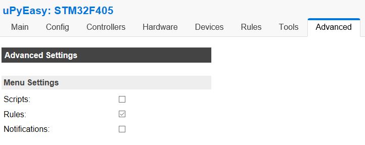

#126 Post by LisaM » 24 Jan 2018, 11:23
uPyEasy beta-1 is also having the menu's Scripts, Rules and Notifications hidden by default to make the menu bar less complex. They can be enabled in the advanced menu:
upyeasy menu hidden.JPG (26.21 KiB) Viewed 69618 times
