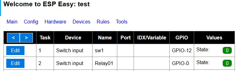

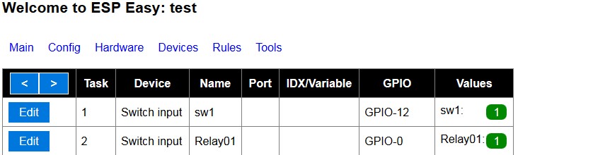

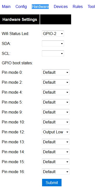

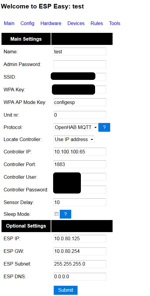

- Hardware.jpg (53.4 KiB) Viewed 23184 times
- Devices.jpg (38.91 KiB) Viewed 23184 times
- Config.jpg (80.24 KiB) Viewed 23196 times

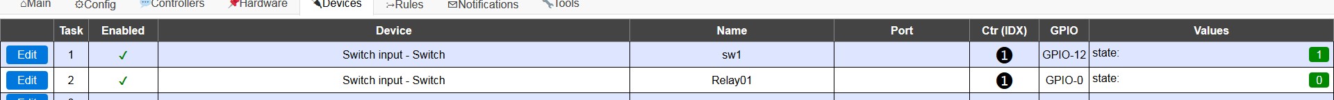

First Thnaks for all your effort to help is much appreciated!
i changed the value to "State" as you suggested
also the rule to fit my names...but i guessing i did something wrong because there is no switch action or mqtt action with event,toggeleRelay01

- state.jpg (40.43 KiB) Viewed 23323 times

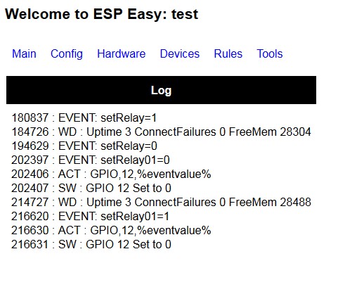

i attached the log, i can see the commands but no relay toggle.
- log.jpg (46.37 KiB) Viewed 23268 times

when i call the mqtt with event,setRelay01=1 i can see the rule respond but no relay toggle and also there is no switch action.(even no mqtt topic when pressing on the sw1)
this is my rule:
on System#Boot do

- log.jpg (58.81 KiB) Viewed 23512 times
Re: Help With Rules
It looks like the rules I provided are working as they should. But you now suggest that you want a switch press to send a MQTT message as well, news to me. You do that with the publish command and you can place that in the sw1#State event.
Regarding the relay not responding, are you sure it's connected to GPIO 12? And is the relay01 task correctly configured with name and GPIO?

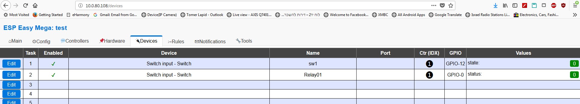

Hi again.
i updated the version. to Release mega-20180904
but got the same problem.
1.the SW1 won't toggle the relay.(i cant see any log for switch press either..)
its seems that this rule:
"On setRelay01 Do
GPIO,12,%eventvalue%
EndOn"
when setting it to GPIO 12 where the switch is connected it making the value constant 1 or 0 and make it ignoring the actual input of the switch.
if i remove the GPIO12 from this rule the sw will respond to switch press. but relay wont toggle.
2.mqtt command event,setRelay01=1 change the status of SW1 but wont toggle the relay.

Re: Help With Rules
The fact that the MQTT command is setting the switch state and not the relay suggest to me that the GPIO is mixed up.
Re: Help With Rules
i uploaded the devices and rule.
gpio 12 is the switch input
gpio 0 is the relay..
- Devices.jpg (115.23 KiB) Viewed 23677 times
Re: Help With Rules
Then you need to use GPIO,0,%eventvalue% not 12. But remember that GPIO 0 will be high on boot. This will cause the relay to trigger if the unit reboots.
Re: Help With Rules

Re: Help With Rules
Just try to change this part
To this
On setRelay Do
EndOn
On setRelay Do
GPIO,0,%eventvalue%
EndOn

hi again...
i change the rules as you suggested but there are more issues,
- if i manually change the relay with the command /control?cmd=GPIO,0,1
AND then toggle sw1, the relay toggles. but only once(additional sw1 press is doing nothing).
- Also if i send payload: event,toggleRelay01 it only changes once to 0 from 1. and another event wont change the relay state.
- mqtt setRelay01/0 or 1 wont toggle the relay.

465953987: ACT : Event,toggleRelay01
465954044: Command: event
465954045: EVENT: toggleRelay01
465954072: ACT : Event,setRelay01=0
465954105: Command: event
465954105: EVENT: setRelay01=0
465954123: ACT : GPIO,0,0
465954125: SW : GPIO 0 Set to 0
465956475: EVENT: sw1#state=1.00
465956485: ACT : Event,toggleRelay01
465956540: Command: event
465956541: EVENT: toggleRelay01
465956570: ACT : Event,setRelay01=0
465956601: Command: event
465956602: EVENT: setRelay01=0
465956620: ACT : GPIO,0,0
465956622: SW : GPIO 0 Set to 0
465957975: EVENT: sw1#state=1.00
465957985: ACT : Event,toggleRelay01
465958044: Command: event
465958044: EVENT: toggleRelay01
465958070: ACT : Event,setRelay01=0
465958097: Command: event
465958098: EVENT: setRelay01=0
465958116: ACT : GPIO,0,0
465958118: SW : GPIO 0 Set to 0
465959042: EVENT: toggleRelay01
465959069: ACT : Event,setRelay01=0
465959098: Command: event
465959099: EVENT: setRelay01=0
465959117: ACT : GPIO,0,0
465959120: SW : GPIO 0 Set to 0
465959173: SW : Switch state 1 Output value 1
465959175: EVENT: sw1#state=1.00
465959184: ACT : Event,toggleRelay01
465960173: SW : Switch state 1 Output value 1
465960175: EVENT: sw1#state=1.00
465960184: ACT : Event,toggleRelay01
465960239: Command: event
465960239: EVENT: toggleRelay01
465960268: ACT : Event,setRelay01=0
465960293: SW : Switch state 0 Output value 0
465960295: EVENT: sw1#state=0.00
465960305: ACT : Event,toggleRelay01
465961321: Command: event
465961322: EVENT: toggleRelay01
465961349: ACT : Event,setRelay01=0
465961382: Command: event
465961383: EVENT: toggleRelay01
465961411: ACT : Event,setRelay01=0
465961438: Command: event
465961439: EVENT: toggleRelay01
465961468: ACT : Event,setRelay01=0
465961985: SW : GPIO 0 Set to 0
465961999: Command: event
465962000: EVENT: toggleRelay01
465962025: ACT : Event,setRelay01=0
465962048: WD : Uptime 7766 ConnectFailures 2 FreeMem 19088
465962049: Command: event
465962050: EVENT: setRelay01=0
465962067: ACT : GPIO,0,0
465962069: SW : GPIO 0 Set to 0
465971855: SW : GPIO 0 Set to 1
465971873: SW : Switch state 1 Output value 0
465971878: EVENT: Relay01#status=0.00
465973935: SW : Switch state 0 Output value 1
465973939: EVENT: Relay01#status=1.00
465973996: Command: event
465973997: EVENT: toggleRelay01
465974025: ACT : Event,setRelay01=0
465974050: Command: event
465974050: EVENT: setRelay01=0
465974068: ACT : GPIO,0,0
465974072: SW : GPIO 0 Set to 0
465977941: SW : GPIO 0 Set to 0
465985990: EVENT: sw1#state=1.00
465985999: ACT : Event,toggleRelay01
465986055: Command: event
465986056: EVENT: toggleRelay01
465986083: ACT : Event,setRelay01=0
465986111: Command: event
465986112: EVENT: setRelay01=0
465986129: ACT : GPIO,0,0
465986131: SW : GPIO 0 Set to 0
465990197: EVENT: sw1#state=1.00
465990206: ACT : Event,toggleRelay01
465990262: Command: event
465990262: EVENT: toggleRelay01
465990290: ACT : Event,setRelay01=0
465990323: Command: event
465990324: EVENT: setRelay01=0
465990342: ACT : GPIO,0,0
465990344: SW : GPIO 0 Set to 0
465992041: WD : Uptime 7767 ConnectFailures 2 FreeMem 18160
465996965: SW : GPIO 0 Set to 1
465996995: SW : Switch state 1 Output value 0
465996998: EVENT: Relay01#status=0.00
466002100: EVENT: sw1#state=1.00
466002109: ACT : Event,toggleRelay01
466002165: Command: event
466002166: EVENT: toggleRelay01
466002194: ACT : Event,setRelay01=0
466002227: Command: event
466002228: EVENT: setRelay01=0
466002246: ACT : GPIO,0,0
466002249: SW : GPIO 0 Set to 0
466012829: EVENT: sw1#state=1.00
466012838: ACT : Event,toggleRelay01
466012894: Command: event
466012895: EVENT: toggleRelay01
466012923: ACT : Event,setRelay01=0
466012954: Command: event
466012954: EVENT: setRelay01=0
466012972: ACT : GPIO,0,0
466012975: SW : GPIO 0 Set to 0
466013929: EVENT: sw1#state=1.00
466013938: ACT : Event,toggleRelay01
466013992: Command: event
466013993: EVENT: toggleRelay01
466014022: ACT : Event,setRelay01=0
466014053: Command: event
466014053: EVENT: setRelay01=0
466014071: ACT : GPIO,0,0
466014073: SW : GPIO 0 Set to 0
466014829: EVENT: sw1#state=0.00
466014839: ACT : Event,toggleRelay01
466014894: Command: event
466014895: EVENT: toggleRelay01
466014921: ACT : Event,setRelay01=0
466014954: Command: event
466014955: EVENT: setRelay01=0
466014973: ACT : GPIO,0,0
466014975: SW : GPIO 0 Set to 0
466016229: EVENT: sw1#state=1.00
466016239: ACT : Event,toggleRelay01
466016295: Command: event
466016296: EVENT: toggleRelay01
466016324: ACT : Event,setRelay01=0
466016356: Command: event
466016357: EVENT: setRelay01=0
466016375: ACT : GPIO,0,0
466016378: SW : GPIO 0 Set to 0
466022043: WD : Uptime 7767 ConnectFailures 2 FreeMem 19728
466052043: WD : Uptime 7768 ConnectFailures 2 FreeMem 19728
466082043: WD : Uptime 7768 ConnectFailures 2 FreeMem 19728
466089033: SW : GPIO 0 Set to 1
466089041: SW : Switch state 1 Output value 0
466089044: EVENT: Relay01#status=0.00
466100643: EVENT: toggleRelay01
466100668: ACT : Event,setRelay01=0
466100690: Command: event
466100691: EVENT: setRelay01=0
466100708: ACT : GPIO,0,0
466100710: SW : GPIO 0 Set to 0
466100738: SW : Switch state 0 Output value 1
466100741: EVENT: Relay01#status=1.00
466103704: EVENT: setRelay01=0
466103721: ACT : GPIO,0,0
466103723: SW : GPIO 0 Set to 0
466104643: EVENT: toggleRelay01
466104667: ACT : Event,setRelay01=0
466104692: Command: event
466104693: EVENT: setRelay01=0
466104710: ACT : GPIO,0,0
466104712: SW : GPIO 0 Set to 0
466112043: WD : Uptime 7769 ConnectFailures 2 FreeMem 19728

Sounds to me that you're not actually using the correct name of this part: if [Relay01#Status]=0. Observe that my example uses "state" where you use "status"!

actually This is my current rule:
on System#Boot do
gpio,0,1 // Prevent relay turning on during boot
On sw1#state Do
Event,toggleRelay01
EndOn
On toggleRelay01 Do
if [Relay01#state]=0
Event,setRelay01=1
Event,setRelay01=0
EndOn
On setRelay01 Do
GPIO,0,%eventvalue%
EndOn
on System#Boot do
On sw1#state Do
Event,toggleRelay01
EndOn
On toggleRelay01 Do
Event,setRelay01=1
Event,setRelay01=0
EndOn
On setRelay01 Do
GPIO,0,%eventvalue%
EndOn
Re: Help With Rules
And there you have it, you are not using YOUR name of the relay value... you use my example "state" not YOUR name "status"!

OK, thanks for the input i didn't noticed that.
i changed the name to be state
when pressing the SW1 nothing happening to relay.
on the mqtt console i can see it any press make the status go from 0 to 1 with single press.
/test/sw1/state 0
/test/sw1/state 1
/test/sw1/state 0
/test/sw1/state 1
- Devices.jpg (58.15 KiB) Viewed 23637 times
Re: Help With Rules
Sounds like you have the setup for the switch wrong, do you have it as a "normal" switch in the settings?
