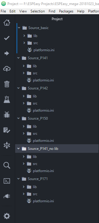

I'm not a programmer, only a simple user who was interrested in the possibilities of the _P141 Plugin together with a Huacanxing H801
This is the structure of testing the plugins,
I started on another computer with Platformio as descriped in de Wiki. I used ESPEasy_mega-20181023 as file.
First i compiled ESPEasy_mega-20181023, no problem with the normal-test-dev_ESP8266 versions.
Then i add _P141, with the library FastLED-3.1.8 and #include <FastLED.h> to ESPEasy_mega-20181023.

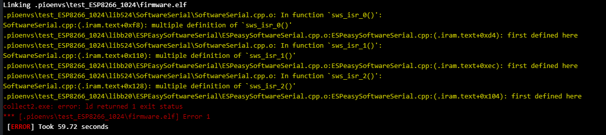

Problems:
collect2.exe: error: ld returned 1 exit status
*** [.pioenvs\normal_ESP8266_1024\firmware.elf] Error 1

Then i add _P141, with #include <FastLED.h> to ESPEasy_mega-20181023 but without the library.
Problems:
My question to you, can you maybe try to compile the _P141 Plugin to see what the results are in your environment?
