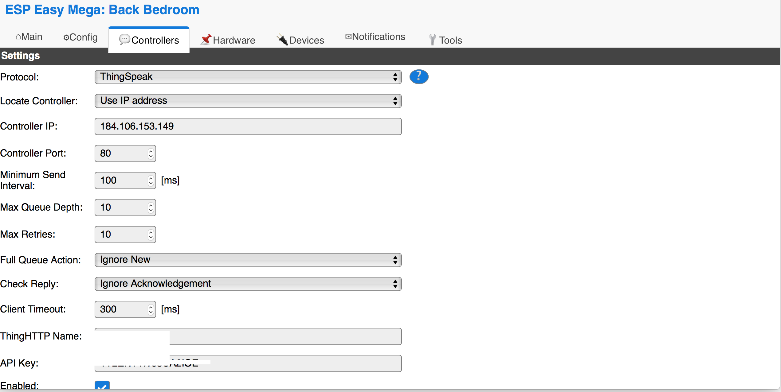

resistor added, no change. these are my controller settings
Re: ESP Easy > Thingspeak
#6 Post by grovkillen » 23 Oct 2018, 19:34
Minimum send interval for thingspeak is 15000

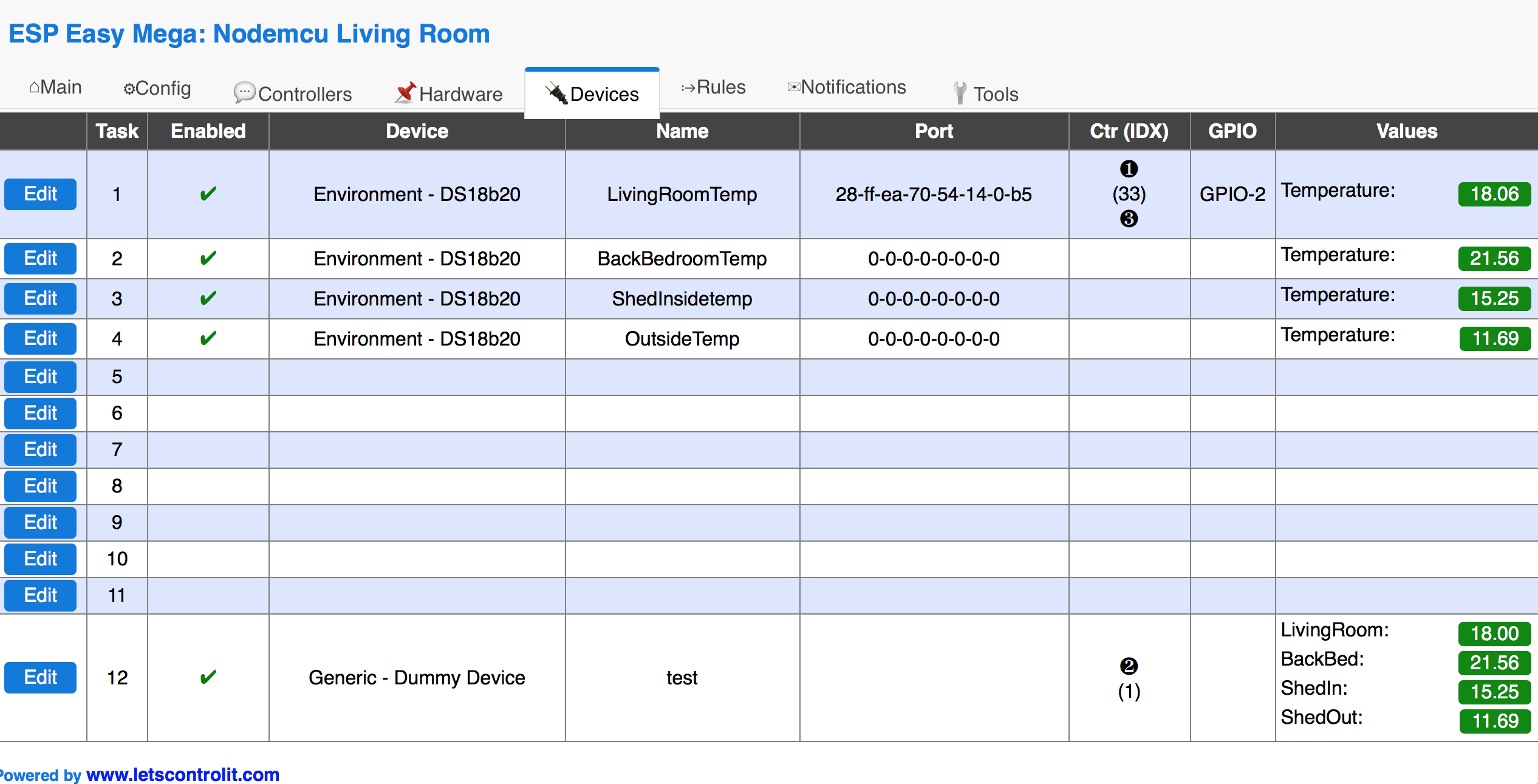

TD-er wrote: 24 Oct 2018, 12:40 Node 1: DS18b20 at plugin position 1 => send to Thingspeak controller
Node 2: DS18b20 at plugin position 2 => send to ESPeasy P2P networking controller
Node 3: DS18b20 at plugin position 3 => send to ESPeasy P2P networking controller
By plugin position do you mean tasks, as it happens I have been doing some reading on the UDP stuff and seems to be very interesting and has lots of potential for my build, especially to get data all onto one small LCD.

Finally got there,
All Nodemcu's communicate via UDP the main (living room) Nodemcu. This nodemcu uses the UDP sensors to create a dummy sensor (quad dummy sensor) which is then sent to thingspeak as 1 update (every 60seconds) using a rule. Any other way I tried was hit and miss as it appears ESPEasy sends each update individually not as a bulk update for the controller causing thingspeak to have a meltdown as the updates were more often than the 1 per 15 seconds.

#19 Post by garnold » 19 Aug 2019, 15:37
How are you populating the values in the dummy device? I would like to do something simular to what you have done. Can I please see your rule?
#20 Post by TD-er » 19 Aug 2019, 20:16
garnold wrote: 19 Aug 2019, 15:37 How are you populating the values in the dummy device? I would like to do something simular to what you have done. Can I please see your rule?
Use TaskValueSet as command.
