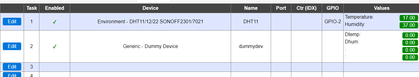

I dont understand dummy device. have a dht11 connected, rules as suggested, always xx.00 degrees.
- Knipsel.PNG (45.3 KiB) Viewed 20198 times
Re: DHT11 not decimal values?
Ok, so you have the dht on task number 12? Our suggestion was to use a separate device called dummy device. The DHT should only add it's values not be the one publishing them. So that last line where we use the TaskValueSet we should point it to a dummy device, not back to the DHT device.

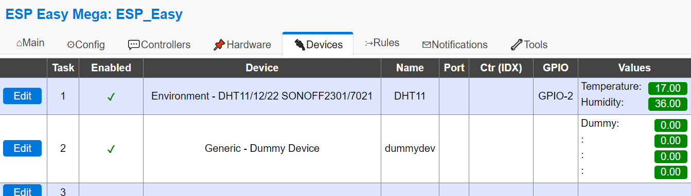

No changes,
VAR#1 and 2 , do i need to change that to DHT11#Temperature ?
WHere does VAR#2 come from?
On Temperature#Value Do
Let,2,[dummydev#Dtemp]*4
Let,1,[DHT11#Temperature]
TaskValueSet,2,1,([DHT11#Temperature]+[dummydev#Dtemp])/5
EndOn
with:
EndOn
with:
- Knipsel.PNG (19.39 KiB) Viewed 20175 times
Copy and paste my code, it'll work. Please study your code and you'll see that you're not using the correct event trigger.
