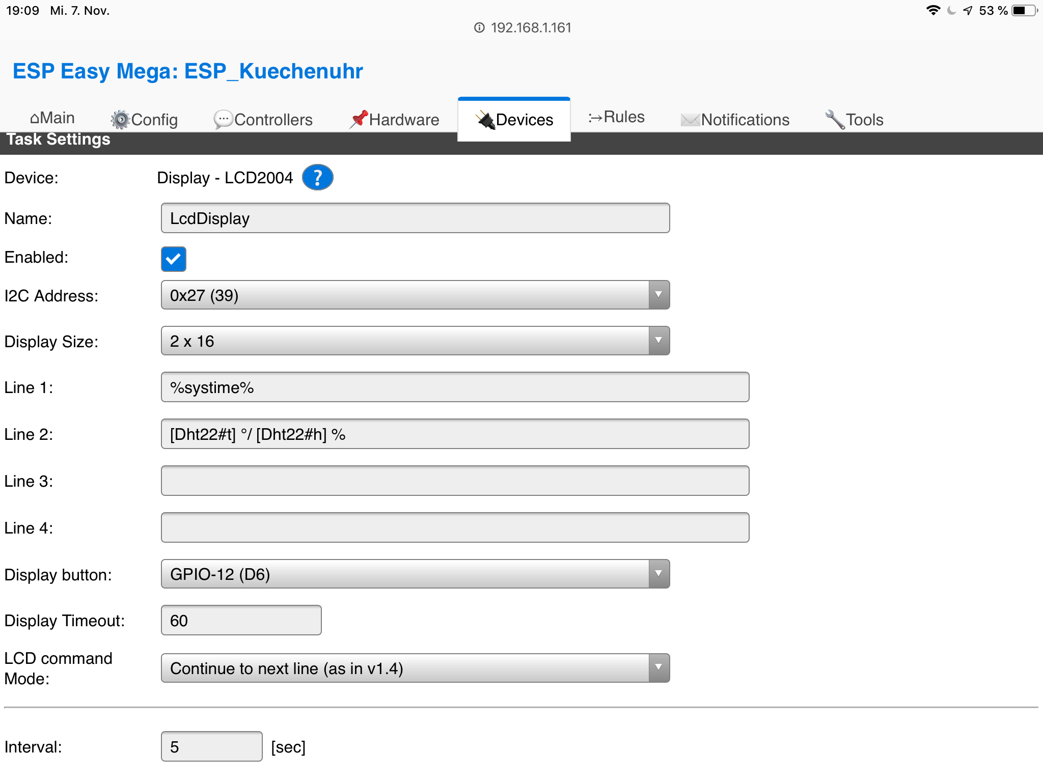

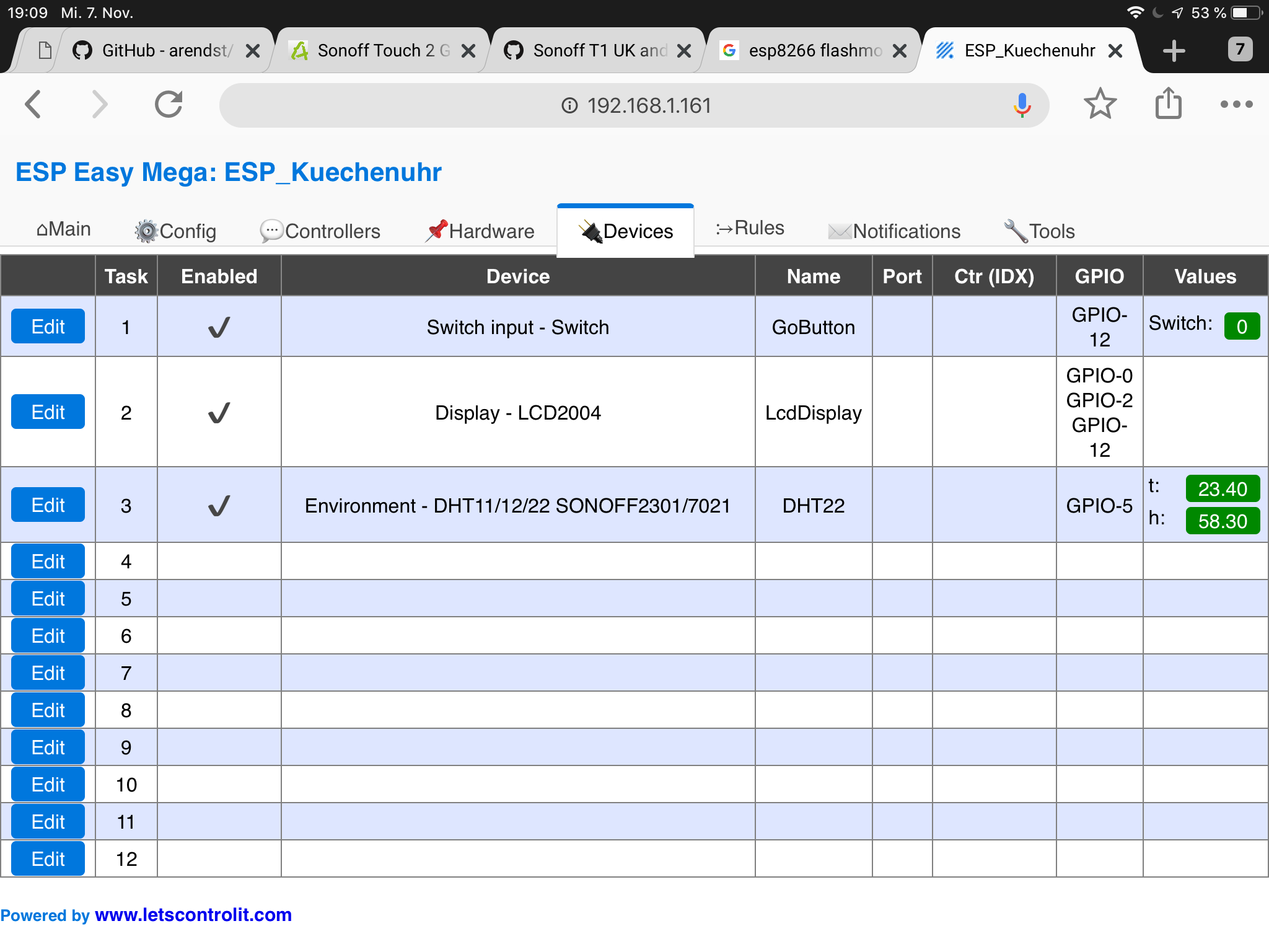

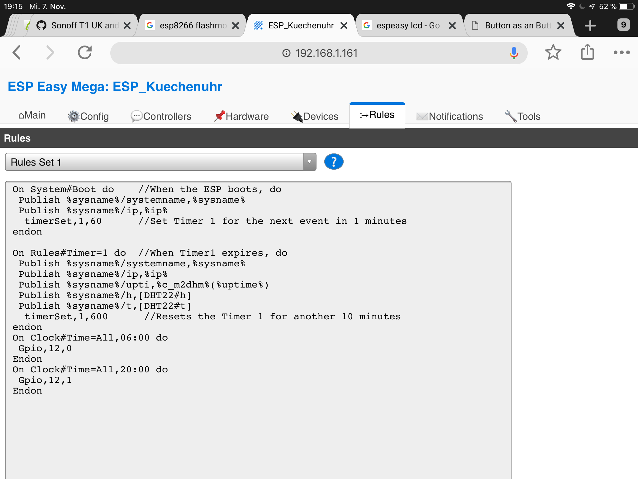

For the german guy how ask me for the Solution about this Problem. 2. 3. Screenshot
BTW. My biggest Problem was an bug in the firmeware at my First trys.
On the First Screenshot we See how its possible to switch off the Display for night
