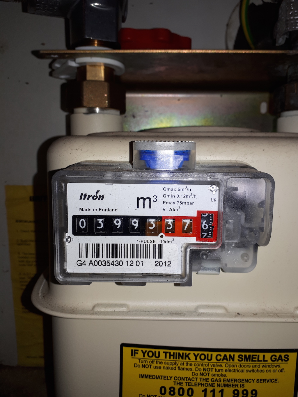

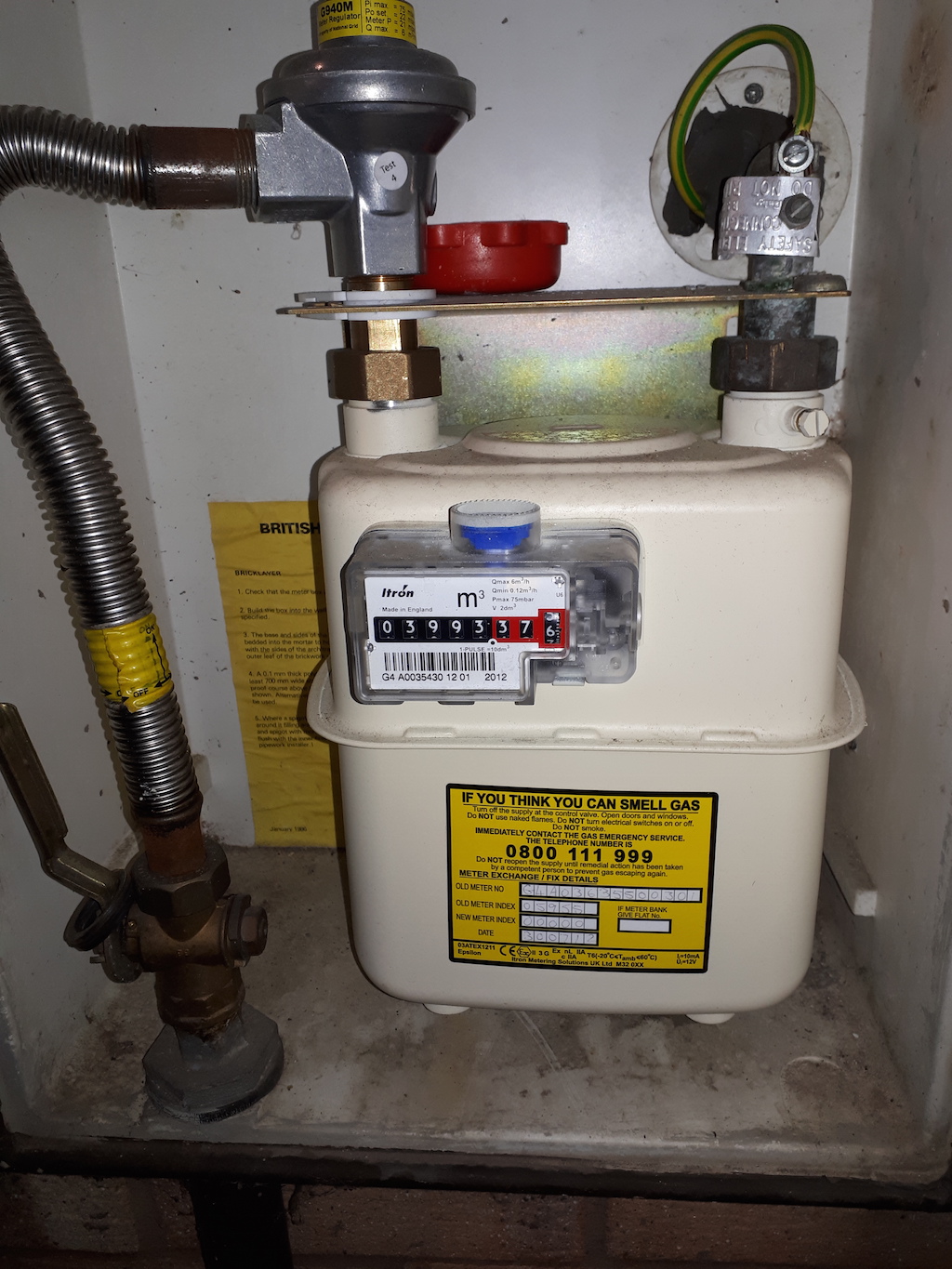

Any suggestions for how I can read this gas meter using Espeasy?
- 20181108_182227.jpg (451.55 KiB) Viewed 9141 times
- 20181108_182221.jpg (502.3 KiB) Viewed 9141 times

I see 1 pulse =10 dm3
Is this reader an option?
https://www.letscontrolit.com/wiki/index.php/TCR5000
Re: Reading Gas meter
This is a std meter with a magnetic pulse, as there is no electrical connection !
It just has a mechanical totaliser with magnetic pulse for an additional electrical totaliser module, TCR5000 will not work
So a magnetic pulse sensor or similar reed or hall sensor should work.
