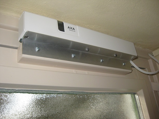

Since yesterday the window of my lavatory is onder full control of ESP Easy and Domoticz. For ESP Easy I used a Witty Board and a 2 channel relay board with opto.
The relays switched on for 2 seconds with a rule. In Domoticz i used a switch, type blinds. This works perfect for me.
I modified a AXA wall switch and connect it with the relay board. The relays switched on for 2 seconds with a rule. In Domoticz i used a switch, type blinds. This works perfect for me.

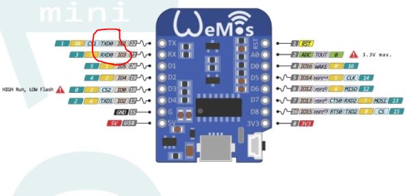

I managed to connect the serial port from esp to the axa directly, using a Lin convertor. Through http calls i can open, close en stop the device. No need for relais en you can avoid bying the wall unit as well. The 7.5v power supply that feedx the axa is used to power the esp as well, using a step down module. I am happy with the results amd also total costs is quite low. Amazing chips the Esp...

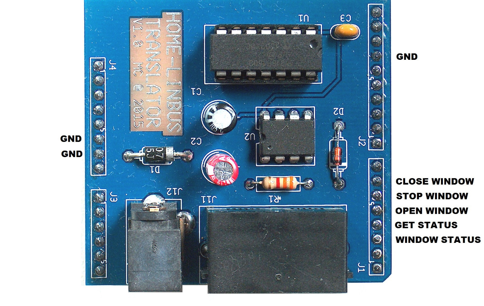

i connected the ESP chip as per the diagram attached. i found this on the EU domotic forum. these are the only components i used. i connected Tx and Rx from the Wemos D1 mini to this MCP chip as shown. In my code (i use the Arduino compiler) i setup a HTTP connection with my homeautomation system but you can also connect to a webbrowser. from the webbrowser or automation system i am polling any information received. i took this code from the general Arduino example sketches.
based on the text it receives from the webpage, it determines what code to send to Axa. it will send OPEN, CLOSE or STOP just using normal Ascii over this serial interface.
i can not get access to this code now, but i will post it this evening.
OOPS: i can not attached attachments, i dont know why, the schematic is shown on this page:
http://forum.micasaverde.com/index.php/ ... #msg304710
hope it helps.

I have attached the print that i made (test print, i will make proper PCB later on as i need to control 4 AXA modules...) and the housing i printed on my 3d printer....
you can see the RJ25 housing, here i connect the cable to the AXA module. it controls the aXA but also powers it.
only limited amount of components necessary.
i will make a video at home, but basically not much to see. you press the button and it moves. let me post this in the weekend
sorry for delayed reply, i did not see the post.

Otje, have you got any diagrams for how you wired this?
I'm mainly interested in how the MCP2003 (I assume you used one?) connects to the ESP, and how the MCP2003 is powered.
My big concern is voltage levels.
ESP power should be 3.3v, and logic levels of the ESP should be 3.3v.
MCP2003 data sheets seem to say it needs to be powered 6-30v, and output logic levels (on the uart/ESP side) will be close to it's power voltage.
So did you power the MCP2003 from the 7.5 volt AXA power supply, or do you power it the same as the ESP, at 3.3v?
And if you used 7.5 volt on the MCP2003, did you add any level converter or such?
Also, can someone confirm if the AXA needs to be powered from a AXA power supply (their not that cheap!
) for the LIN bus to work?
Or does it also work on battery?
I've seen that mentioned, but not convincingly so.
Thanks!!

Hi Guys & girls.
I have a Axa window opener, which i want to operate from Domoticz.
My Axa is connected to this Home linbus arduino shield kit :
http://www.ebay.nl/itm/Arduino-Uno-R3-S ... 1524803718
I have a NodeMcu Lua WIFI Board ESP8266 CP2102 Module on which i have installed esp easy.
Now it possible to control the Axa by making ports high and low on the linbus board .
Now my question is how to connect the linbusd board to the NodeMCu , and what settings i should use in esp easy.
so i can control the axa from domoticz ( i know how to set up the part in domoticz with virtual devices etc.
Since you guys have connected the axa before, im asking a bit of help ?
Thanks in advance
Karel
Thanks in advance
Karel
Re: AXA Remote 2.0 and ESP Easy
Hello All
i havent been looking on this post for quite some time as for me the AXA works with ESP as i descibed in the posts on page 1 of this topic. the schematic was also posted but i will attach it here as well. i use standard ESP8266 firmware, i am not using ESP Easy as i wants some flexibility. i also dont use domoticx so i can not really help, i use Vera Zwave controller.
i use a standard power supply that can deliver 2A, i did not buy the more expensive ones from AXA itself. i also use WEmos more and more, as i like this concept, but it is based on same ESP platform.
on the schematic: i connect the Tx and Rx from ESP8266 to the Rx and Tx from the AXA schematic. i also posted the arduino code and as you can see i just transmit the text open close or stop to the axa. sometimes it may not work i expect because of the sensiitivity of the cable i had connected to Axa (6m cable for linbus), but i just repeat the code twice to make sure.
it is actually fairly simple if you use the schematic and the standard ESP firmware and the arduino environment. i hope this helps.
- AxaSchematic.jpg (52.95 KiB) Viewed 25719 times
- wemos.JPG (31.97 KiB) Viewed 25719 times

Finally I make progress with my axa remote 2.0 which I want to control with domoticz. I bought a linbus converter on superhouse:
https://www.google.nl/url?sa=t&rct=j&q= ... h8hKy-Rx39
I connected it with a wemos d1 and use the arduinoscript from:
https://www.letscontrolit.com/forum/vie ... php?t=2245
I'm almost there but I have noticed that I have to repeat every command. I have no knowledge of arduino coding.
How do I adjust this scripts so that every command repeat one time (of two)?
