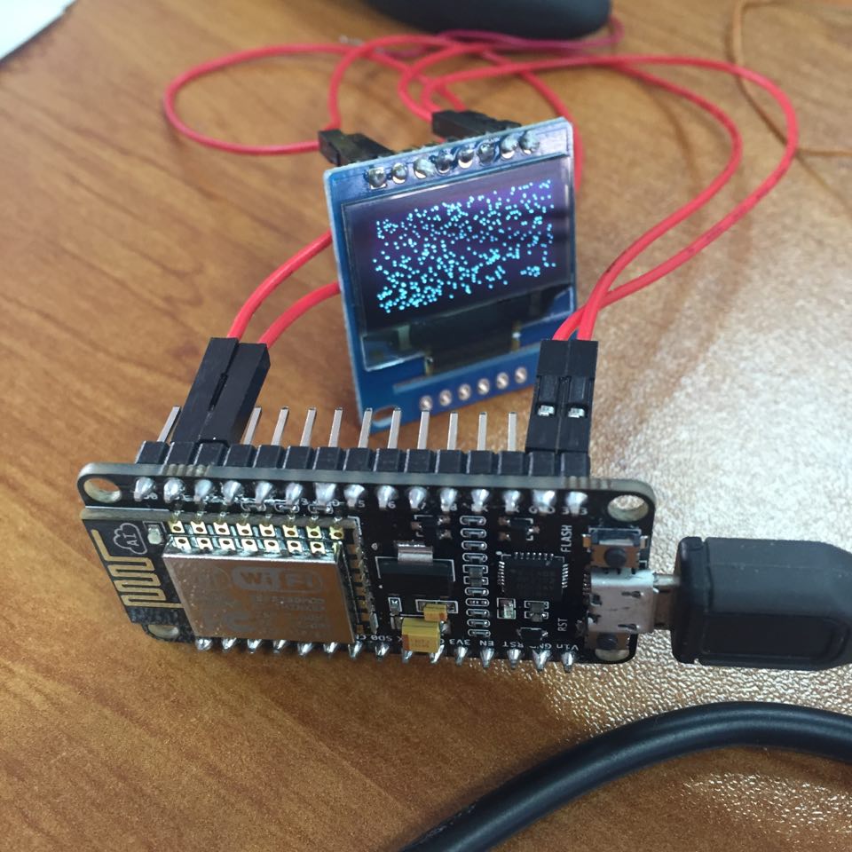

I have the wellknown OLED 0.96 inch display with SSD1306 controller.
It has a configurable I2C address with a solderpad at the backside, marked as 78 or 7A with translates to address 3C or 3D. (I2C adresses have to be divided by 2 sometimes as the even address is the listen and the uneven address is the talk address of the same device 78/79=3C and 7A/7B=3D).
As I have another OLED 1.3 inch display already on address 3C i have changed my 0.96inch display to address 3D.
I had to change the ESPEasy sketch in 2 places to make the OLED work again with this different address.
in file: _P023_OLED.ino : line 294 #define OLED_address 0x3d // was 0c3c
and had to add 3 lines in the WebServer.ino after line 1127
case 0x3D:
reply += F("OLED SSD1306 Display");
p.s. i use the 048 release

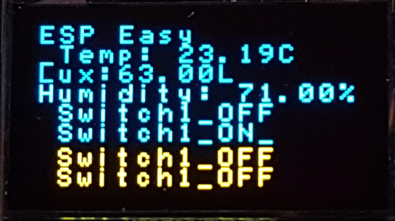

Not sure why I have yellow text in lines 7 and 8?Re: OLED I2C
You have a bi color Oled.
There are several version available.
http://www.ebay.nl/itm/5Pcs-0-96-Inch-4 ... SwYaFWb0Oi
Paco
Paco
Re: OLED I2C

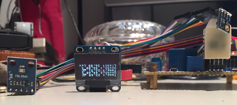

There is a specific internal SSD1306 command to set the direction how the display draws its pixels.hamster wrote: ....
bought this http://www.ebay.co.uk/itm/321927689593
Works great.. bicolor looks cool.
If you have a bicolor oled ESPEasy will draw line 7 & 8 in the second color.
If the rotate screen command is used first you will find that line 1 & 2 are in the second color. (Like the picture on Ebay shows the display)
You have to live with the fact that ESPEasy does it this way or else you have to dig deep in the plugin sourcecode to add the extra command for screen rotation.

HI guys. I am using SSD1306 128x64 display by TinySine. I am using easyesp r48 on nodemcu v1(also tried it on adafruit huzzah feather, same sh^t) This is the image i get on the screen. Can you give me any suggestions why is the screen displaying this?
PS: The display works with Raspberry Pi

Re: OLED I2C
The OLED has to be reset first, as a simple power on often leaves it in a uncertain state.
Try to connect the reset of the OLED to the reset of the NodeMCU. That worked for me.

hm... Thank you it works now. But in the wiki, it says to connect just the 4 pins, why is that?
Re: OLED I2C
We will improve the wiki. Sorry for the confusion.
