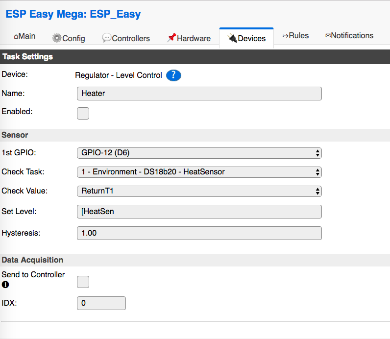

I think I got it.
You mean probably https://www.letscontrolit.com/wiki/inde ... velControl and set the target value via "Set Level:", right?
Variable target values, i.e. the measured values of another sensor as target value, obviously cannot be entered.
(see screenshot; it's cuted, limited length)
If this were possible, it would probably solve the problem in the sense of a two-point control.
In addition to "On/Off", the GPIO would also have to accept "PWM" for stepless control.
Ingenious approach on your part, but not yet fully supported.
Any chance to get that missing elements implemented? Whom to ask as I'm not a developer ...
/FJ

if you could give me a hint how I can change the value for "Set Level:" within the PlugIn "Level Control" from "outside", then I can try that.grovkillen wrote: ↑29 Aug 2018, 05:45 Okay sounds like you should be able to do that via rules and dummy's.
Should this also work with "TaskValueSet"? Or is there another action to influence the target value from a rule with or via dummy devices?
Entering a variable, e.g.: "[Return1#Temperature]" instead of a fixed value, e.g. "28", for the target value does not seem to work. I already tried that.
/FJ
