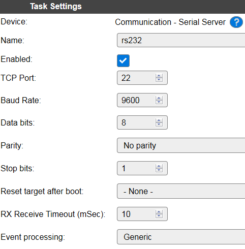

I'm trying to get a Wemos D1 Mini (flashed with the latest ESP Easy release) to talk to a JY-MCU bluetooth module.
I assume I should use the "Communication Serial Server", but what value do I put in for the "PORT" ?
I can pair to the module from my mobile phone and send data, but nothing appears at the Wemos end.
If any one has got the serial communication to work, could they share the basics with me.
Kind regards from David.

Hi to one and all,
I'm still trying to get the serial port working on a Wemos D1 Mini.
This is what my basic rule looks like...
on !Serial#* do
publish david,%eventvalue%
serial "fred was here"
I get this MQTT message returned to Node-RED when I send red from my terminal (phone)... " david : msg.payload : string[11] "!Serial#red"
Two questions...
(1) How can I extract or find the data that was sent to the Wemos ??
i.e. %eventvalue% gives !Serial#red" - I was hpoing it would give "red"
(2) How can I "publish" serial data from the Wemos to my phone ??
i.e. What's the correct command as "serial" doesn't seem to work?
Any help or guidance would be appreciated.
