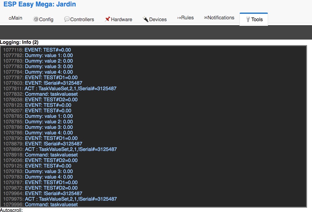

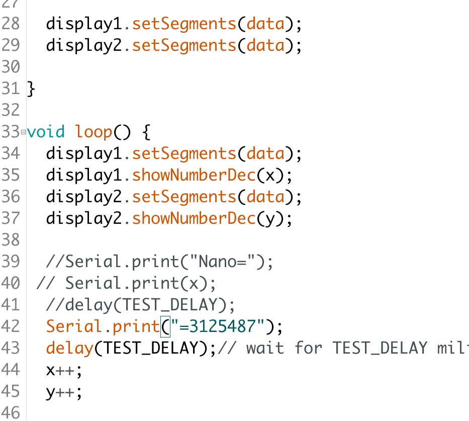

Hello, I'm looking for the same kind of information about the Ser2Net plugin.
I'm trying to send info from an Arduino nano (or any arduino) to an ESPEasy (a Wemo D1 R2 for the moment, but I have many other models).
I get to see the info sent by the Arduino in the ESPeasy log, but I can not put them in the "Dummy" task, either directly (TaskValueSet, x, y, value) or via Rules as described in the mail of "Kimot".
I installed different firmware (20181026 -> 20190409) without success on my search.
If you have an idea, she will be welcome.
For information my assembly is the following: the Nano manages 3 TM1637 displays to display the temperature of 3 local aquariums (DS18B20), and must send these data on a display (LCD) located several tens of meters and for this I use the Node function and the UDP of the Easy.

#6 Post by Nemocaledonie » 11 Apr 2019, 08:42

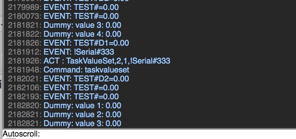

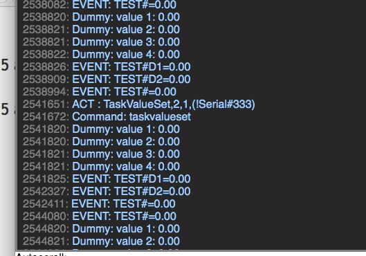

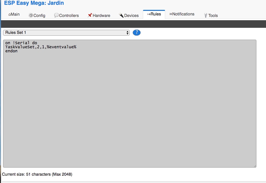

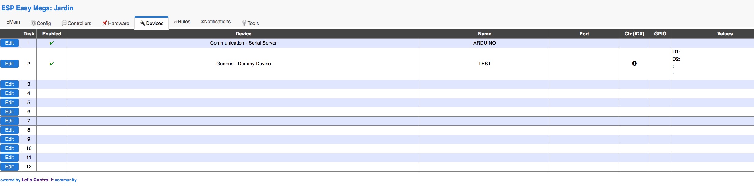

To image my words, here are some screenshots :

I have no experience in using the Serial Server plugin. But I have a recommendation. In your rule, change the TaskValueSet line to this:
TaskValueSet,2,1,[%eventvalue%]
FWIW, my testing shows that without the brackets the %eventvalue% will result in a zero assignment. Which is odd because there's a lot of ESPEasy examples that show it the way you used it. But it doesn't work for me unless the brackets wrap it.

;No working :-( . Always the same result.
With hook [] no data in the log :
Capture d’écran 2019-04-15 à 19.36.06.jpg (84.29 KiB) Viewed 13644 times
without hook :
Capture d’écran 2019-04-15 à 19.38.17.jpg (56.41 KiB) Viewed 13644 times
With parenthesis () :
Capture d’écran 2019-04-15 à 19.43.51.jpg (75.02 KiB) Viewed 13644 times
Any other idea ??? :-)
