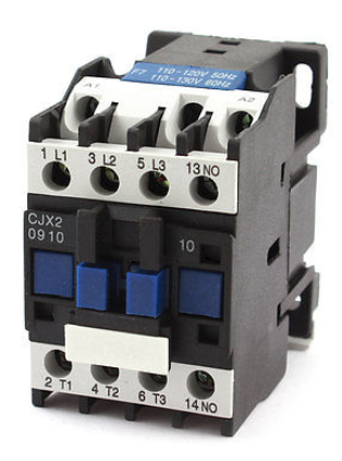

Please use a standard relay compatible with esp 8266
The contact of this relay can switch the coil current from the contactor
For contactor see this example coil 120 VAC In 12 A :
https://www.aliexpress.com/item/CJX2-12 ... st=ae803_5
Use a flightwheel diode on the coil of the contactor in order to filter spikes due to inductance of the coil.

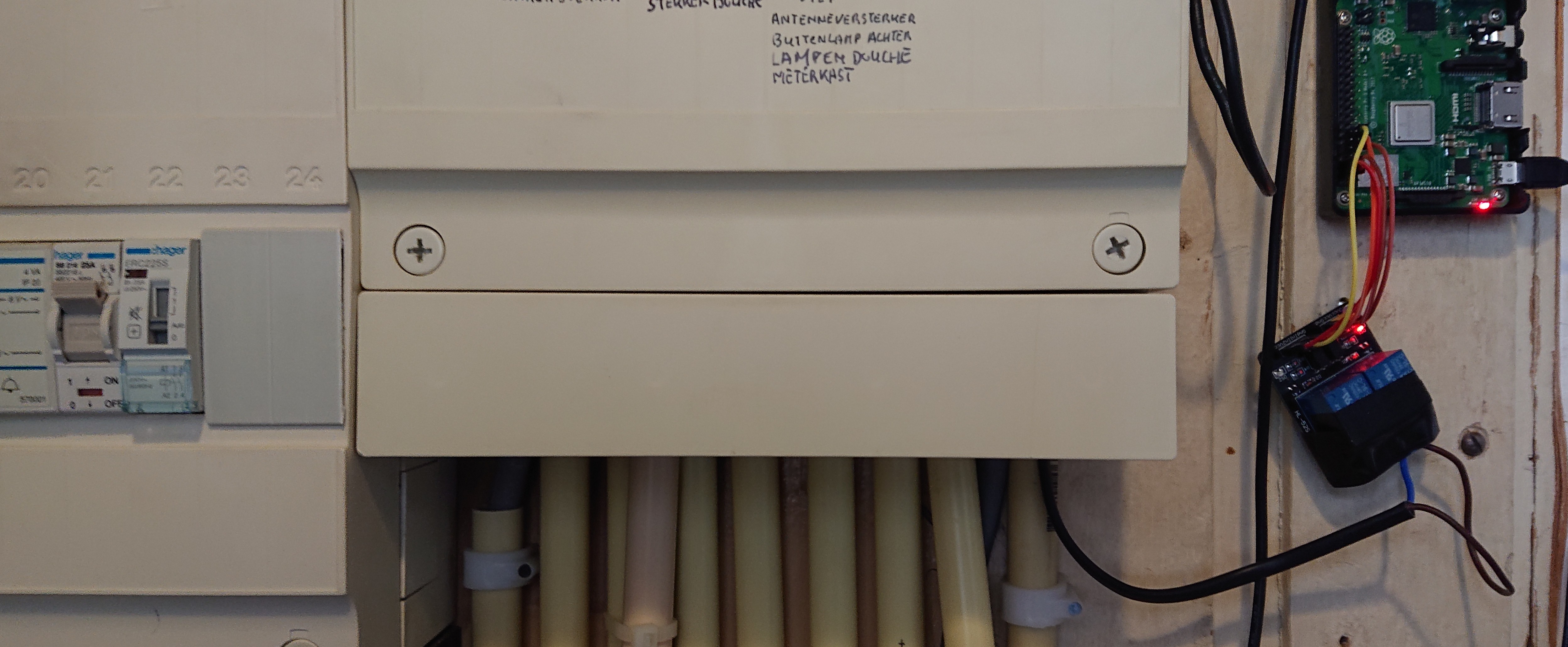

I support the suggestion added by @Patou
Use the cheap Chinese as intermediate. (use isolation tape to avoid burning your fingers in case you touch the relay)
The reliable Hager I have installed can be switched manual as well, which is very handy in cases I have experimented a step beyond the limits of what my RPI accepts.
The price of the Hager rail relay is not high.
