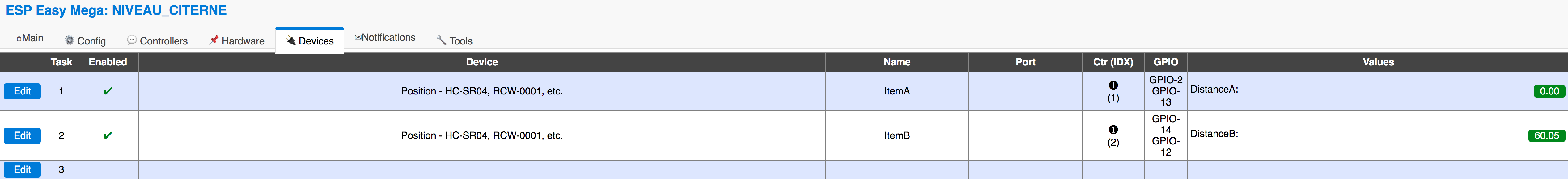

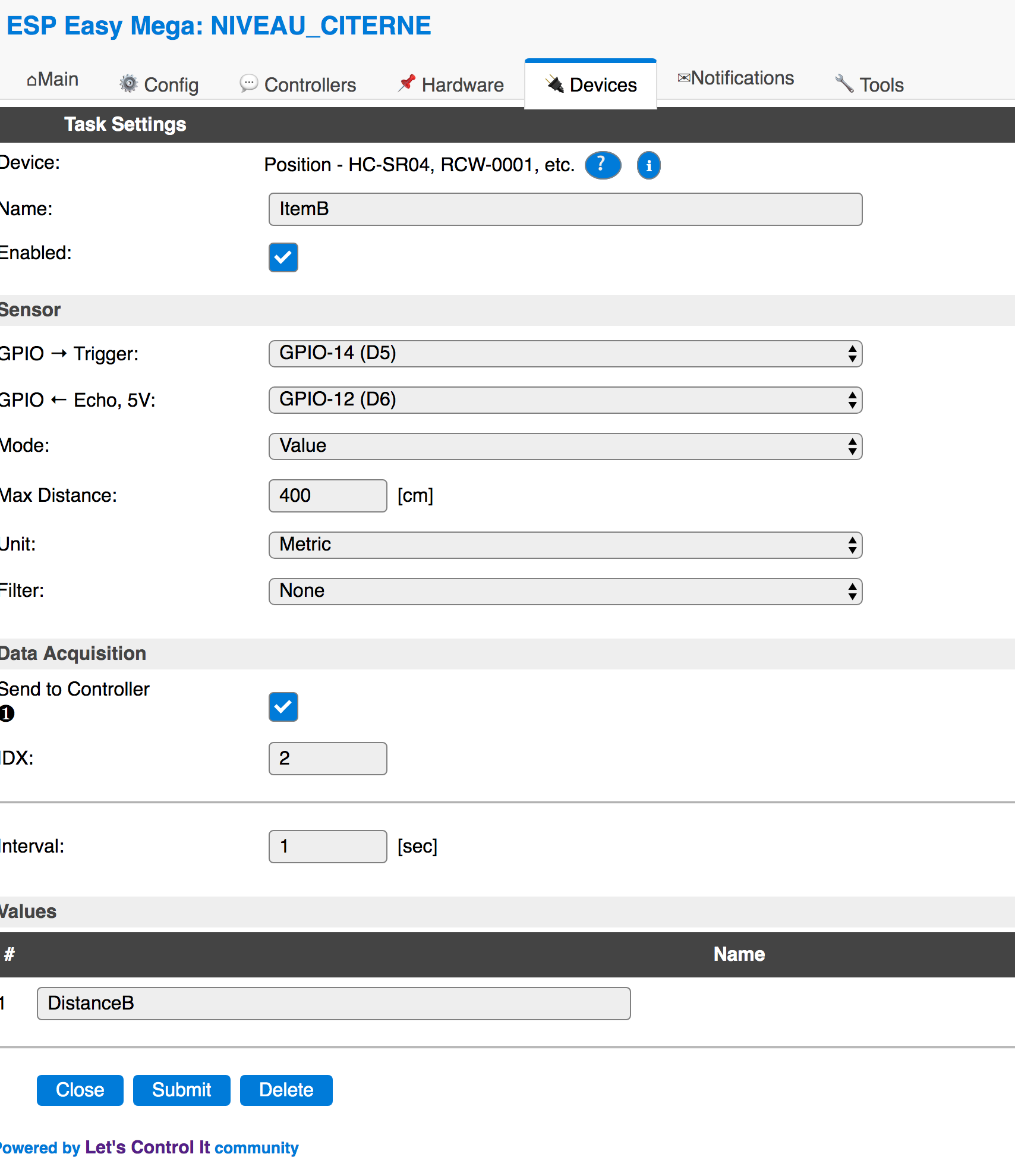

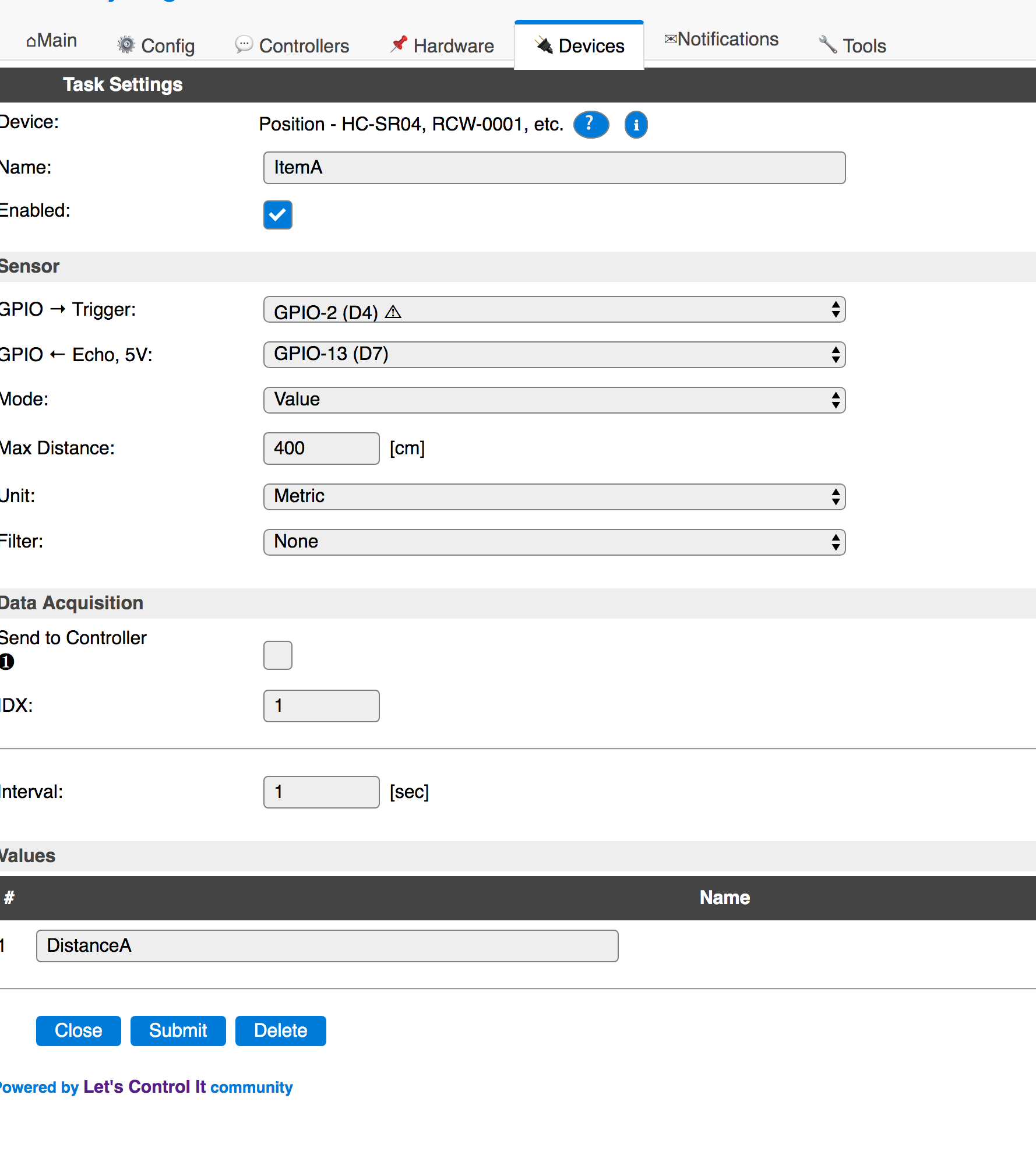

I'm trying to make working a demos with ESPEasy-mega (the latest)
I tried to install who HC-SR04, however, only one works at time
as you can see at the enclosed pictures, I tried other GPIO, same issue, one at time
any one can help please ?
thank you
the FIRST
Capture d’écran 2019-06-17 à 18.15.52.png (234.75 KiB) Viewed 21051 times
the SECOND
Capture d’écran 2019-06-17 à 18.16.13.png (244.7 KiB) Viewed 21051 times
THE RESULT:
Capture d’écran 2019-06-17 à 18.19.28.png (199.37 KiB) Viewed 21050 times

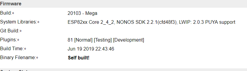

This is built on 2.6 SDK3 for a 4m version with ONLY switch, dallas, mcp, hcsr04, tsl2561, and dummy plugins.
Test that to make sure your setup is working. I use this firmware and know it to be working.
sator86
Posts: 7
Joined: 17 Jun 2019, 17:51
Re: wemos D1 R2 + two HC-SR04
#6 Post by sator86 » 22 Jun 2019, 01:07
hello,
I think I'm doing somethig wrong
I still have the same issue with your firmware
sometime one detector stay at 0, and sometimes the same freez at a different value like (high value) which not corresponding to a measure :roll:
