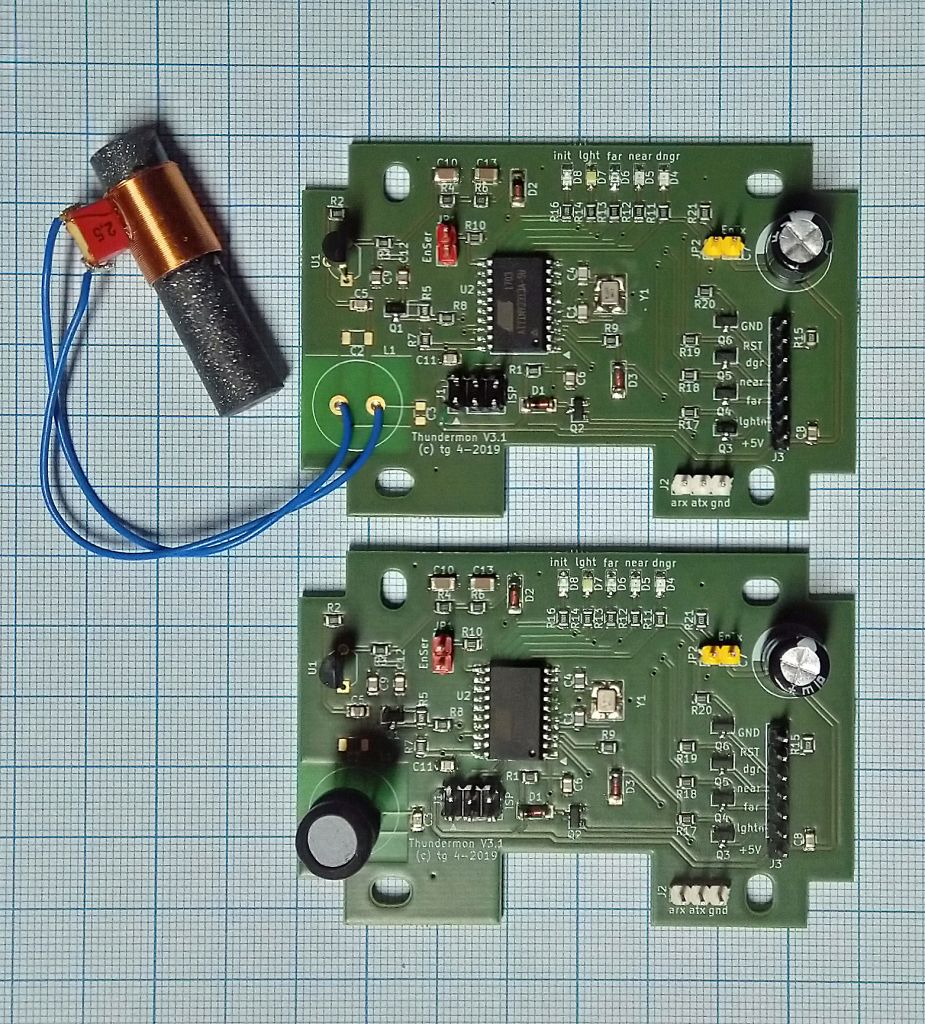

I've tested a not too big ferrite rod too I got accidentally from a surplus dealer here in Germany. (See photo).
Thundermon boards with small coil antenna and with a ferrite rod antenna
It works on lower frequency, 139 kHz compared to 400kHz with the small coil. This rod makes the detector too sensitive so adapting
the firmware is necessary.

Anyways, for home control this doesn't make sense. Tests with the ferite rod shown in the picture allowed to detect
a thunderstorm at over 100 km distance - together with high sensivity to false pulses from the environment around.
Do you really want your home control take action, closing blinds for example, if a thunderstorm is 100 km away?
Anyways, due to first tests the 9 x 12 mm ferrite coil gives reliable results for a range of 20..30 km around.
That's a good value for home control so the following text focuses to the small antenna coil.

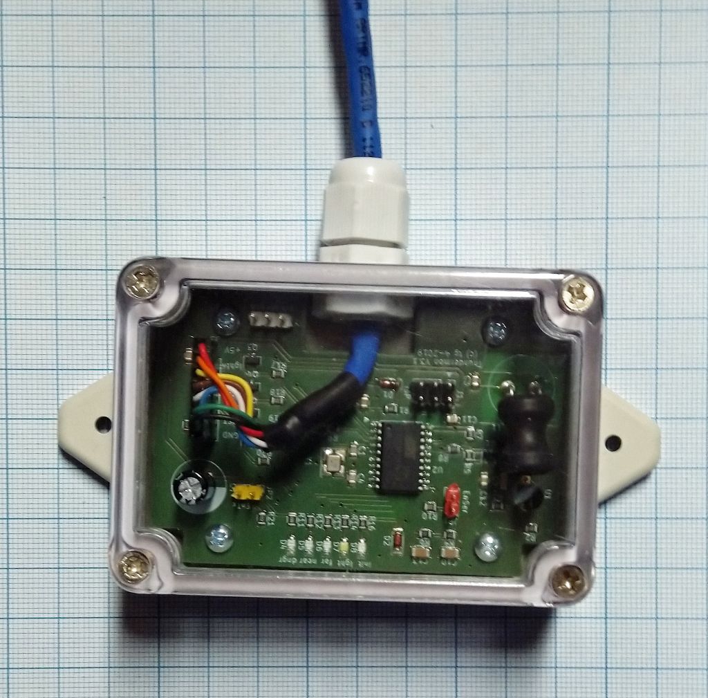

As you have to use a cable of 1.5 m or more to get the lightning detector away from the ESP I'd prefer external pullup resistors
of 4.7K..10K over using internal pullup.
I've used a 2m shielded ethernet cable for testing. Make sure the shield itself is connected to ground only on one side!
The device needs about 10 mA with LED on (6.5mA idle) so the thin wires do not result in any issues.
The "Lightning" signal is optional. I'm using it for a small led in another box and for a (honestly quite useless) counter on the ESP.
