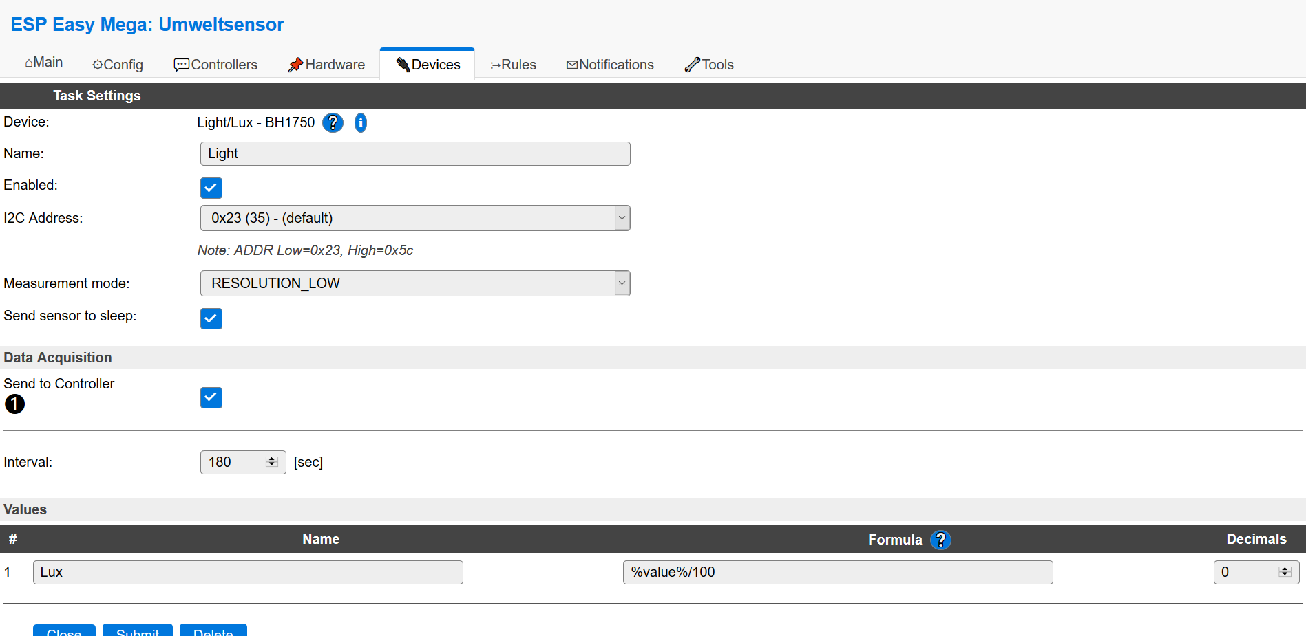

You are right. I just followed the 'working examples' out of https://espeasy.readthedocs.io/en/lates ... Rules.html. I changed the rule according to your suggestion, but still I get not the result of the average calculation to be published. No probs with calculation and MQTT. Screenshot of Device page is attatched. Thanks for any help.
On Light#Lux Do
 Let,4,[VAR#3]
 Let,3,[VAR#2]
 Let,2,[VAR#1]
 Let,1,[Light#Lux]
 TaskValueSet,1,1,([VAR#1]+[VAR#2]+[VAR#3])/3
 Let,5,[Dummy#Value]
 publish,any/state/Umweltsensor,[Dummy#Value]
 if [Let,5]>300 do
 publish,any/state/Umweltsensor/Beschattung,1
 publish,any/state/Umweltsensor/Beschattung,0
EndOn
244812212: ACT : Let,3,3.00
244812219: Command: let
244812226: ACT : Let,2,1.00
244812234: Command: let
244812257: ACT : Let,1,0
244812265: Command: let
244812272: ACT : TaskValueSet,1,1,(0.00+1.00+3.00)/3
244812282: Command: taskvalueset
244812318: ACT : Let,5,
244812327: Command: let
244812361: ACT : publish,any/state/Umweltsensor,
244812369: Command: publish
244812382: ACT : publish,any/state/Umweltsensor/Beschattung,0
244812391: Command: publish
Screenshot_2019-09-06 Umweltsensor.png (67.93 KiB) Viewed 8060 times

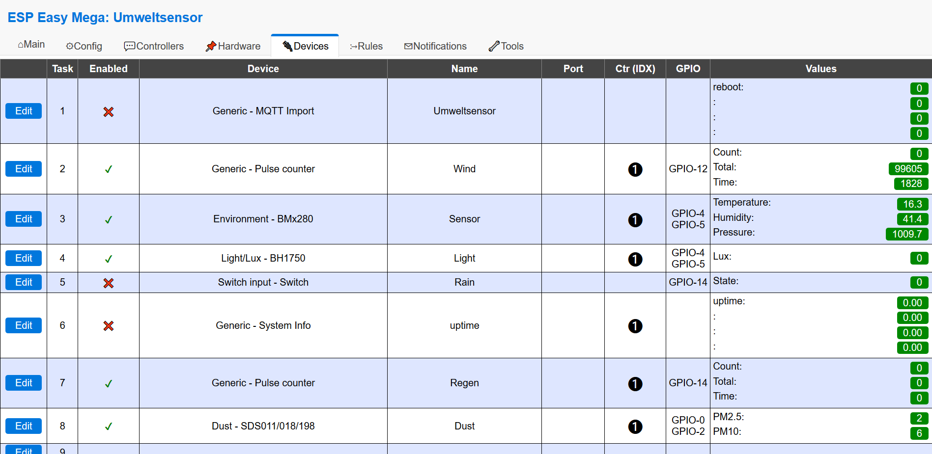

Posts: 1372
Re: Need help in publishing a Dummy value
#4 Post by ThomasB » 06 Sep 2019, 21:34
Please post a screenshot of the Devices page.
Also, your publish address is suspicious. Is your MQTT broker configured with a subscription that begins with "any/state/"? That seems to be the text from a random MQTT example rather than for your installation.

#5 Post by werner_g » 06 Sep 2019, 22:15
just
is being published. "any/state/xxx" is my standard for MQTT-messages in my network.
werner_g
Posts: 31
Joined: 11 Jun 2017, 14:19
#6 Post by werner_g » 06 Sep 2019, 22:35
forgot the screenshot
Screenshot_2019-09-06 Umweltsensor(1).png (119.5 KiB) Viewed 8046 times
Posts: 1372
#7 Post by ThomasB » 07 Sep 2019, 00:12
publish,any/state/Umweltsensor/Beschattung,0 is being published. "any/state/xxx" is my standard for MQTT-messages in my network.
That is helpful information; Confirms MQTT is configured OK.
See your rule statement at this line:
The [Dummy#Value] is suspect here. I expected to see the Generic Dummy plugin, or some device named Dummy in your device list, but none have that name. That seems to explain the missing MQTT.
This seems to be an attempt to write the Average result to the reboot var, which isn't allowed. Taskvalueset is for writing a value to a Dummy device, which requires the Generic Dummy Device plugin.
So here's what I suggest. Add the Dummy Device Plugin to task position #9 (which is currently empty/available). Name the device Dummy, with the Value #1 named Value.
Change the TaskValueSet code to:
TaskValueSet,9,1,([VAR#1]+[VAR#2]+[VAR#3])/3
No other edits needed at this point. Try it, and if still not working then check the system log for debugging details.
werner_g
Posts: 31
#8 Post by werner_g » 07 Sep 2019, 13:10
Hi Thomas, I wasn't aware of the usage of a dummy device. Now I understand - now it works! And again I learnt a little bit more. Thanks for your help & patience!
