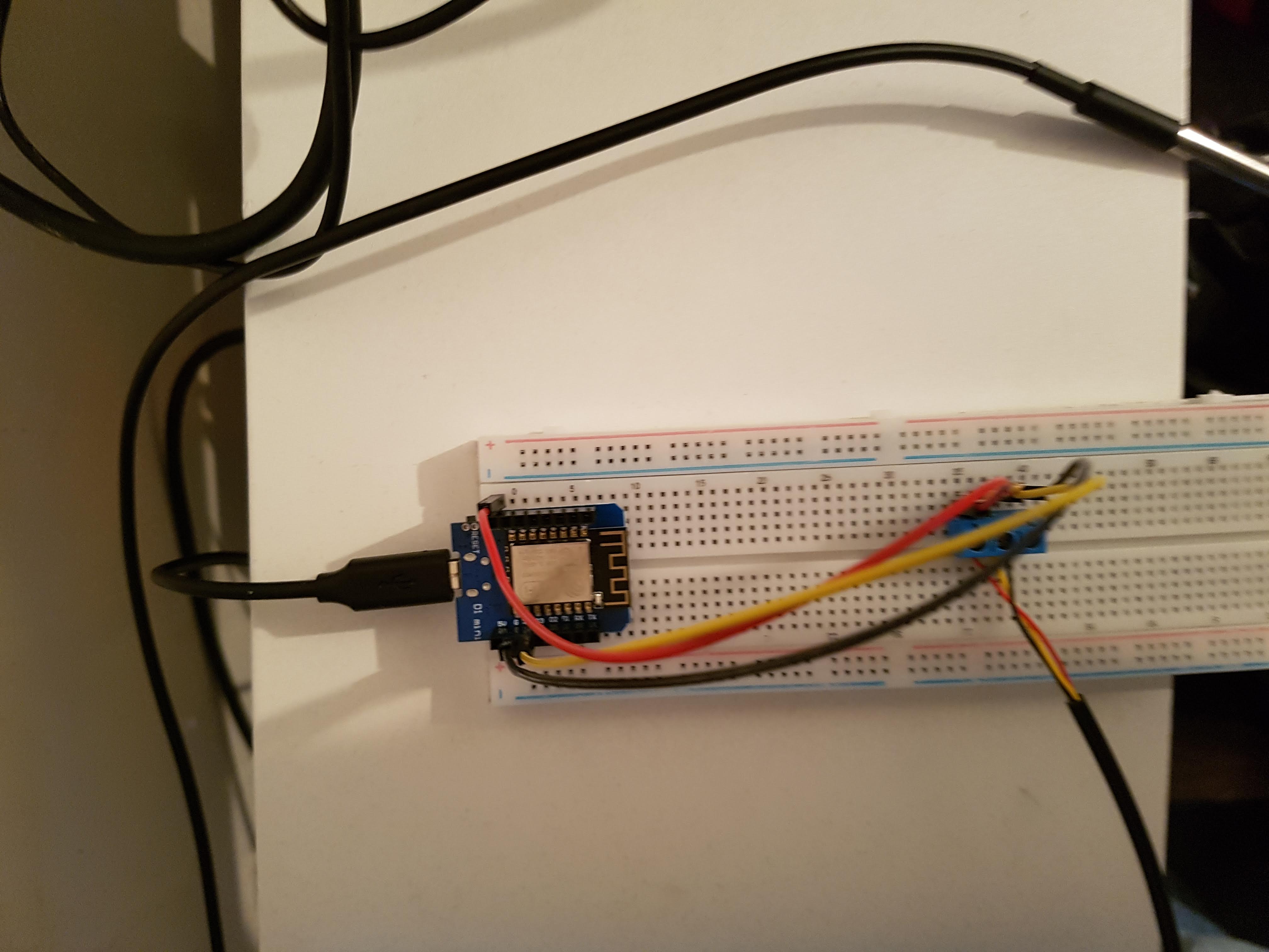

J'ai réalisé à l'aide d'une breadboard, une résistance 4,7k, quelques fils Dupont,mon module D1 mini et une sonde étanche DS18B20 un montage que l'on trouve beaucoup sur internet.

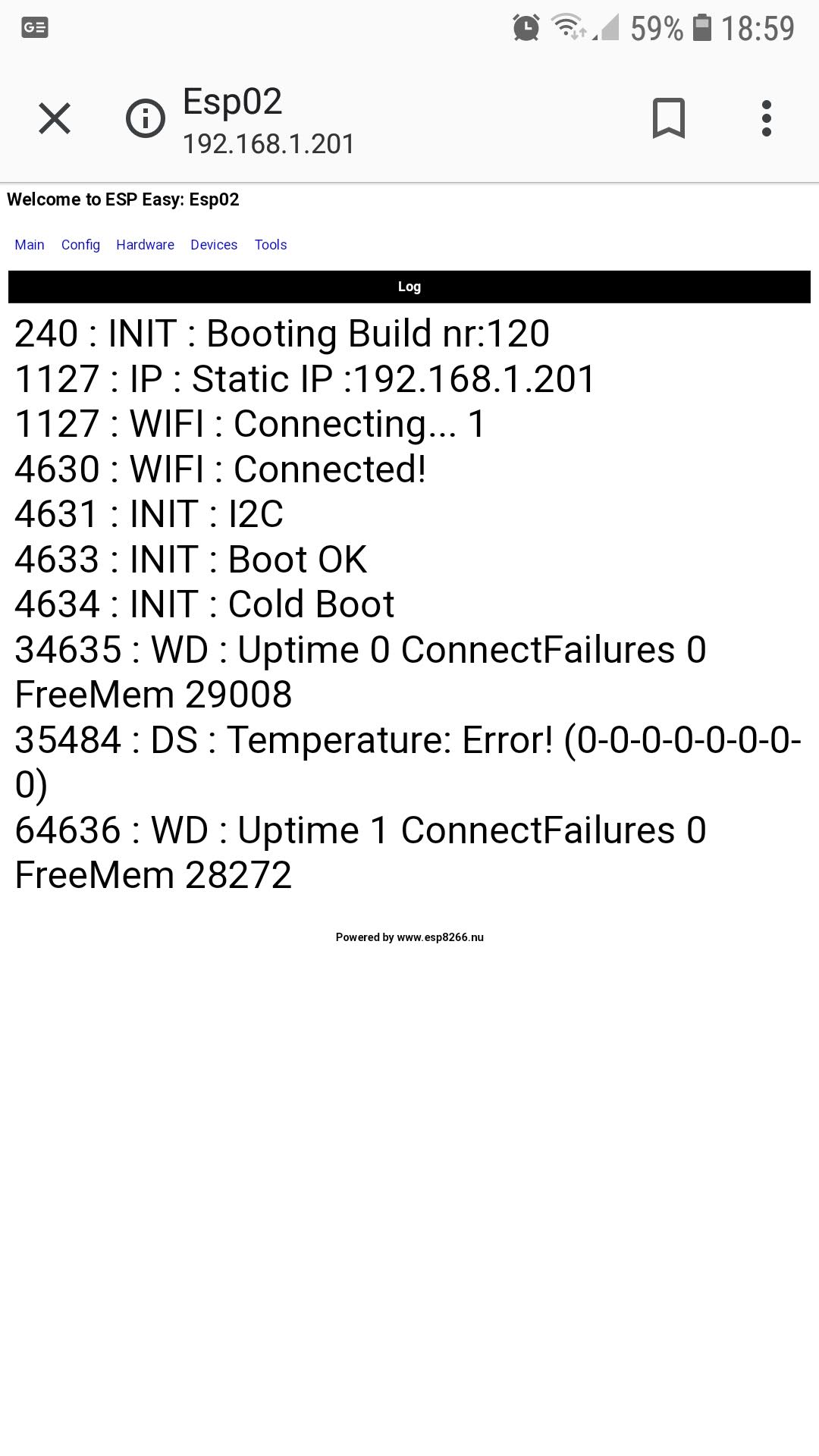

Etape 5 - Visu des logs --> erreur DS : Temperature: Error! (0-0-0-0-0-0-0-0)

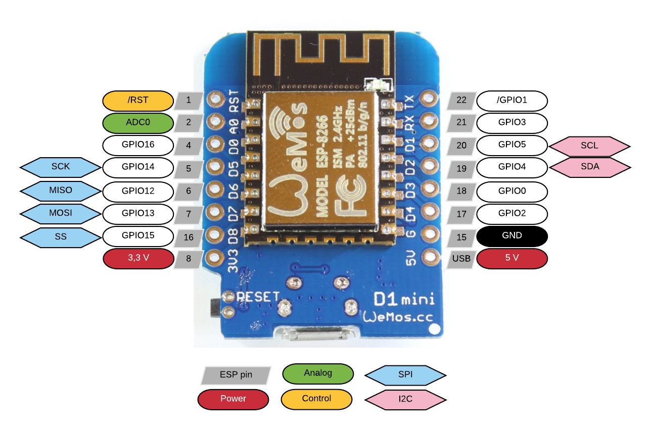

Merci beaucoup pour votre aide, ci joint la photo du montage, le croquis du d1-mini et les capture d'écran des différents onglets ESPEASY. N’hésitez pas à me contacter si il vous manque des infos

D4=GPIO2 is a more complicated port, used at boot (has internal Pull-Up)
Try to start with simple ports that should work:
D5=GPIO14
or
D6=GPIO12
or
D7=GPIO13

Is the yellow wire connected correctly?

You haven't chosen any device on the 1Wire bus atm, so you get "No Result from 00-00-00-00...."

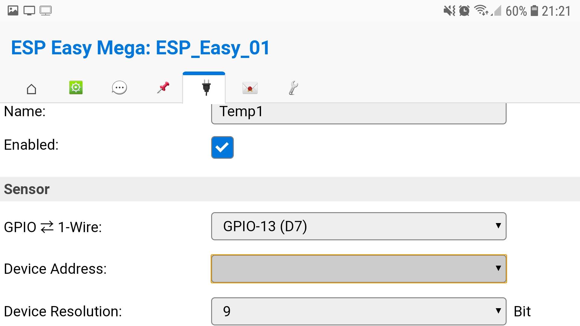

1 - Change the GPIO-2 to GPIO-13(D7) --> always same pb @Shardan and @Domosapiens, i select the GPIO-13, submit and reboot my d1-mini but no result ... always blank in Device Nr (Old and New firmware)

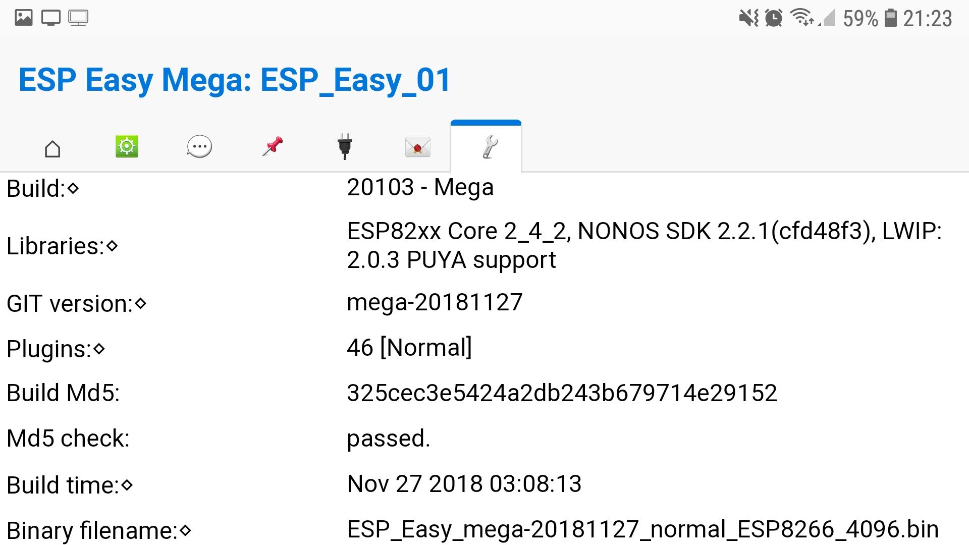

4 - Change Firmware to last one : mega 2018-1127 found on github , do the configuration in new interface --> always the same pb except that in log i don't have record with temperature error @Grovkillen
I read somehere that device resoltuion for DS18B20 is 12 Bit but i couldn't change 9 Bit, I change to 12 Bit and submit but when i return it'a always 9 bit, is it normally ?
Perhaps it's harware pb ? azdelivery d1 mini ? Waterproof ds18b20 (i used 2 different yesterday for the same result) ?

First thing ! suggest:
Do not trust breadboards! Do not trust the jumper cables!
I'm working with breadboards for long time now - they are indeed usefull but they cause alot of problems.
The cheap jumper cables tend to have no contact, another reason for many problems.
Use a multimeter and check if everything has connection!
Check from the WeMos-Pin to the screw terminal if all wiring has real connection.
If all parts are OK, it is very likely that some connection is missing.

Hello every body, just one word to tell you that i found the pb ... it's the bread board, I test all one by one and the same config, the same mounting without breadboard and all is ok... now i can go to step 2 : send to my automation software : Jeedom
